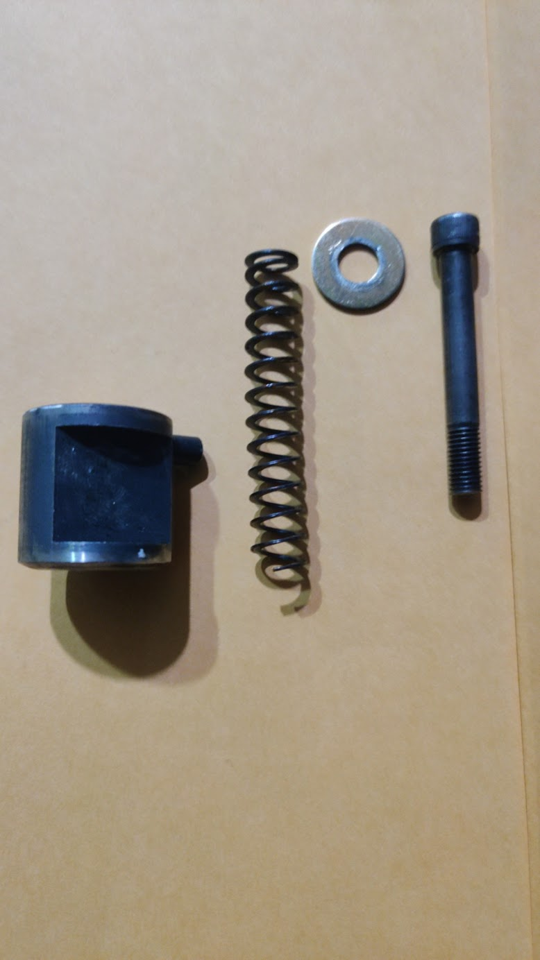

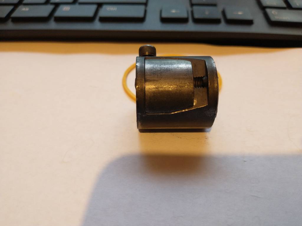

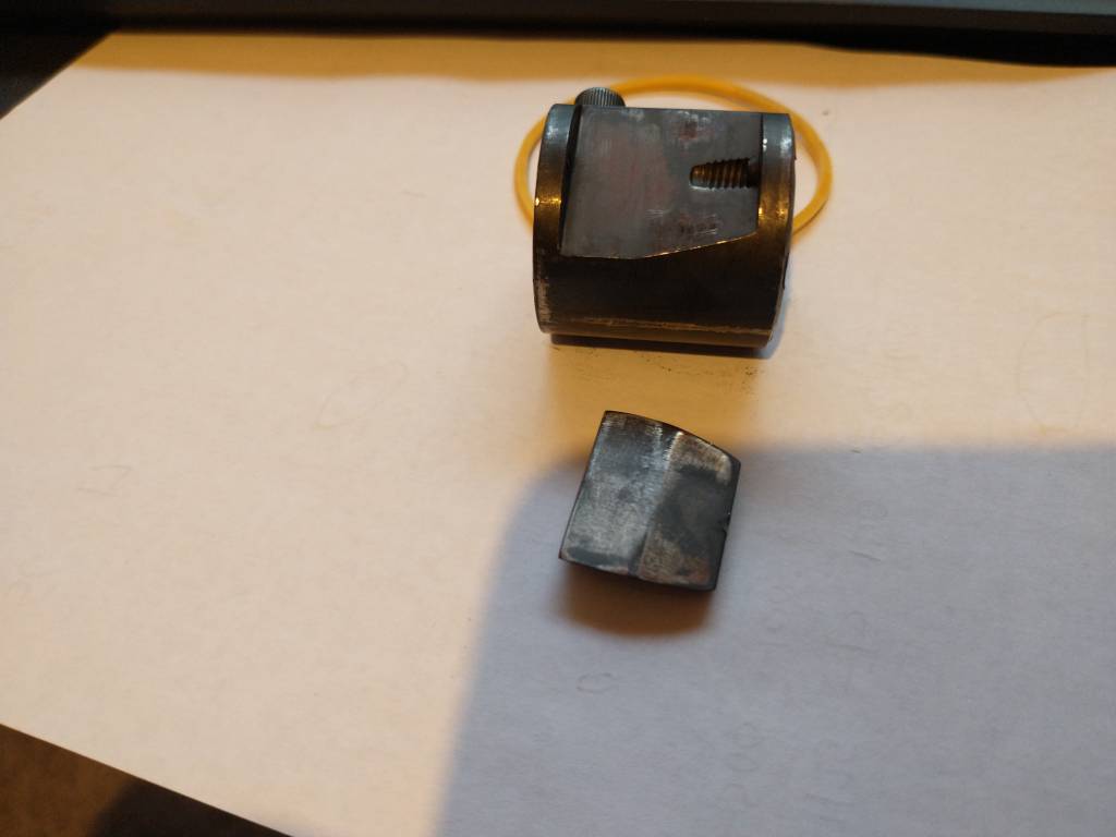

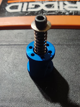

are you using any debouncing device ssg etc ?
I have one, a WAR one with the sliding magnet on the side it works ad a brake when the hammer boxes to the rear.
No longer made I take it. Right now I am using a short spring and lightened hammer. The hammer is in free flight when it strikes. I'm just guessing but with the current efficiency I'm not wasting air
