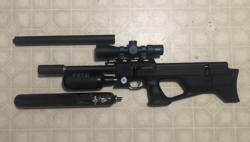

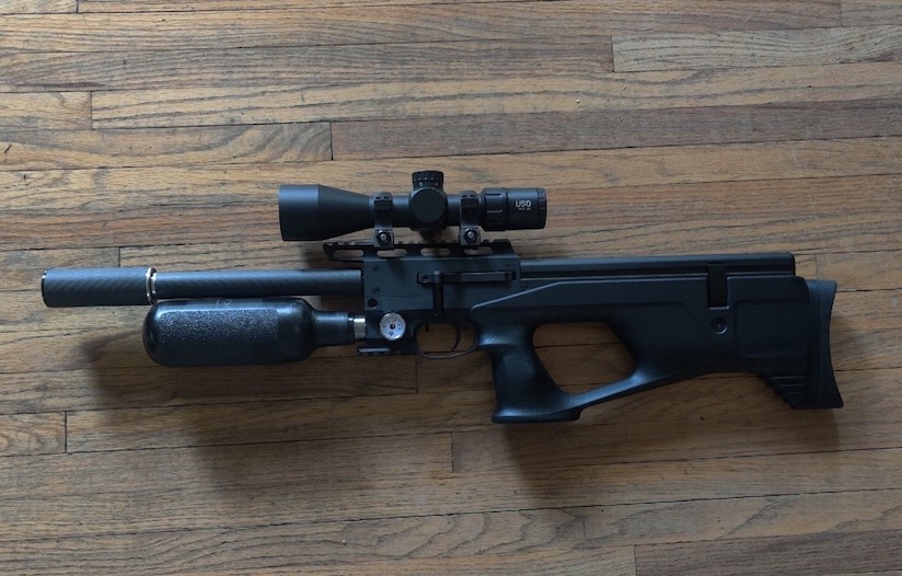

Being a fan of bullpups, I had this recently acquired Uragan 30 shortened and modified by Bullysyclone. He installed a FX Mk3 300cc bottle, shortened the barrel, carbon fiber shroud, and installed his Wylie kanz. He custom made the bottle adaptor and shroud end cap out of titanium. The barrel was shortened approximately 1.5 inches to directly install the end-cap to the barrel so the kan clears the FX bottle.
It shoots 44.8g FX domes nice, straight , and hard at 850 fps and quite quiet at 775 fps. Further testing needs to be done to see how it groups at distance.
The first photo shows the original bottle and shroud compared to the installed parts. The factory shroud is 14.5 inches. The overall length is 24.5 inches.
