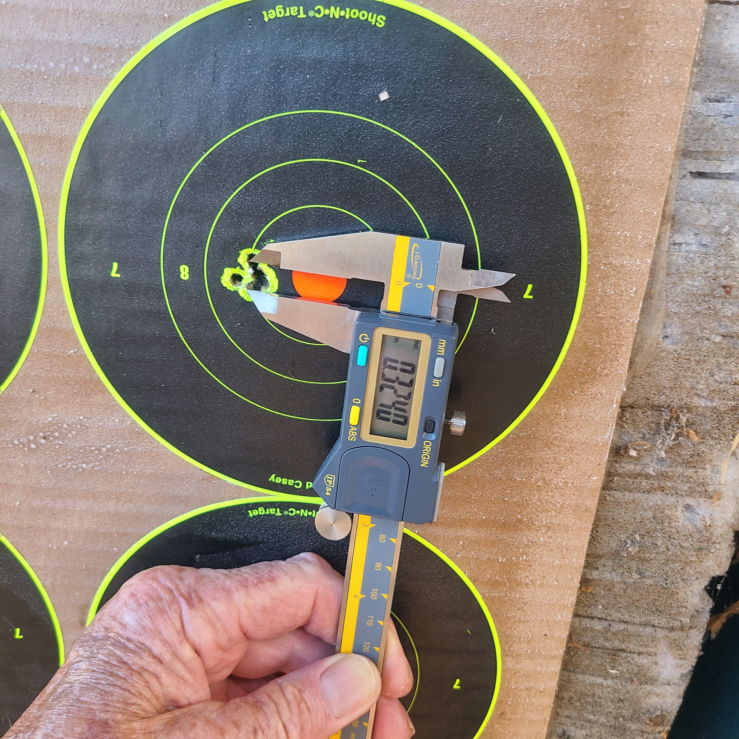

Reg, 155, tf H, pw 23. 29 gr slugs 953 fps. 6 shots. 57 yards.

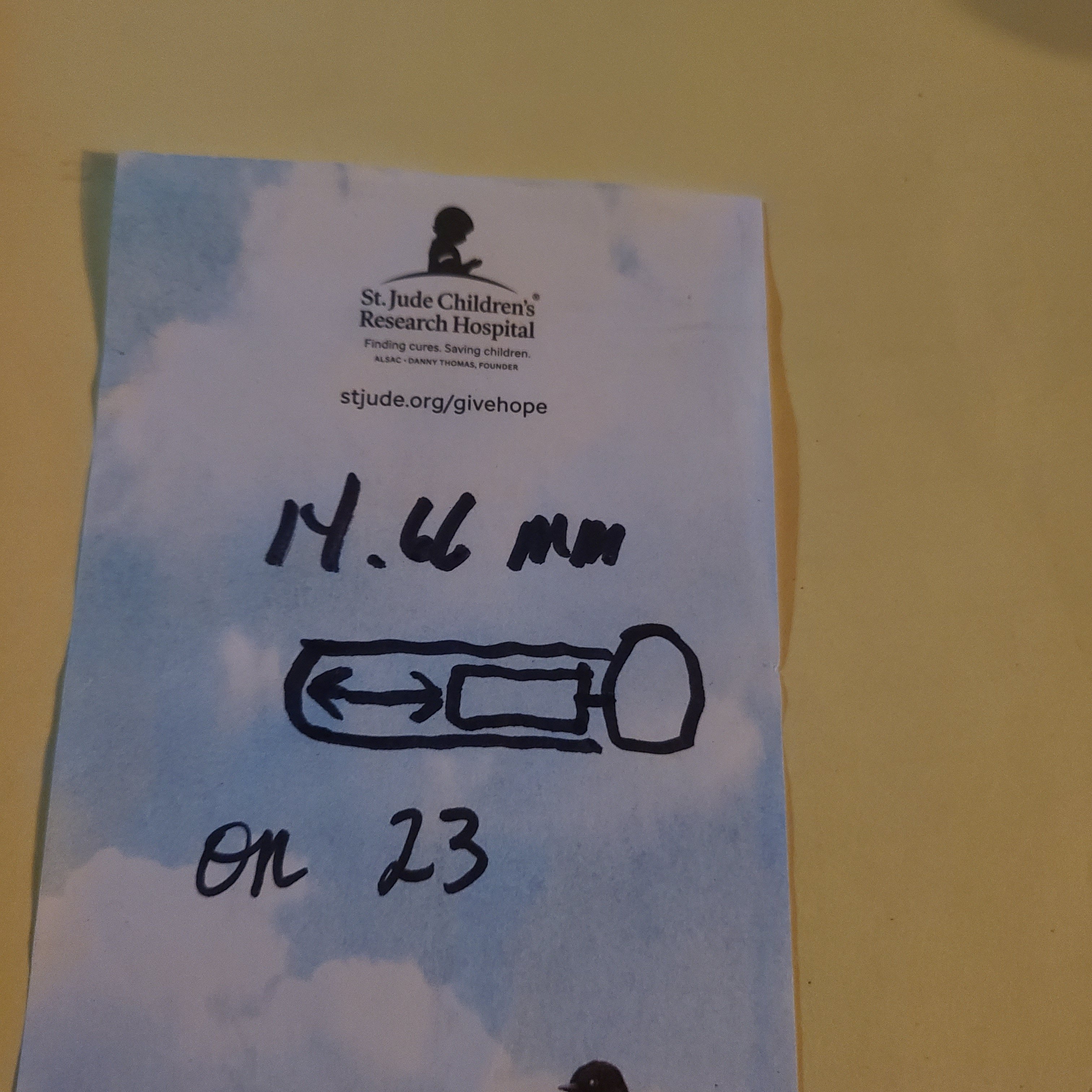

I found for me, going to 23 then adjusting preload so there's no movement up to 24 then backing off a tiny bit. Then go to 21 on the pw and start increasing reg pressure till i get close to the velocity I'm looking for with the heaviest projectile i want to use. I then shoot for groups.

set the power wheel on max which is 23 on my mk2 then take the power wheel and safety off and remove the stock. Put the power wheel back on and adjust the preload so its almost bottomed out. You dont want to bind the power wheel at max so just enough room to hit max on the wheel and not be jamming the wheel binding it. You should be able to run up to 150 bar. Mine is currently set at 145 and with a 600 mm barrel I am getting 865 fps with .25 cal 25 gr. JSB with the power wheel on 8.

953 with a 29 gr . slug. Will do unless I fool with the reg pressure again. 44 shots per fill, and carry extra 480 air vessel. 88 shots while hunting should make for a good day. If I need more, I have my larger vessels to fill from.
Those 29gr. Neilson slugs gives me sub moa accuracy when I do my part.
