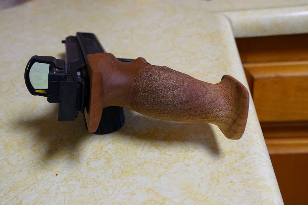

I've had my 6004FAS for a while, and shot it as is. Hand all squeezed up, fingers on top of each other and all.
Well, I got tired of having my hand with my fingers overlapping to shoot the gun, with the "target" wood grip that comes on it.
So...I wrapped the gun in a towel, sealed with duct tape and went out o my cylinder head porting tools. Put the 3/4" carbide cutter in the hand tool and started cutting. Cutting, fitting, cutting, fitting, and so on. I finally got the grip to feel good in my hand. What...a difference in shooting. The stippling seemed like maybe I could replicate it in the new surfaces. I got out my carbide tipped electric pencil and tried to match the factory surface. After a coupla false tries, I figured out that I could actually match the factory surface fairly well. Big...difference, should have done this a long time ago.
