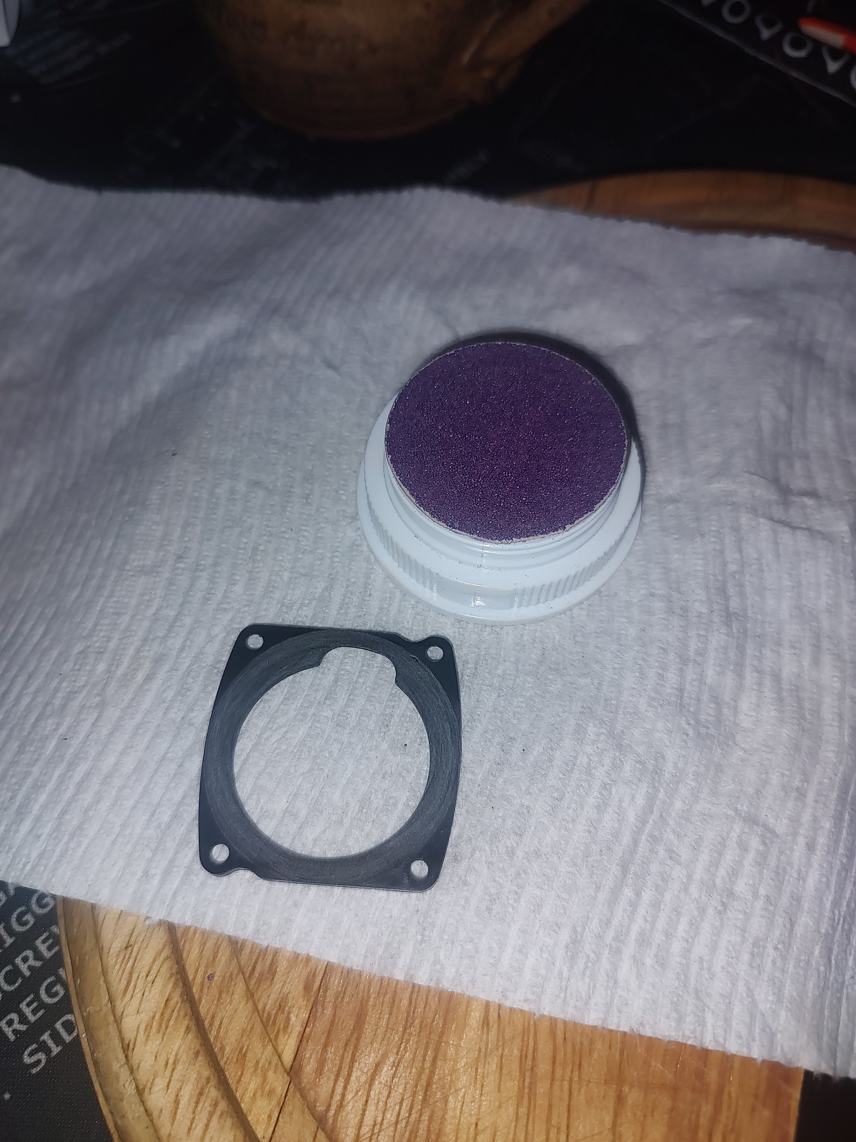

Having looked everywhere for aftermarket plates that would allow Uragan 2 mags to accept 49gr Altaros slugs, I couldn't find any.
So it came down to slow and painful sanding by hand. I needed to recess the center of the mag plate to make it thinner. If anyone is curious, the top from a prescription pill bottle seems to be the ideal size for that. Glued a piece of sandpaper to it, and literally ground out the mag plate.
The mag rotates freely, going to take it for a spin later.

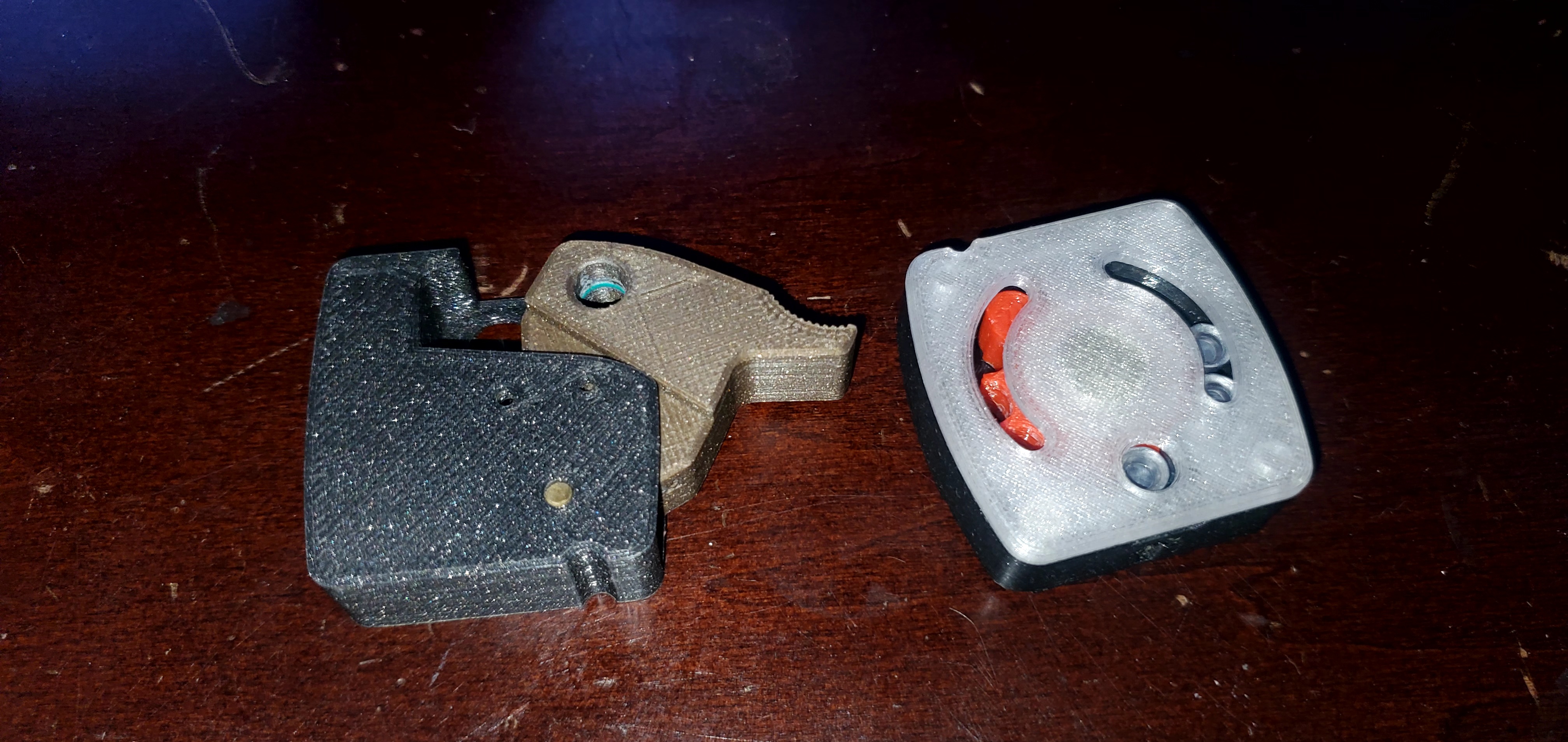

Omg! What a pain. Go pm elis he made me some years ago for .22 cal. Of course I never got a larger uragan other than my compact. He even has a single loader. If it is possible to make room for a 49 grain Altaros he can.
Sorry for the crappy pictures. But this one currently has the JSB Diabolo Exact Jumbo Beast .22 Cal in there and is above the level of the mag. The cover comes off for easy loading too. I dunno if back then if the Altaros 40 grain kings would fit.
I think someone shaved the stock units and put shims in them to space the top plate in the past.
