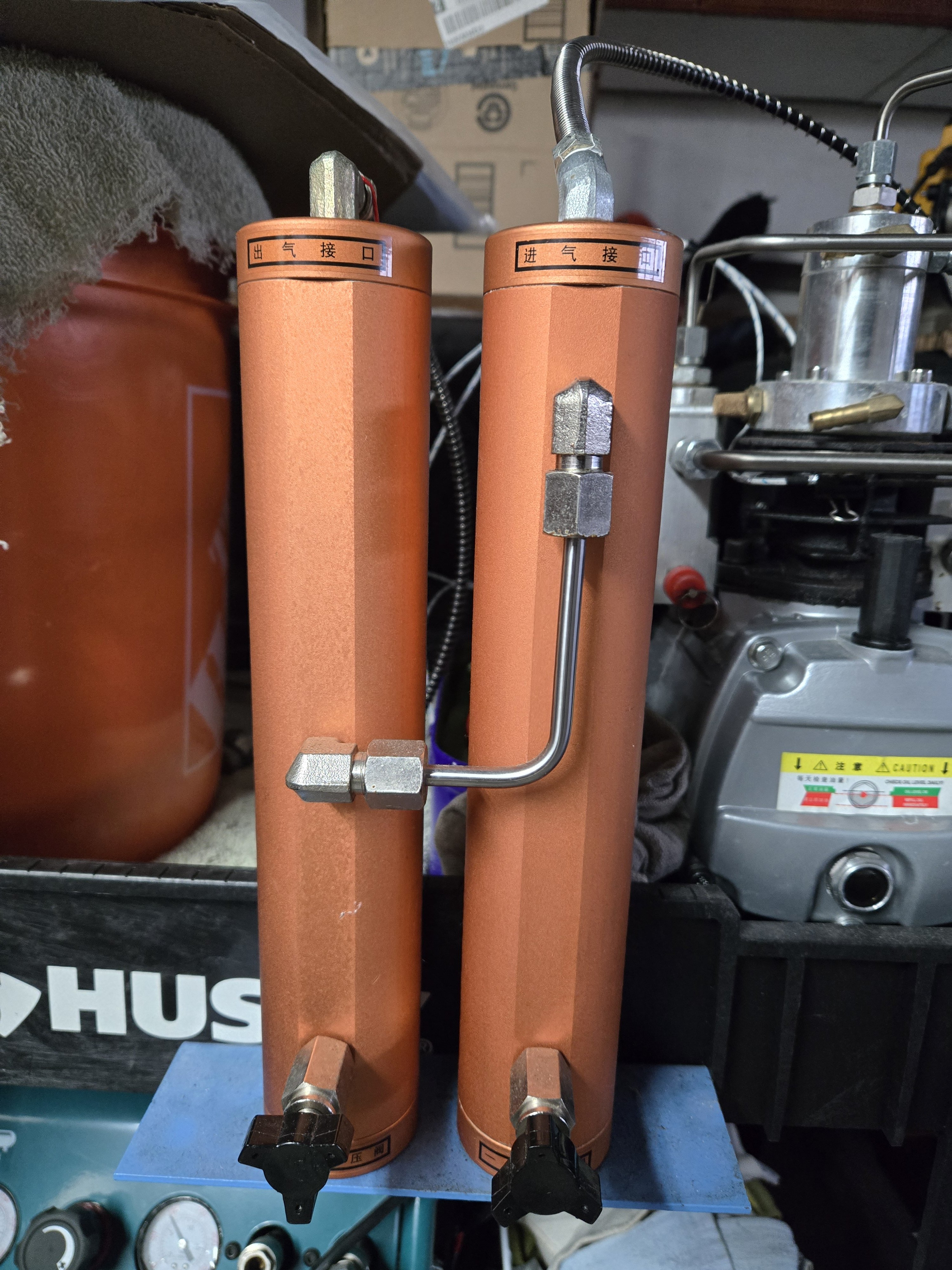

This what I have. I was searching for it recently for a friend and not seeing it currently at aliexpress.
The right side tower is the mechanical filter, the left side is the media filter.
In the very first days I tried to open the tubes just to see what is inside.
The right side - mechanical is factory sealed, I could not even start to loosen it and I left it as is not to break it.
I could successfully open the left side tower, and there is the active carbon filter inside. I did not replace mine yet in all these years. I bought a bag of desiccant just to make sure, but still in original bag sitting in the closet for years.

The "first stage" works very well, I have not seen many times only a few drips coming out from second stage. My place (in Toronto) is humid winter-summer. Right now -12C and 85%, with 4KW electric (construction) heater running in my garage during days is 45%.
Thanks for the explanation. I had tried to look up something like this and the only thing I could find had a cotton filter first stage ahead of the media filter. I like the idea of the mechanical filter better. The second stage probably isn't needed, but I'm paranoid and would rather have it there just in case (as it's now at 56F/13C with 99% humidity in my area). Probably going to rig it up how your unit is with two separate filters and call it done.
