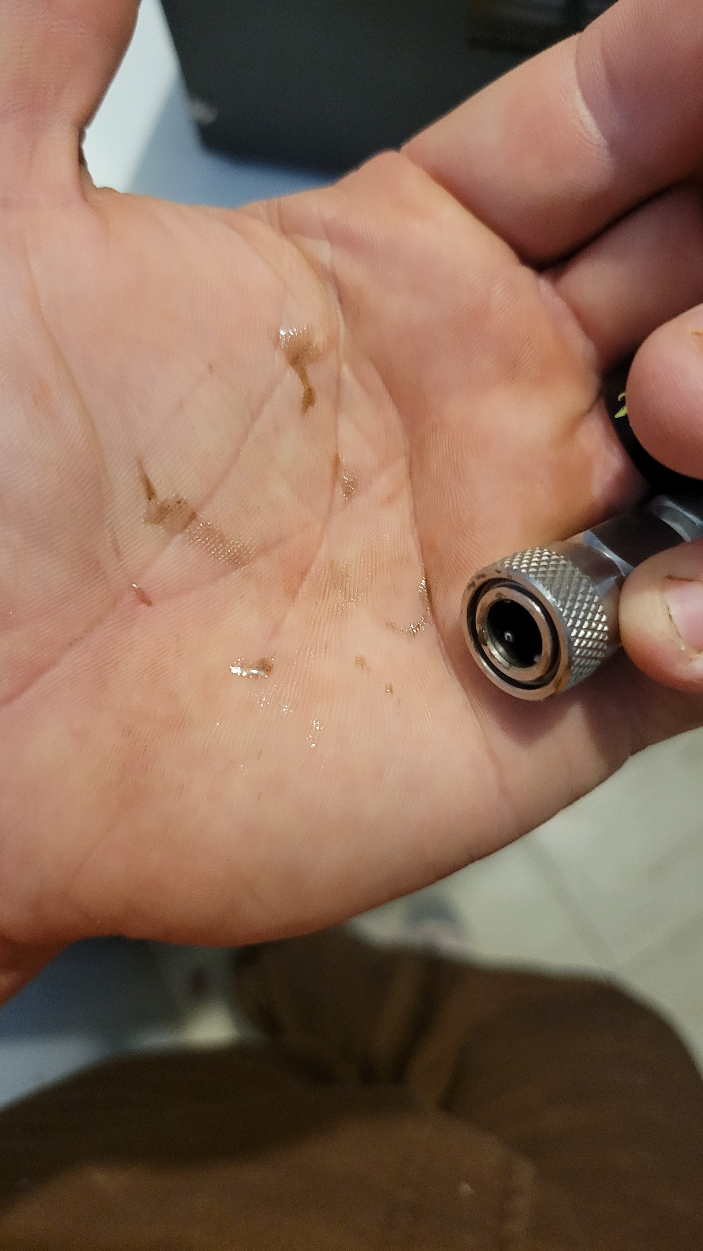

I have a cheaper compressor from Amazon and I know moisture in pcps is bad. While filling my Artimis M11 today I noticed a few drops from the compressor side of the hose, none from the gun side where the filter is. Am I still safe or do I need to look into adding another filter somewhere
Sam,
Lots of styles and brands of Amazon "cheaper" compressors out there, most only provide a cotton-filled filter, not addressing moisture naturally occurring from compressing air, in any other way. Better than nothing, but not by much. Recommend searching, "Yong Heng," in archives, additional filter discussions are there. Best of Luck, WM
I put up a pretty complete description of different types of filters by category. Hopefully it will help you understand better. there is lots of other good info in the rest of the thread.
