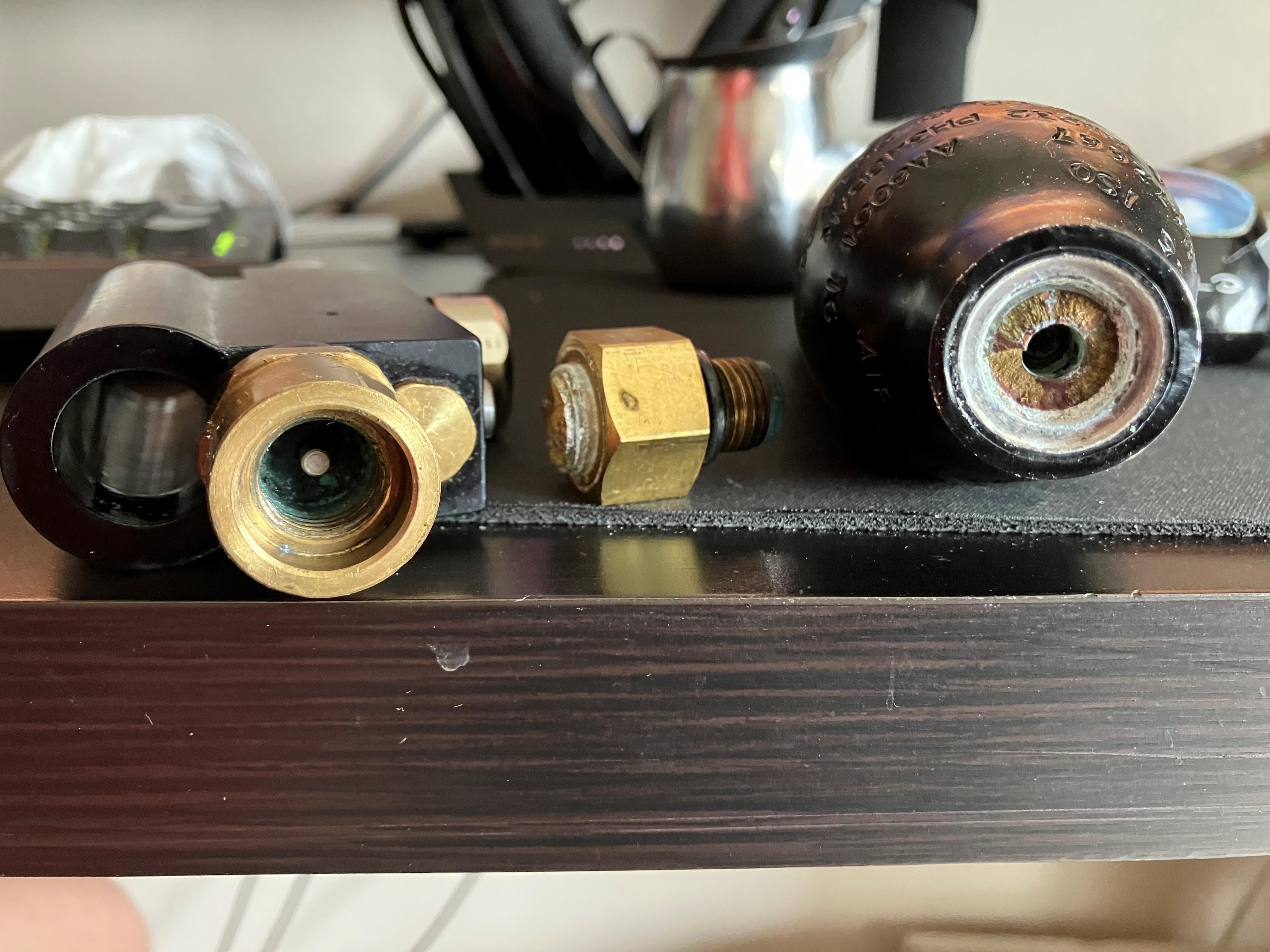

You can read about users that strictly hand pump with no drying or filtering that have not experienced any issues. I didn’t feel like taking that chance. To be honest, I don’t care what anybody puts in their gun, I put dry air in mine and hopefully any problems I might see aren’t air quality related.
Dana@Mountain Air Sports recently beat the snot out of three decent quality airguns, it would be nice if he could do some testing with and without air drying tests on two identical guns to see the effect of dried air vs non-dried air. But then it also depends on your locale as to what relative humidity is at time of the testing. Way too many variables as far as I’m concerned.
So it’s like my wife, a retired RN, tells people that call her with medical issues. She tells them, “ if you’re concerned enough to ask me, talk to your doctor”. She’ll tell them what she knows, but beyond that, talk to your doctor.
Same here, if you’re worried about wet air, dry it! My PCP’s are expensive. I don’t mind working on them when necessary because of normal parts wear or finite component life, but having to work on them because of something I caused or could have prevented, that’s just dumb.
