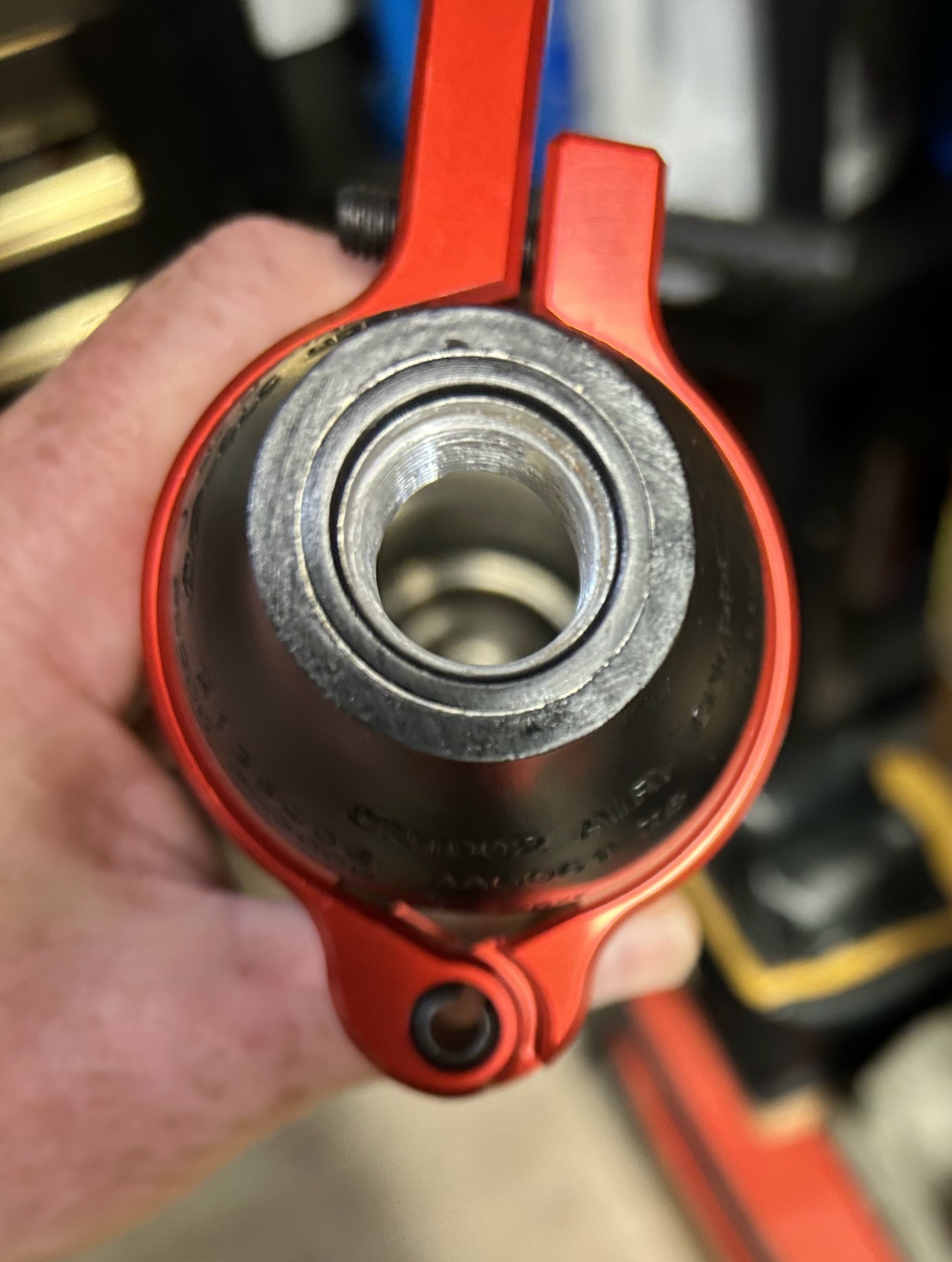

I have now opened the aluminum bottle and found it to be pristine, not a single trace of moisture, pics below. I'm currently in the process of opening all my guns, that aren't new to make sure there's no problems lurking in the depths.

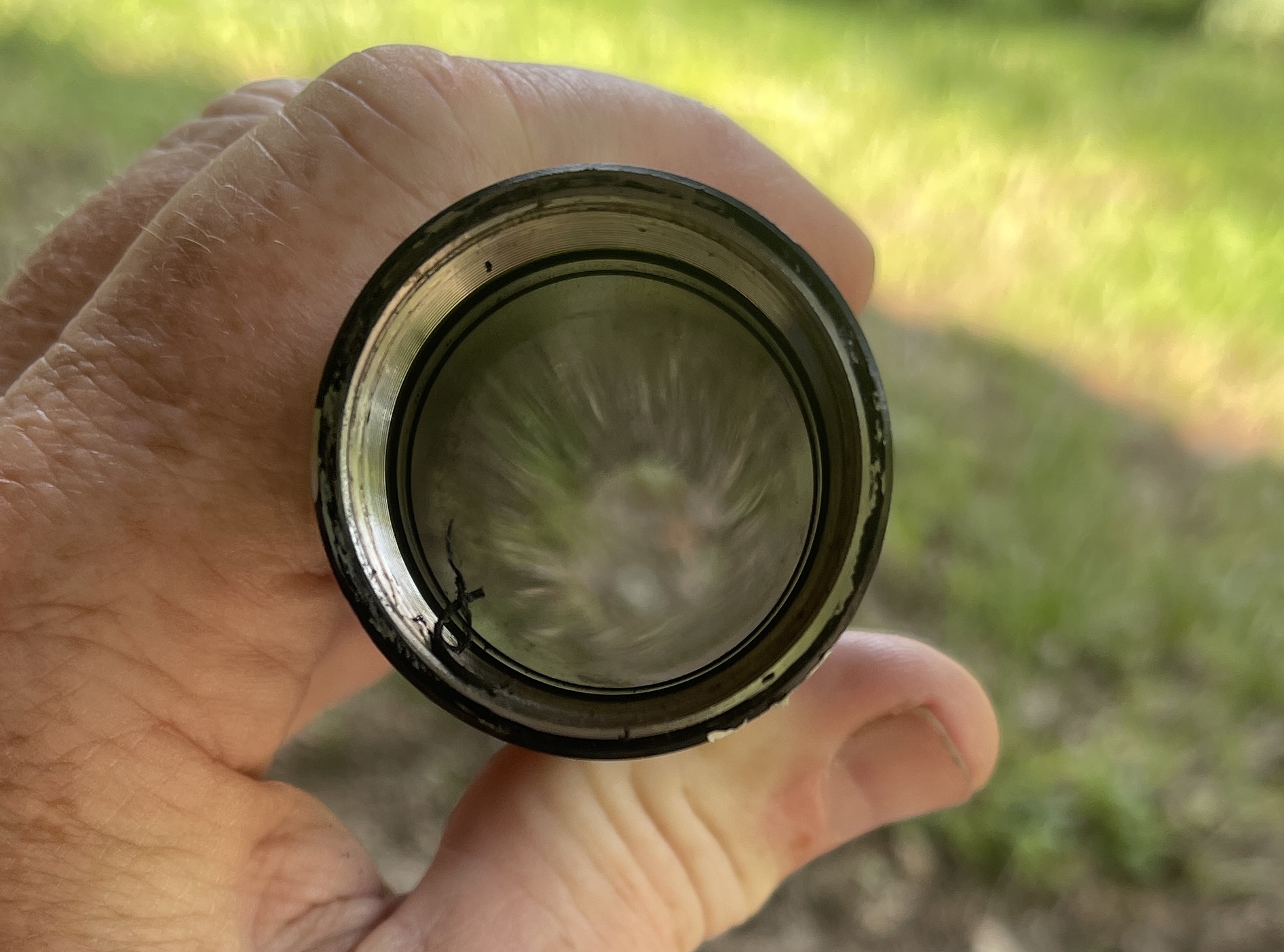

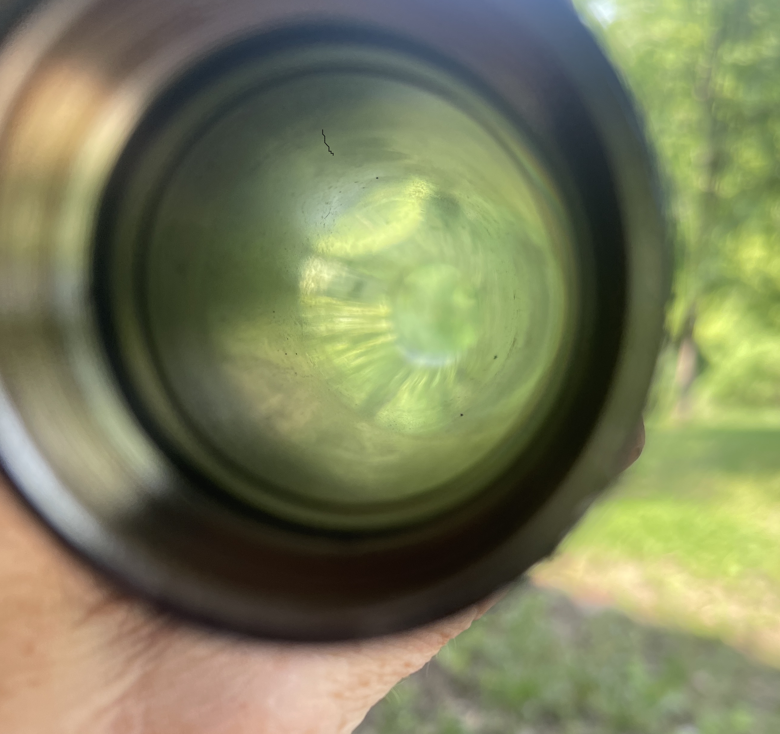

Here are some pics of my two HW cylinders and my aluminum FX bottle after opening.
Well, while I'm not an expert by far, I would guess that since there's no corrosion or deposits, that there is no problem with moisture. I mean, I would think there would be some evidence of it visible.

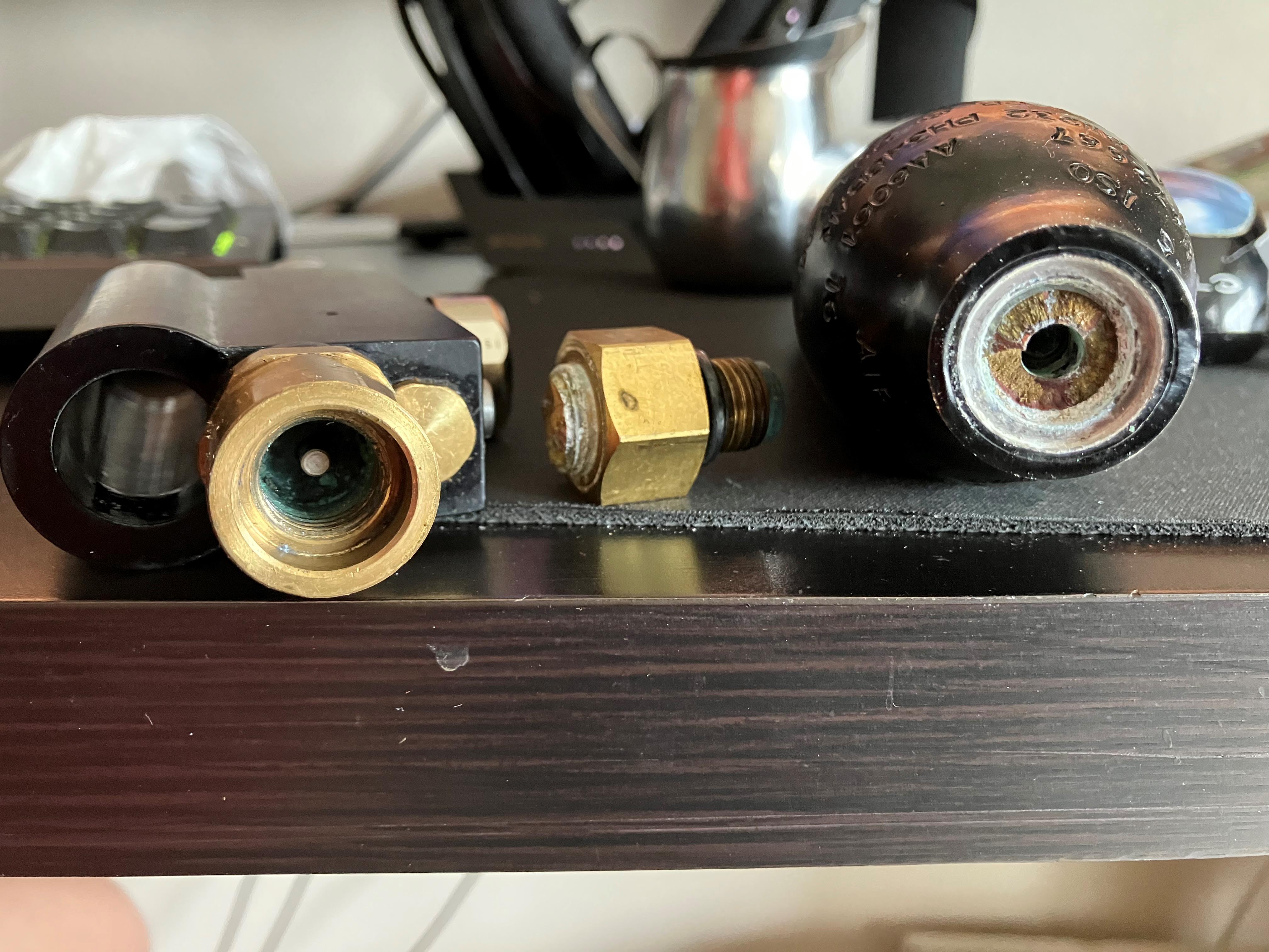

The pic below is from my BSA R10 I purchased new in 2015.
I know I've posted this on a few threads, but please check bottles that are 2+ years old ... especially if you used or have used a hand pump.
My Xisico GTX compressor hasn't produced any water in my RAWS. Also, Stainless Steel bottle valves gives superior strength.
Yeah Ezana,
The brass bottle connection had cracked during a period of time I wasn't shooting the gun much.
I wondered why it would leak a full tank every week, but I was too busy shooting my RAW's to look into it.
Finally, when filling with my compressor, it wouldn't hold air at all.
When I tried to unscrew the bottle, after a moment ..... it simply broke off the gun in my hand o_O.

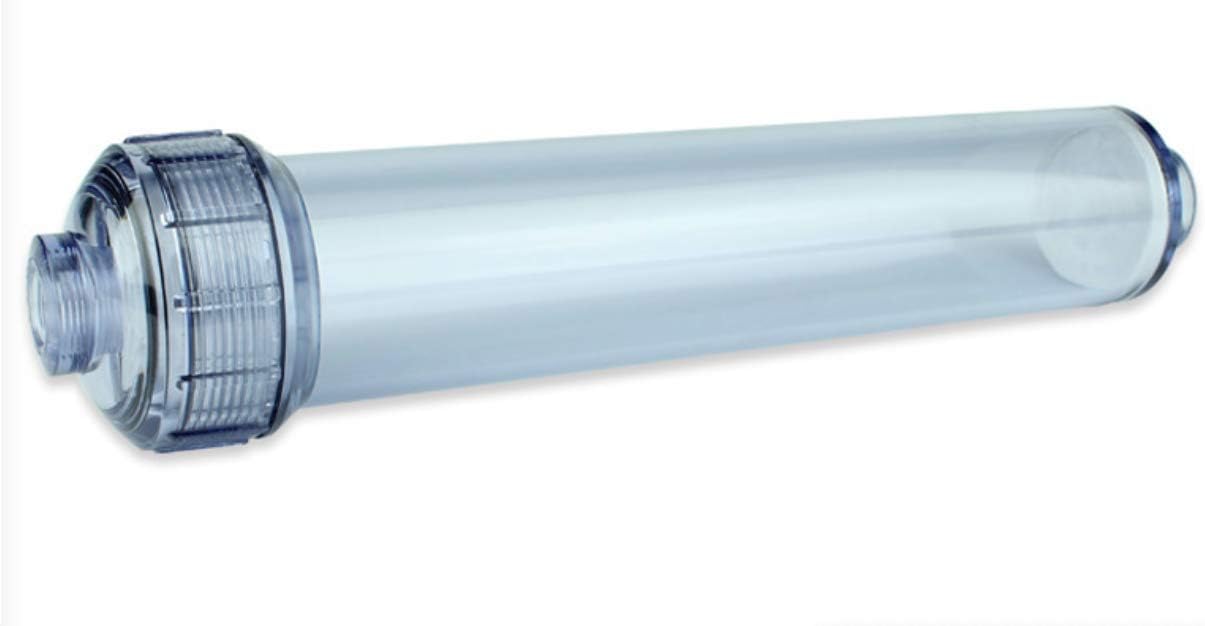

As an experiment, I tried putting a cylinder of desiccant beads on the intake of my small compressor - these are the "purple beads" that turn pink as they absorb moisture - the housing is clear and it uses simple 1/4 NPT fittings and I just put it in line and filled with beads - the housing has fine particle filters at the top and bottom, so the beads stay in.
Poly tube slip lock fittings and a little poly tube routed out of the compressor case connects the filter housing and the other end of the housing is just open.
This has seemingly worked well - the small aluminum filter post compressor with the cellulose filter would be soaked after filling a 400cc bottle - now its completely dry even filling the 400cc bottle from empty to 300 bar - it doesn't restrict the flow on a small compressor enough to make any difference to the fill time.
These beads can be regenerated by heating - and the color change is noticeable and clear - so far, its working well, is cheap and no high pressure concerns.
Curious if others have experimented with this - I use the same approach for the vents on my vacuum systems so when the vacuum is released, the incoming air is as dry as possible - to reduce pump time and re-cleaning the chamber - and it works there too.
