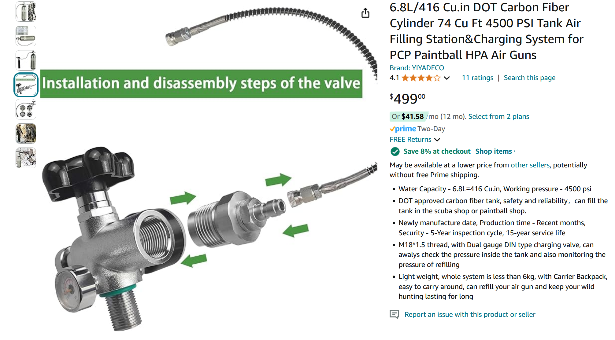

I ordered a 6.8L tank from Amazon, still waiting for it but the valve doesn't have any extended tubing or stem, looks like i could just turn it upside down to purge any water collected in there if necessary, have the CS4 coming at the same time to fill this thing.
My thought process was that the tank will be used as a main moisture collector and heat-dump reservoir, once the tank is completely cooled down, the air being pumped into PCP gun from the tank will be dry and cool, it should theoretically contains less moisture once the water settled at the bottom of the tank, and having an inline moisture collector wouldn't be as big of a deal or even necessary since the tank will be collecting moisture instead, one less thing to maintain. Another reason for getting the tank is so i can bring it to the range instead of compressor.

Makes sense because these paintball/PCP valves are not a part of a life support equipment.
