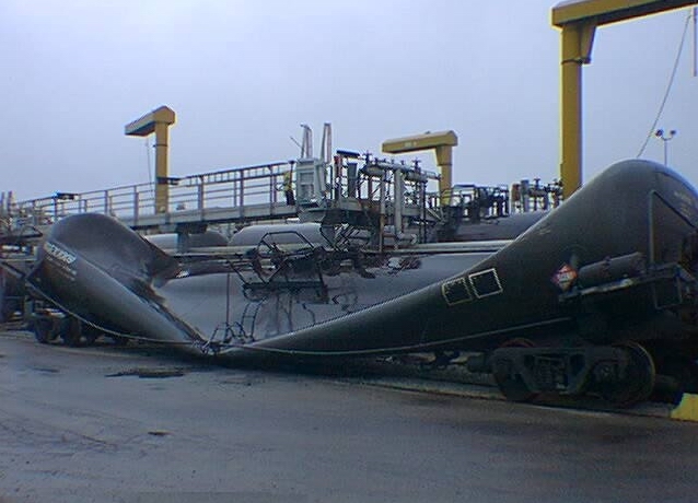

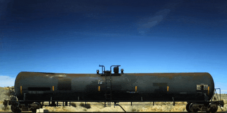

Also, the is no need to pull a vacuum on a tank before it gets filled - as long as there is no liquid water present to start, the small amount of water vapor that exists in the ambient air in the tank is inconsequential - remember that if we are filling the tank with appropriately dried air, that starting level will be dilute 300:1 if filled to 300 bar gauge. But even if you did do that, the tank should have no issue withstanding 1 bar of negative pressure as they are so strong to begin with to withstand 500 bar of positive pressure - they could not handle that kind of negative pressure differential, but 1 bar of negative differential would be noise to our tanks. Remember that that those huge train tanks that are shown collapsing are not made for pressure, but for liquids . . .
Almost correct... Train LP tank cars do the same thing, made for pressure, not vacuum.
This is exasturbated by the 2-3mm aluminum lining inside a CF bottle.
Seriously, have we already forgotten about the CF sub that imploded last year?
