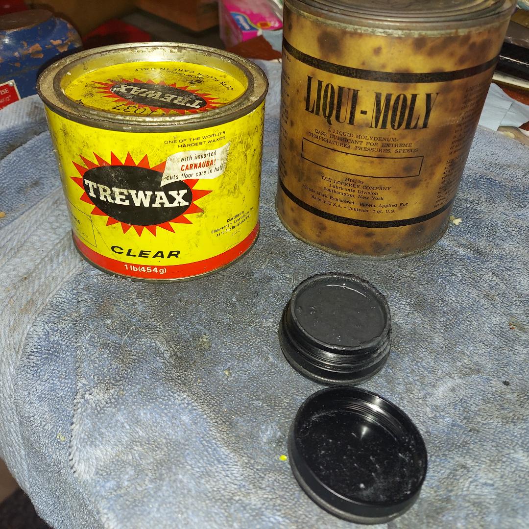

Now I could see ... melting some TreWax and adding dry moly powder & mixing well. Let harden in a small sealed container.
Lapp / Polish & clean your barrel to a squeaky dry surface & Use the moly-wax mixture as you would straight TreWax on snug fitting patches worked back-n-forth on a stiff cleaning rod & jag tip .... Winner winner & may need to try this as I have both the components :unsure:
Ok, went out took a spoon daub of Tre-Wax and a slightly smaller scoop of Dry Moly powder and heated it up then stirred.
Once cool should have MOLY-WAX 🤪
FYI ... Can of wax is @ 50 yrs old (1970's ) and Dry moly closer to 70 ( 1950's ) Both still very viable.
