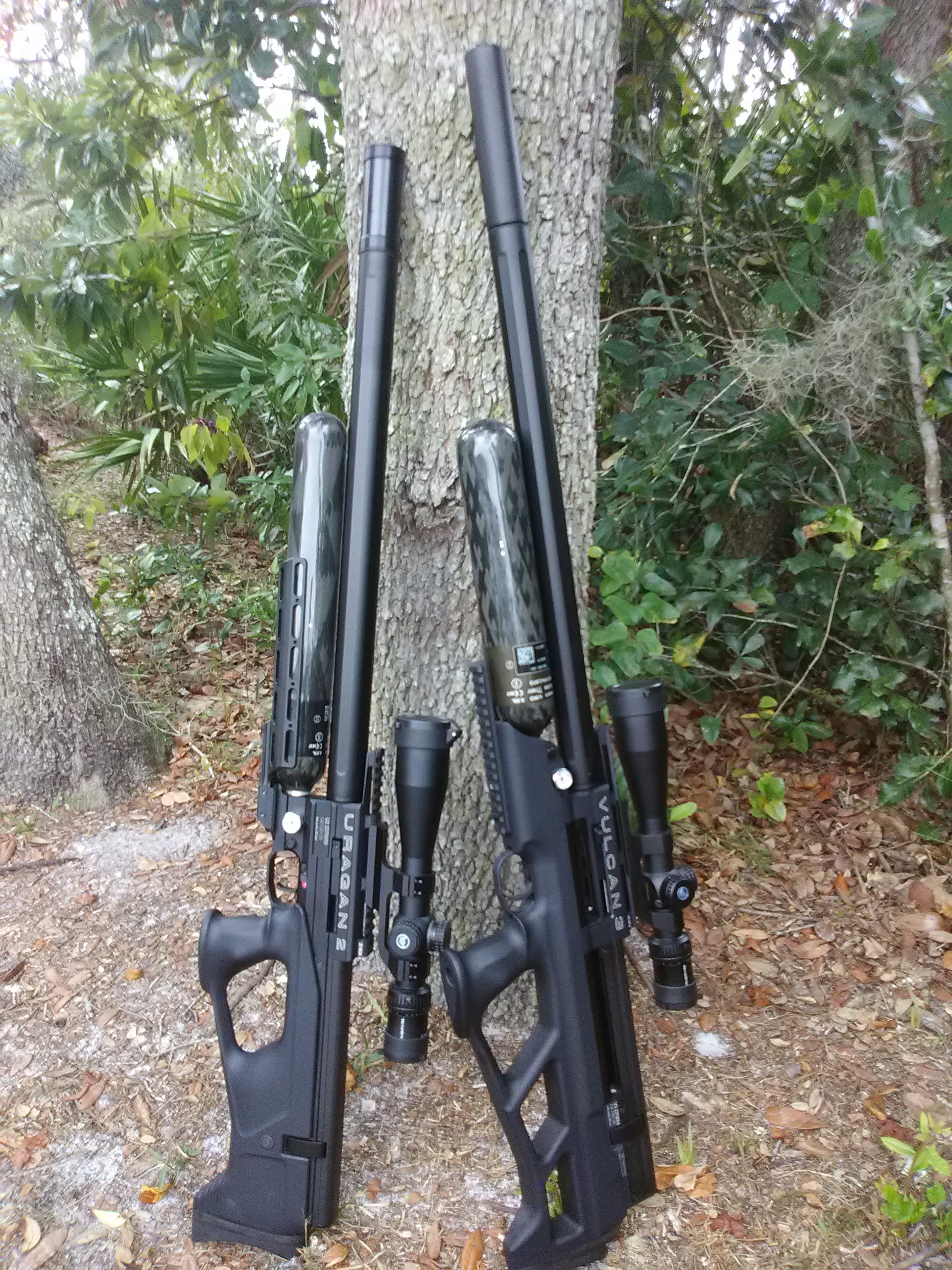

Chronograph results with JSB 44.75s. U2 984fps, V3 986fps. Accuracy, U2 by a landslide. Tested many slugs and pellets in both, U2 is more accurate, with more choices, than V3. Even with factory installed depinger, V3 clangs in ear at each shot, not so with U2. WM

Chronograph results with JSB 44.75s. U2 984fps, V3 986fps. Accuracy, U2 by a landslide. Tested many slugs and pellets in both, U2 is more accurate, with more choices, than V3. Even with factory installed depinger, V3 clangs in ear at each shot, not so with U2. WMView attachment 496315

Sorry, haven't checked reg setting nor shot count. Plenty of power and shots for my liking @ 300BAR fill. Haven't felt need to adjust anything like I did HS in Uragan .25 to improve JSB 33.95 grouping. U2 and V3 have 700mm slug barrels and prefer 59-62 grain selection. WM
@Scott.t I will have to agree with WorriedMan, the Uragans are nicer to shoot due to smoother cocking lever and no ping in comparison. The depinger does nothing for the Vulcans unless you reverse where the regulator is in the airtube and set it for low power but higher shot count.
Devasted unruly crow population with FX Wildcat MK3 Sniper .30 and JSB 44.75s, now none come closer than 100yards. Purchased V3 and U2 .30 slug guns for longer ranges since Wildcat was maxed. V3 and U2 have been a pleasure to own, would never sell either, just side-by-side shooting does leave preferences. Crows are now 200+ yards out so that's far enough. WM
