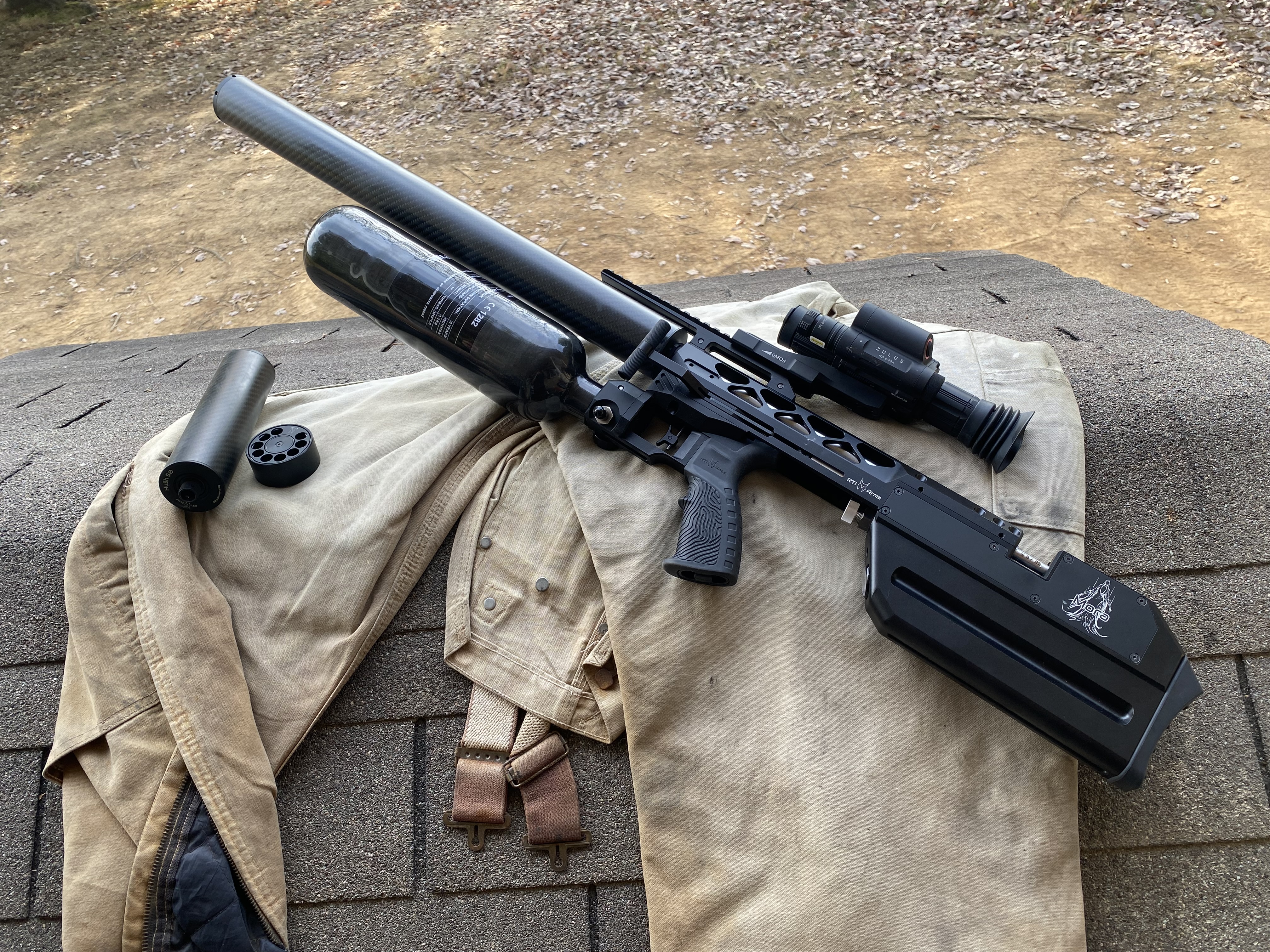

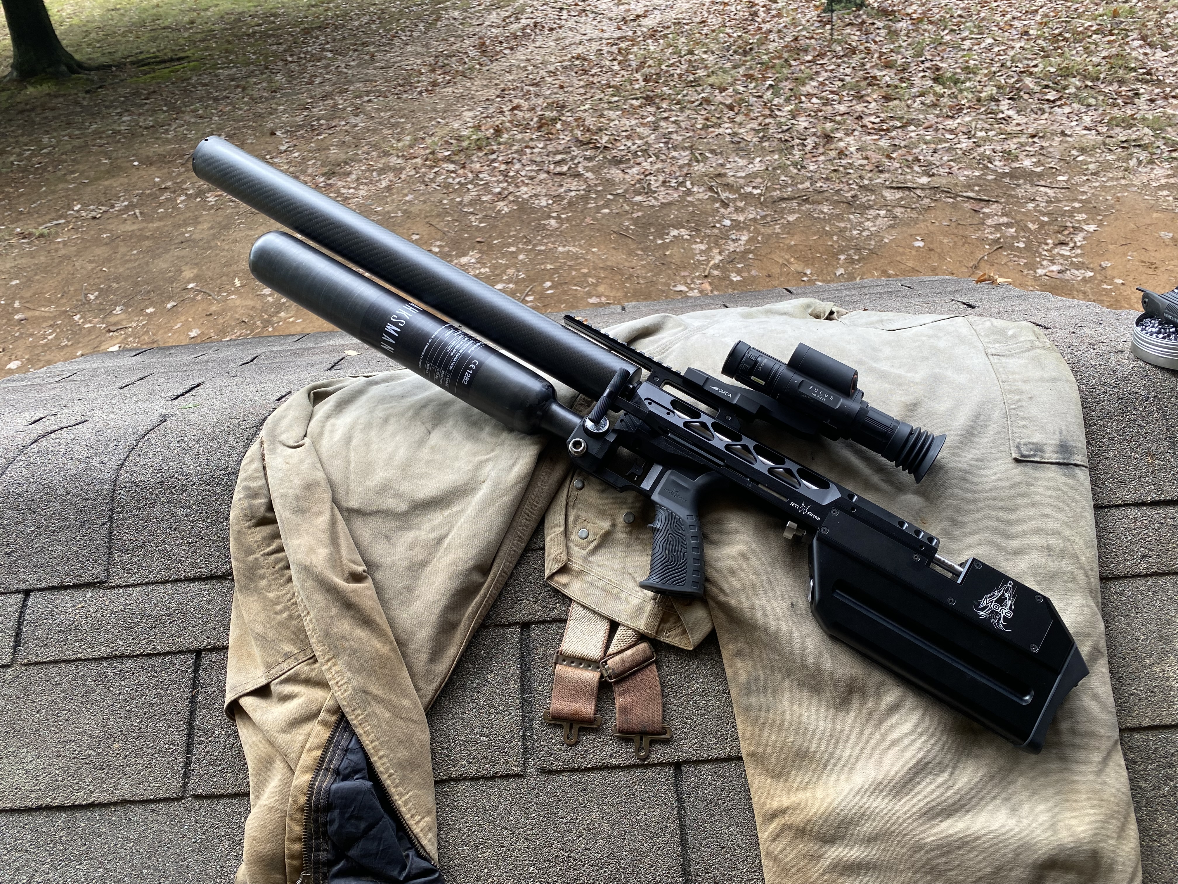

Next time one of the Mora owners have their shroud off can a pic be posted of it with just raw barrel.? I would be interested in not running the shroud & looking to see how it would work out with just a mod or nothing at all.
Here is a couple pictures. That is with my 700cc tank. They come with a built in silencer which works very well, then the additional silencer that screws on the end if you want to quiet it even more
Thanks for pics.

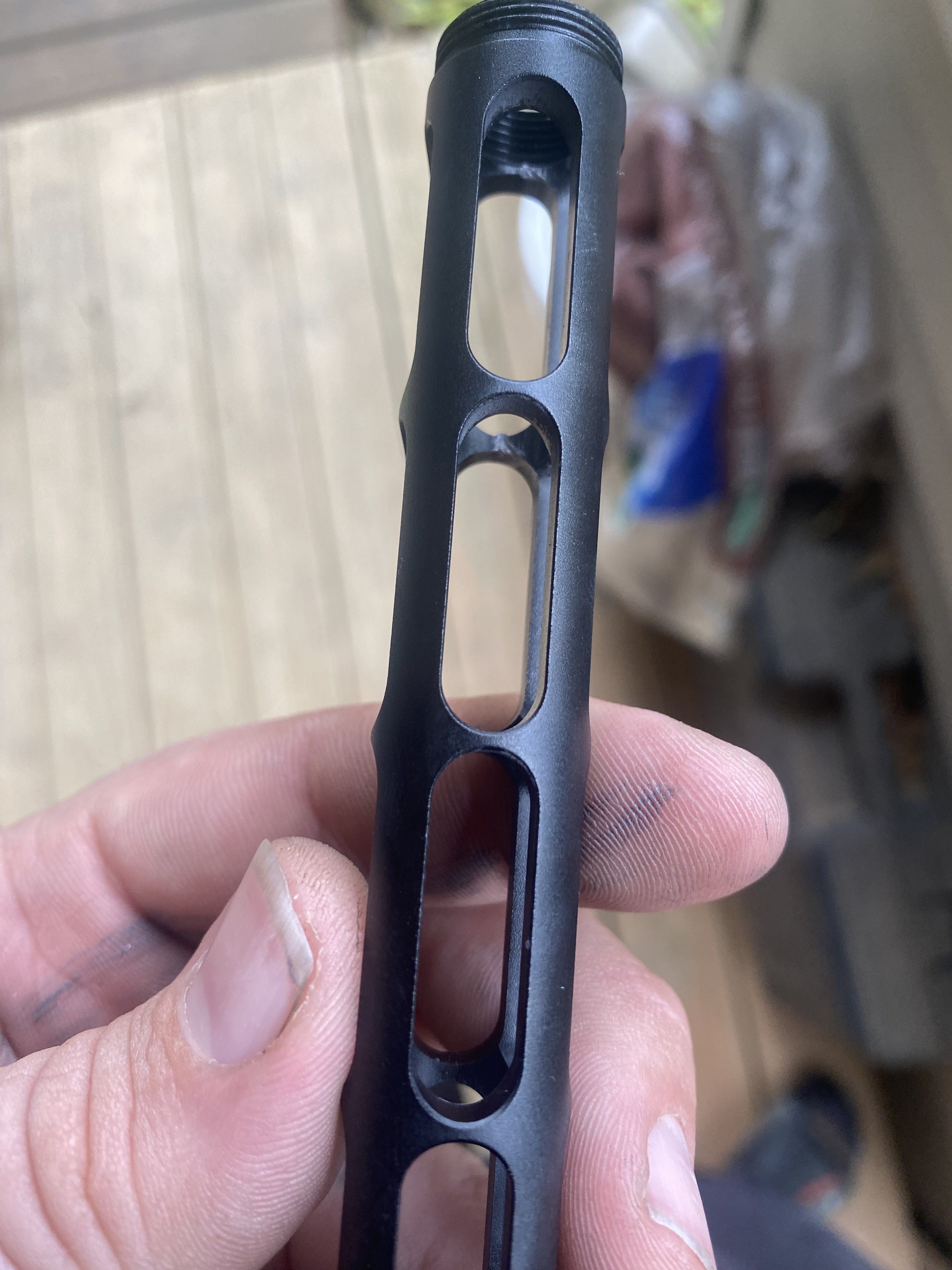

I see barrel isn't threaded. I like that. One could put a slip on adaptor if needed for a mod. My curiosity for how I would run a Mora is how is the front barrel bushing mounted to frame & is barrel to that bushing full contact via barrel to bushing or something different.? I would not be running it in full float mode so the bushing system is important to me.
Thanks for pics.
The barrel is threaded. There is a bushing inside the frame just behind the shroud mount that supports the barrel, there is a nut to tighten it down, right here in this picture that my finger is on
