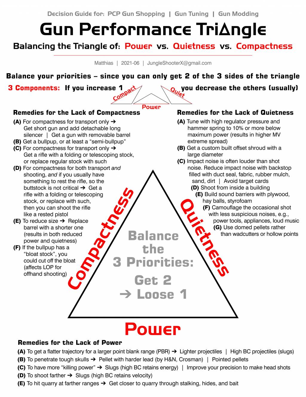

🔸Franklink, I'm not sure if I'm on a "quest" just yet — I just really like short guns, always have. And there are situations where people could get frightened if they saw a gun (the country where I chose to live went through a terrible time of terrorism in the not too distant past....).
🔸I am painfully aware that shortening a gun comes at a price, cf. the Gun Performance Triangle attached below. 😊
However, one of my observations in the OP was that technological development has advanced in other areas — but not much in the area of compactness to "reduce the price of shortness" by improving silencing and power delivery despite a short barrel.😄
