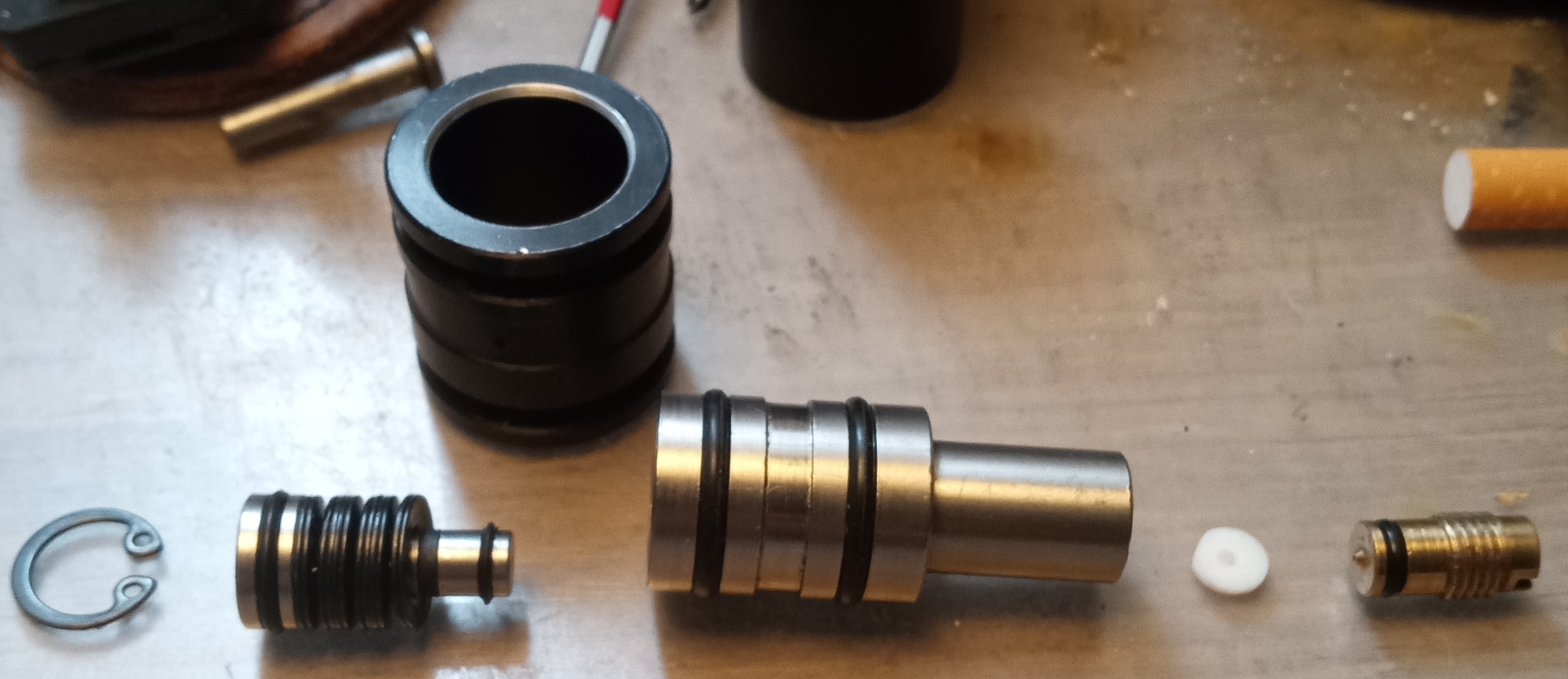

Here's a DAR Gen 2 regulator taken apart.
The black section is only the carrier for the regulator in the air tube. I've beveled that as you can see to make it easier to press the Regulator back into it and not sheer the o-rings.
One thing I don't like. The Delrin seal (white disk) is 1 mm thick. The point on the Brass part is .5 mm and has nearly cut through that. Flipping it over I'd suspect a short life fix. The dimensions of the delrin is 1 mm thick by 6.95 mm diameter. I'm thinking of making a new one and taking a bit off the brass part.
Near the belleville washer stack you can see an o-ring. That is actually just a part that has sheered off. I don't think it has any air pressure and just holds the stack in place when assembling stuff.

FWIW, I blunted the “volcano” orifice a little when I rebuilt mine. Wet sanded and polished.

Looking real close at the design and that failed o-ring near the belleville washers? I'm thinking that was my 1 PSI per minute leak.
I'm going to see if I can cut a slight bevel inside the Regulator body in that area. What I see is no bevel or a rough bevel?
A very slight radius or bevel is reasonable if the O-ring is getting shaved when reinstalling the piston. The engagement depth of this O-ring (narrow end of piston) is usually not very generous on most regulators, and appears to hold true in this instance based on the Belleville stack shown in your photograph. Just saying anything more than a slight bevel could produce a leak.
Mine also had no lead-in but a little silicone grease on the metal and the O-ring allowed it to go together successfully.
The original size of this O-ring is a M1.5 x 3. I wanted to use Viton but I didn't have this particular size on hand so I took the nearest dash size, a -005, and abraded its ID using a conical diamond burr until the thickness was reduced from 0.070" to 0.060".
