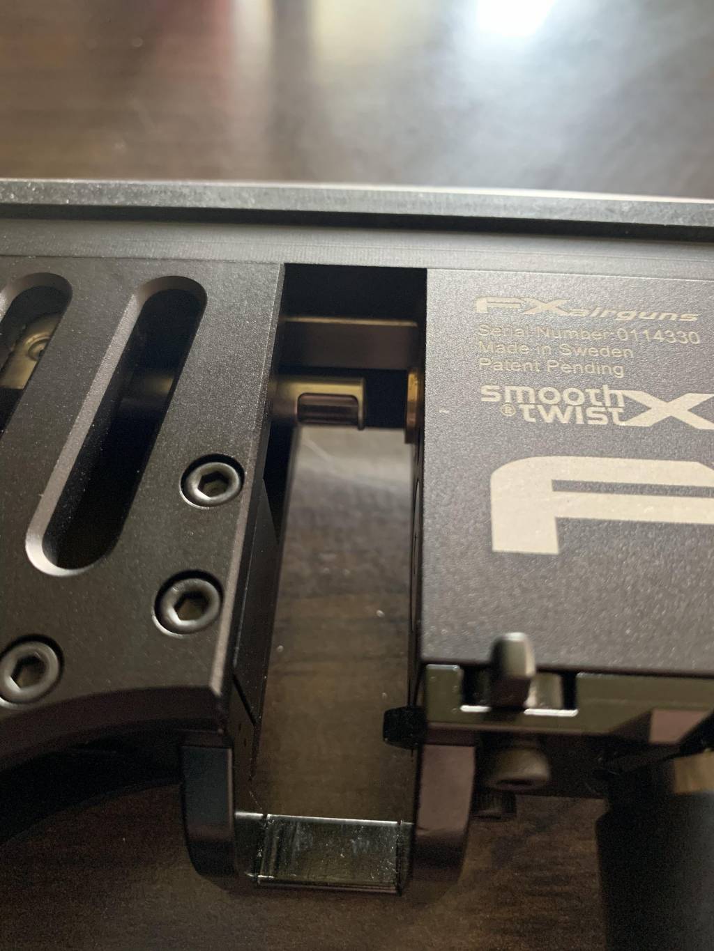

So I finally installed my Orion impact magazine inserts. It completely solved my loading issues I had with the huma and factory pellet probes. Thanks @orion! So I have the huma high flow pellet probe installed, and I set the depth based on how the ports lined up with the barrel outside the gun. Everything seems fine, but now I feel some resistance when loading a pellet right at the very end of the cocking stroke. It happens with all the pellets I’ve tried, but not with slugs. Can I assume this is normal? Or should I be backing the pellet probe out a little to stop the resistance?
I measured from back of probe holder to back of frame, and I’m getting about 43.5mm. An Ernest video I watched stated 45, so mine is actually further out of the port than factory. That being said, I’m using the k&l probe holder and huma high flow pellet probe, so maybe machining is different on both?
any help would be great.
