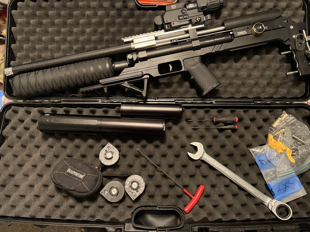

That's fantastic progress there Gino! And with a 600mm barrel it's even better yet.
Thanks, Glem! I brought it out to the range the other day to test it out. 10-15mph winds with nothing to use for indicating wind speed and direction. Spent a good 5 hours testing 3 different barrels (500mm .30 Superior 1:37, TJ .30 1:26, and a 600mm Superior Heavy .22).

mntGhost,
Just had my Maverick apart this evening replacing my PP O-ring and was pondering new upgrades. Your modification idea is very intriguing. Thank you.
Patrick
Yeah, it's a fairly low tech solution that mainly benefits longer barrels. More like a stop gap solution. I have some better ideas on how to increase and control the poppet travel, but I just don't have the time to fabricate all of the parts needed :(
