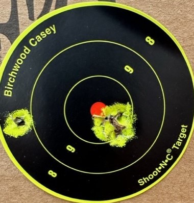

I have just started PCPing with a .22 P-Rod, set up as a carbine with a long eye relief variable pistol scope set at 5X. The 16.05gr pointed copper coated H&N Excite Coppa Spitzkugel is a one-hole pellet at 15 yards rested.
