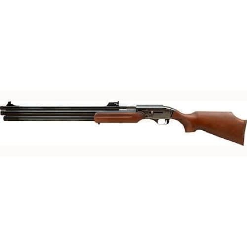

It's not imported to the US but the SamYang Snipe is a 380cc 22cal version of the Dragon Claw .50. Supposed to shoot 33gr pellets over 1150fps. So essentially a 100ftlb 22 out of the box. Plus just looks sweet.
