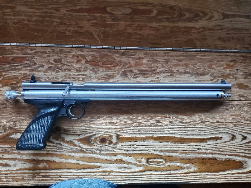

I owned a .50 Quackenbush PCP pistol for a while. Any caliber Quack being made for maximum power, FIRST THING I did was de-tune it to return multiple consistent shots, rather than losing velocity with each shot. As excerpted from Airgun Chronicles-
"As received, this .50 pistol produced 640 FPS on the first shot and 550 FPS on the second. After a re-seal and much de-tuning, it now returns 2 consistent shots per charge."
181gr Speer .495 balls, 3000 PSI charge- Low= 567, High= 587, ES= 20, SD= 7, Average= 579 FPS/135 FPE.

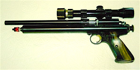

One of my more recent projects was butchering a perfectly good $2200 .22 Brocock Bantam Sniper PCP rifle into a pistol/carbine convertible. In either form (pistol or carbine), it gets this-
18.1 grain FX, 125 BAR reg pressure, Power Level 4, 8 shot string- Low= 844, High= 849, ES= 5, SD= 1.7, Averages= 846 FPS/28.8 FPE.

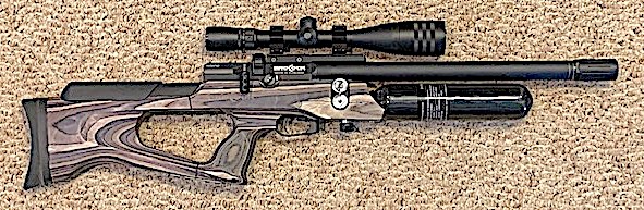

In carbine form-
