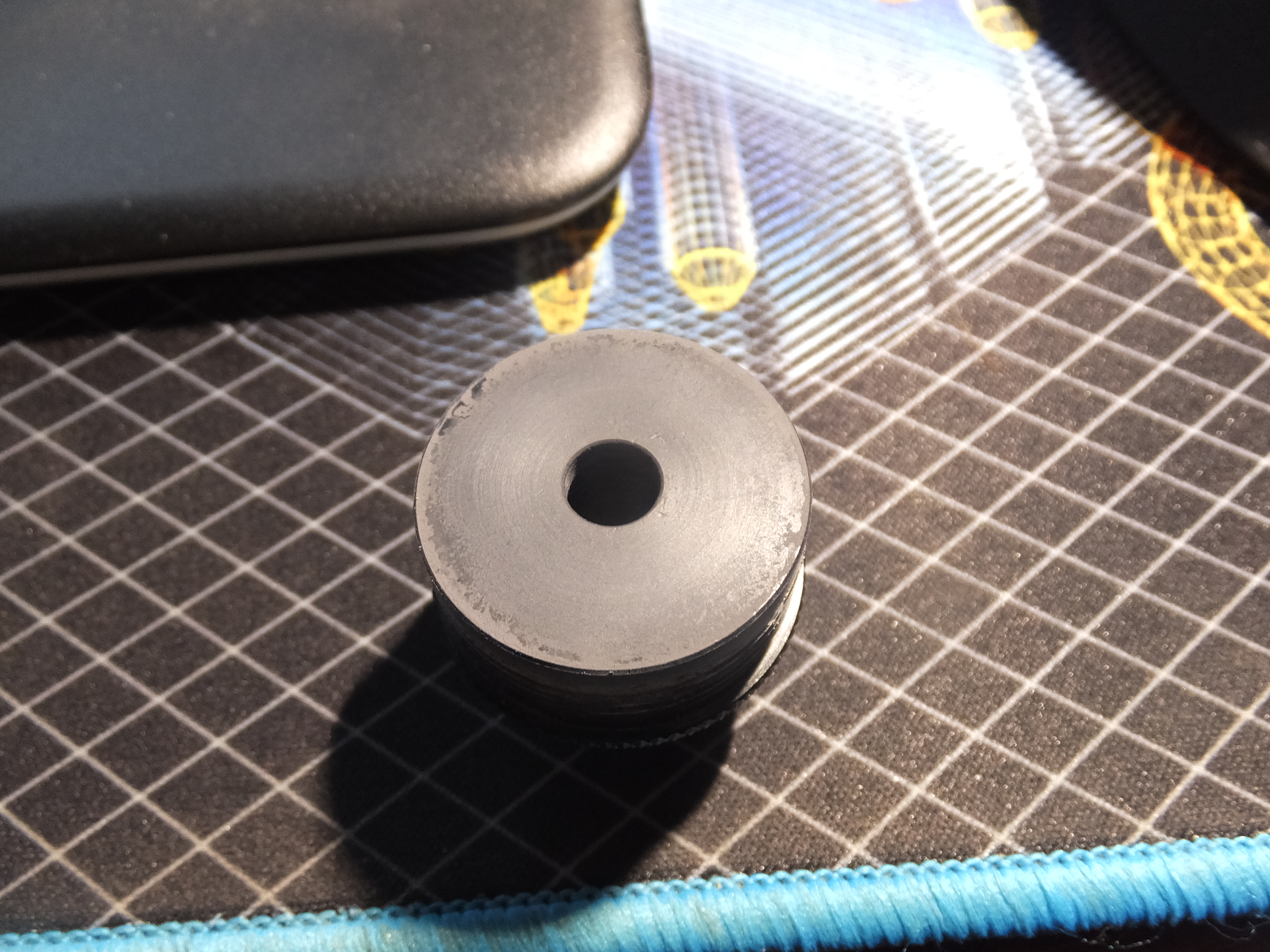

Here's what I did with my FX Crown. On the rear of the end cap for the shroud, I epoxied a flat baffle and have the shroud ported with a small hole at the rear. Can't recall exact specs, but the baffle is milled to the exact ID of my shroud, and it has a 6.3mm hole in it. This traps more pressure inside the shroud, and delays it's exit. Making a moderators job easier. (dispersing, delaying pressure and volume exiting the bore) The moderator is a factory FX continuum mod with 25mm extension and 5 cone baffles that are 3d printed. Cone shaped baffles create more turbulence in my experience, further delaying pressure and volume exiting. At the end of the mod I have a wire mesh cage that holds a roll of felt. The felt takes the edge off of the report right before all of the air exits the device. But most importaintly of all, a tune that utilizes high pressure, and low volume will be the quietest. I have my gun tuned to about 135 bar. 150 would be quieter for the same power level. The less power output you have, the quieter you can tune it as well. I shoot a lot around 650fps or so for this reason. At full tilt, you can only quiet the gun so much, at which point, the moderator doesnt matter so much anymore.

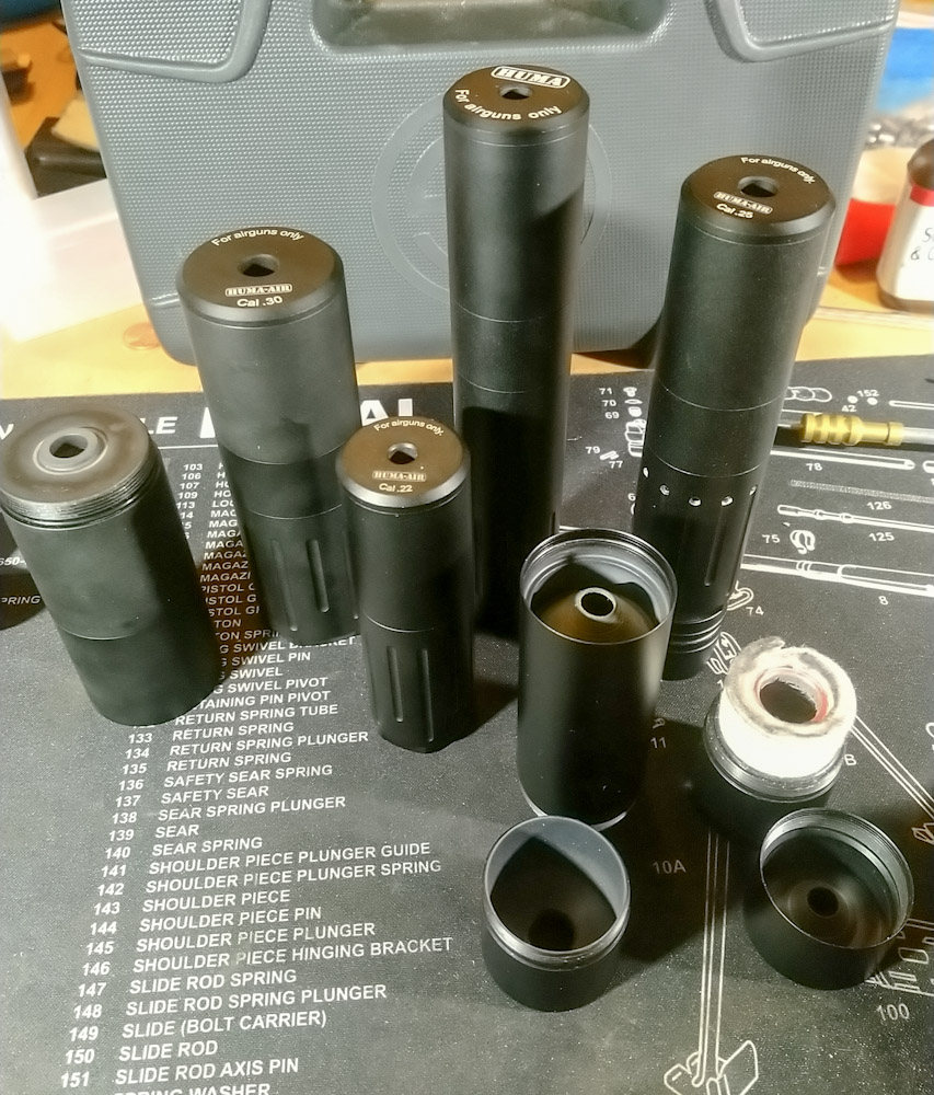

  • Huma Mod30 with varying number of stacks and empty chambers offer an excellent performance on .177 and .22 caliber airguns.
