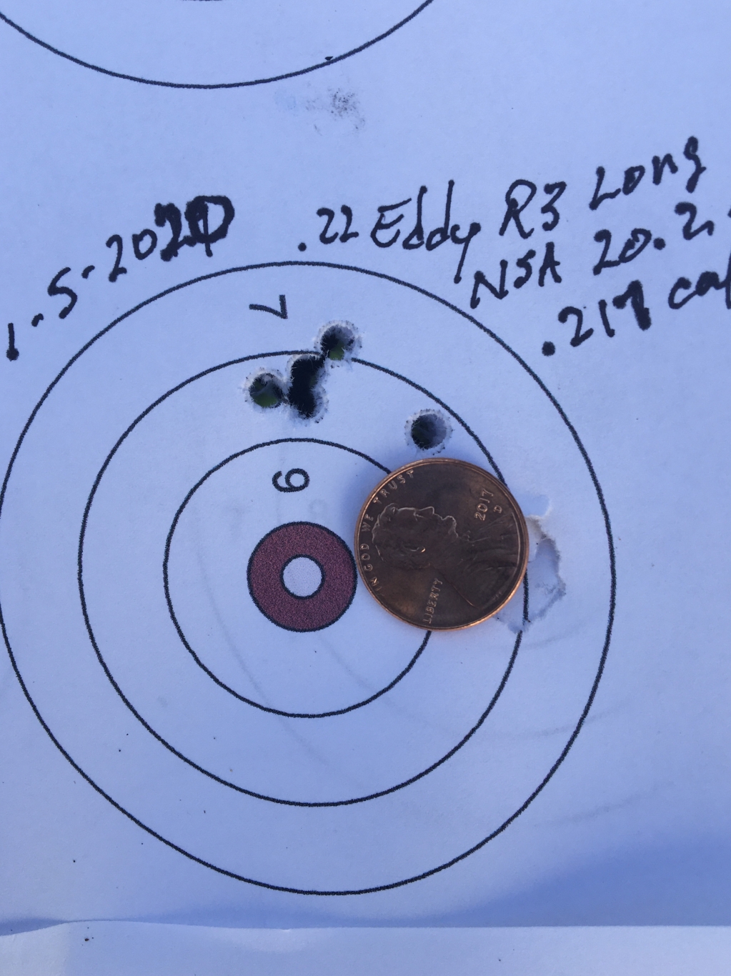

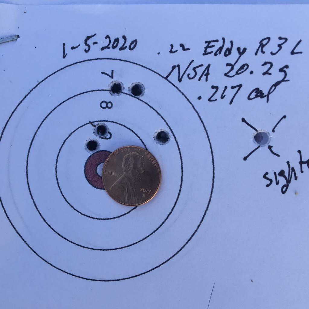

Thanks. It’s been a lot of work to find a slug to shoot in a choked barrel. Got lucky and tried the NSA 20.2 grain HP DB in my EDGun R3 Long at 975 FPS. Inside an inch on 5 out of 6 groups (5 shots each) at 110 yards three weeks ago. The gun has a fairly light choke. I haven’t tried the FX hybrid (ratsniper) slugs yet but plan to soon. Here’s two of the five shot groups at 110 yards. One 5/8 inch the other 7/8 inch.
1580083740_15190498025e2e2a1c8e20b9.25405230_FE2D6C26-0010-4849-BB58-4CDAFC9224C2.jpeg
Centercut,
Good groups fore sure.
What does your choke slug out at? Do you think that sizing for the choke is the answer.
