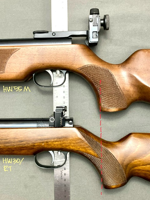

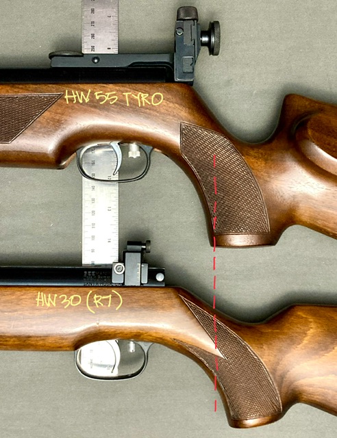

I believe one of the most under rated features is the pistol grip inside radius and reach to the trigger. In the HW line up, the venerable HW55, a 10m target gun, has the grip with the tightest inside radius and shortest reach from the grip to the trigger. I have big hands yet these "tight quarters" feel really comfortable to me. In very close 2nd place are the larger R series gun, like the R1, with a barely noticeably larger inside grip radius and reach to the trigger. The worst offender IMO and in a distant 3rd place is the R7/HW30 which has the largest inside grip radius and furthest reach to the trigger. I find it uncomfortable and wonder why, in a gun that is ideal for youth and others with small hands, is the pistol grip designed like this.
FWIW, I believe the R7/HW30's very open grip and long reach to the trigger for the index finger is what generated so much debate over the R7/HW30 LOP. A tape measure stretched from but to trigger confirms the HW30 LOP is similar to other HW guns, it just feels longer.

I have tiny little baby hands, which suck because I'll never be able to daily carry a desert eagle 😂 Joking aside thats my main reason for visiting this forum. I'm in the market for an HW. is the HW55 the only one with that shorter grip radius? I know it's a pretty small gun if not one of the smallest/lightest if I'm remember correctly (maybe im thinking of the HW30*?).

If you're thinking smallest/lightest you're thinking of the HW30. The HW55 is a long out of production gun and is not small or lightweight. Don't let my comment dissuade you from buying an HW30. There is nothing wrong with the design, I just think they could have done a better job with the pistol grip dimensions. I happen to have two R7's and an HW30 and they are great guns that are as accurate as any HW and a hoot to shoot. Unless power is a criteria, you won't be disappointed with one.

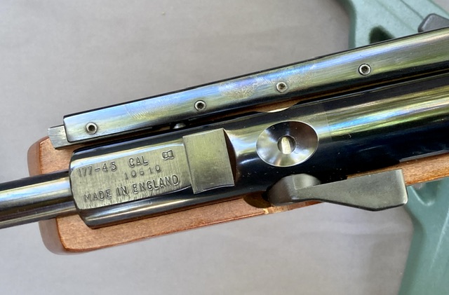

I'm a big fan of the old-fashioned rotating loading tap.
It's a compact, sturdy, and simple way to a make fixed-barrel springer. The action is slimmer and lighter than any sliding-breech-sleeve gun, since the piston is surrounded by only one layer of metal. It's the safest springer design ever, too (it's phyically impossible to discharge a pellet or slam the piston from an open tap). You can carry a cocked-and-loaded gun in perfect safety that way.
It does depend on careful workmanship to achieve good accuracy, but these guns can be very accurate indeed - just ask anybody with a classic pre-war BSA underlever or one of its descendants from Diana, Haenel, Webley, BSF, Falke, and others. I'd love to see a current manufacturer take a fresh look at this mechanism (which ain't gonna happen outside of my dreams, but...!).

The long grip-to-trigger stretch has been a feature of most Weihrauch rifles since forever. Since you asked about the HW 55 (an older target rifle based on the original HW 50; both a bit bigger than the HW 30 / R7)...the standard stocks are indeed a bit different from HW sporters (as r1lover mentioned, it's more the angle than the distance); the 55 Tyro has the closest, most vertical grip.
A couple points to remember:
+ It's a 2-stage trigger of course, so the reach is less at the critical 2nd-stage let-off point.
+ If needed, there are aftermarket set-back blade options out there.
Don't underestimate the adaptability of human anatomy, LOL...my hands are dinky too, and work fine with HW's.

that looks so clean. I wasn't aware that was even a thing.
