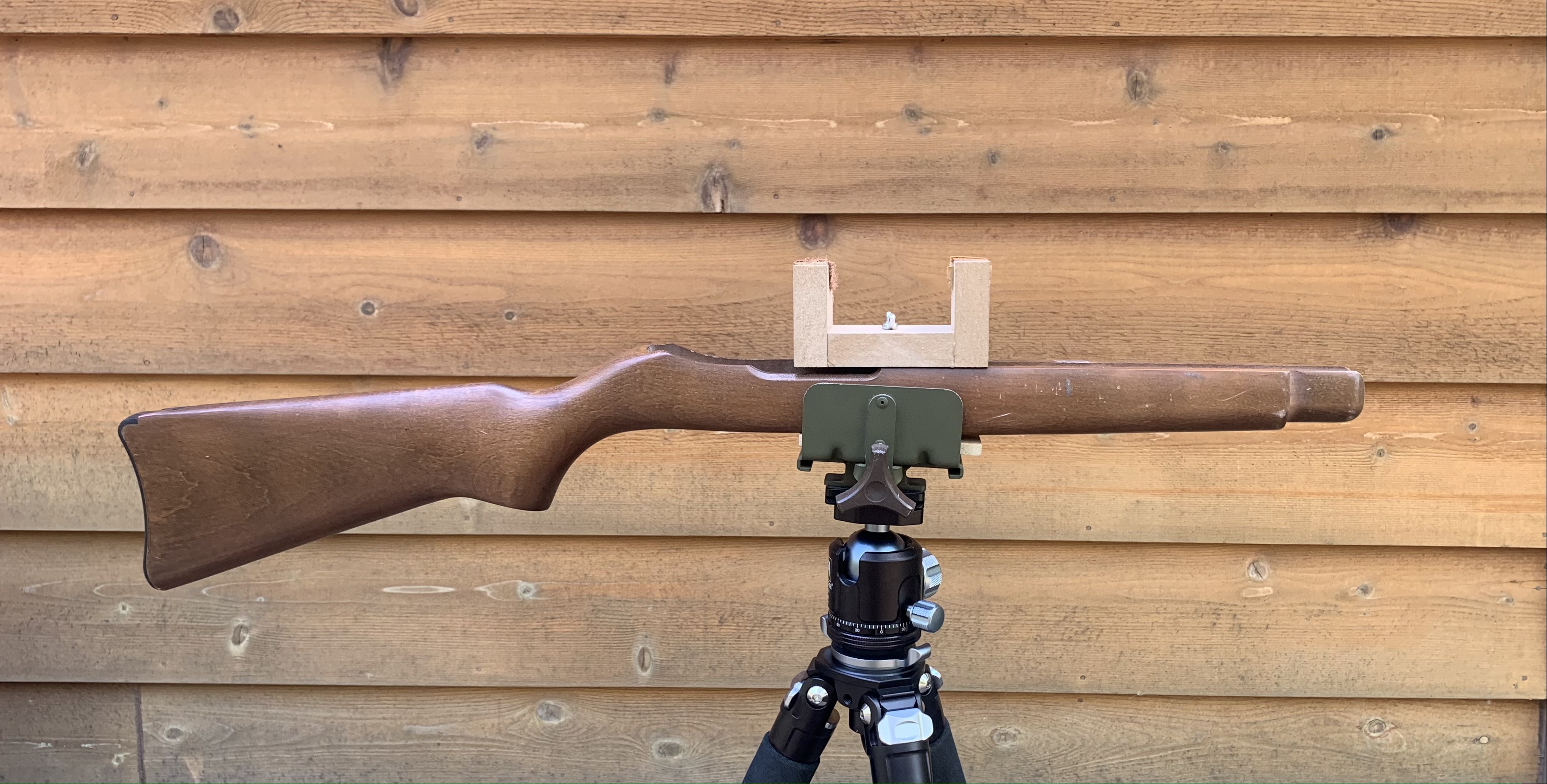

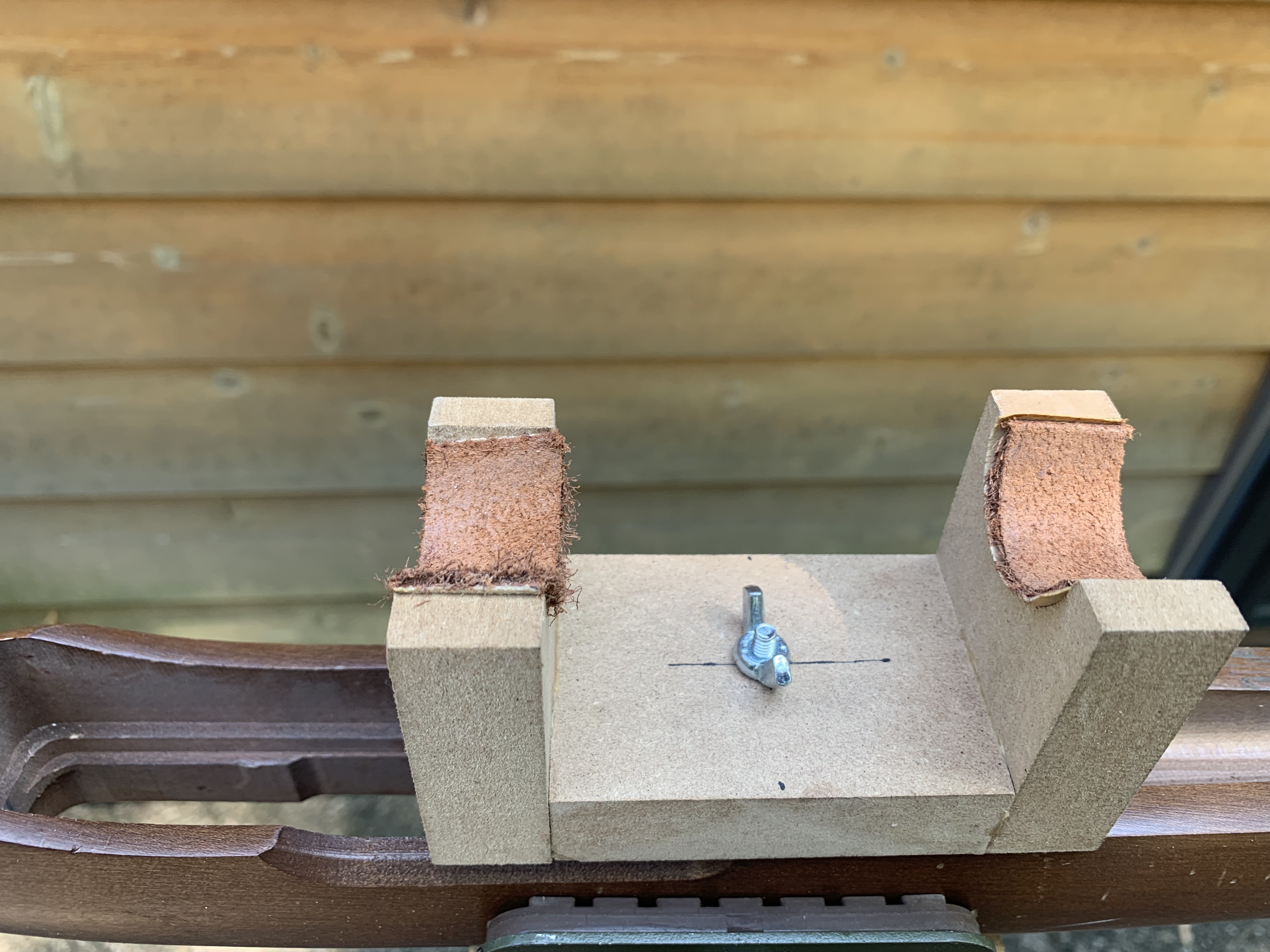

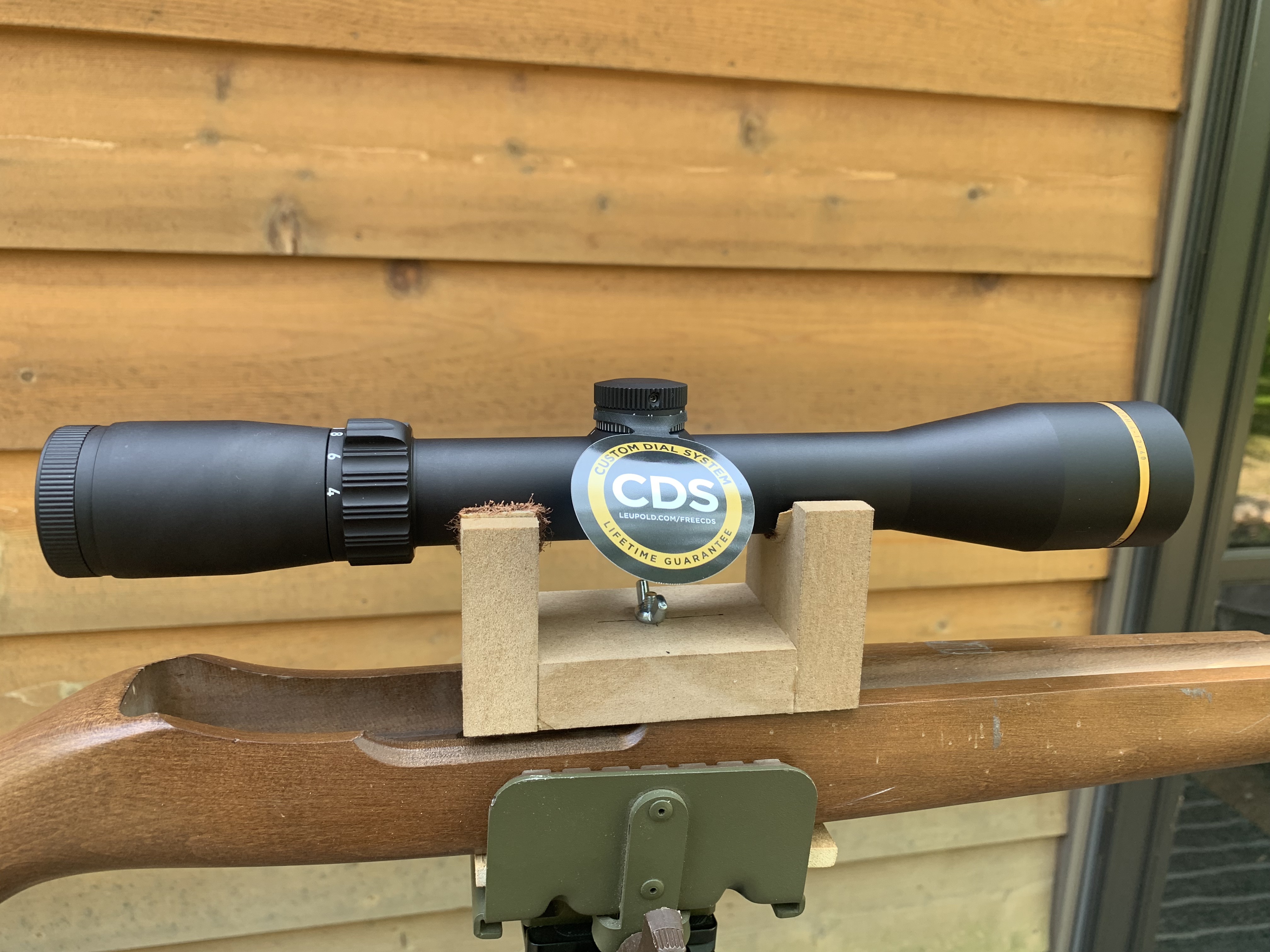

I fabricated a wooden apparatus that looks like a ring base and lined the bottom half "ring base" with leather. Then I attached that apparatus to an old Ruger 10/22 stock. Now I can place the scope in my pseudo rifle to see if I like the scope or not. Nothing gets clamped down, but I can get a pretty good idea if I like the scope or not. I'll post a pic so you can see it.
I have a variety of rubber bands to hold the scope down so it can't accidentally fall off.
