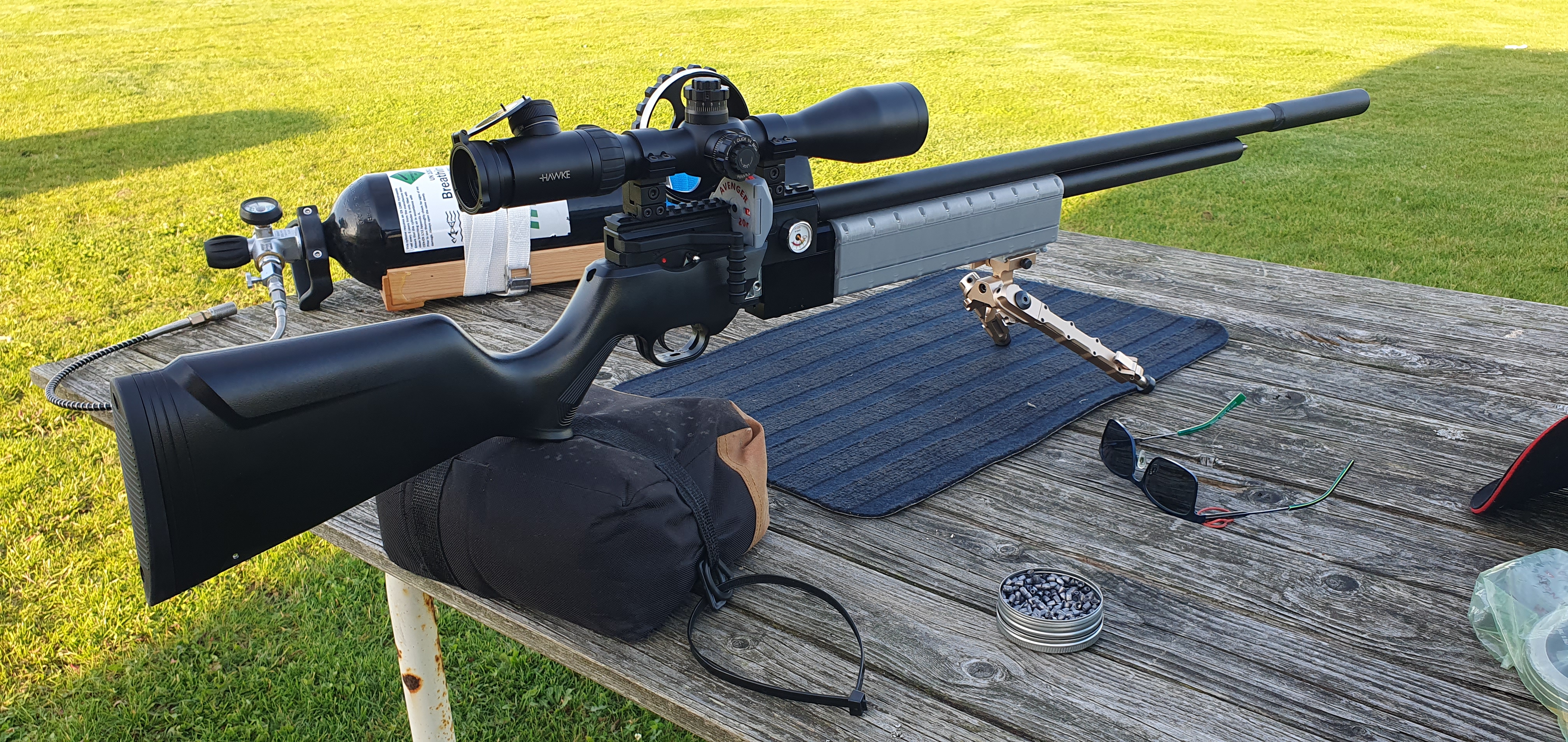

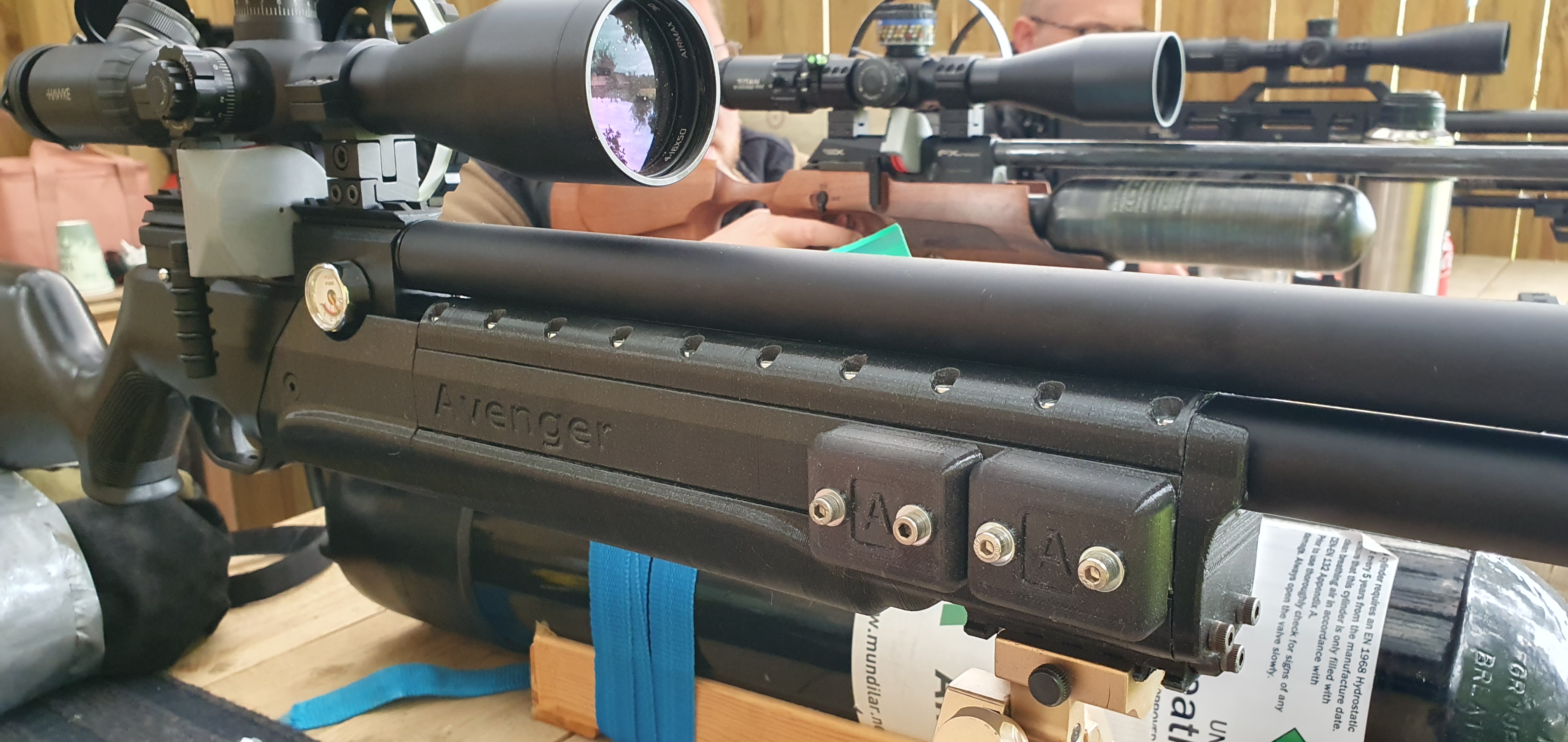

I ended up designing a new front part of the stock - see other Avenger threads.
First I designed and tested the concept of clamping 3 nos. 3d printed parts together on the two the pressure pipes.
Then after successful test I redesigned the 3d model to adapt to the rear stock part.
See below
Then I Installed and tested - Success no more POI shifts - BUt I did a lot more - Trigger - Airstripper -Barrel etc.

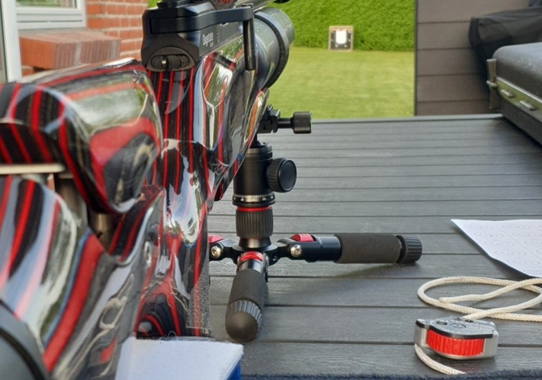

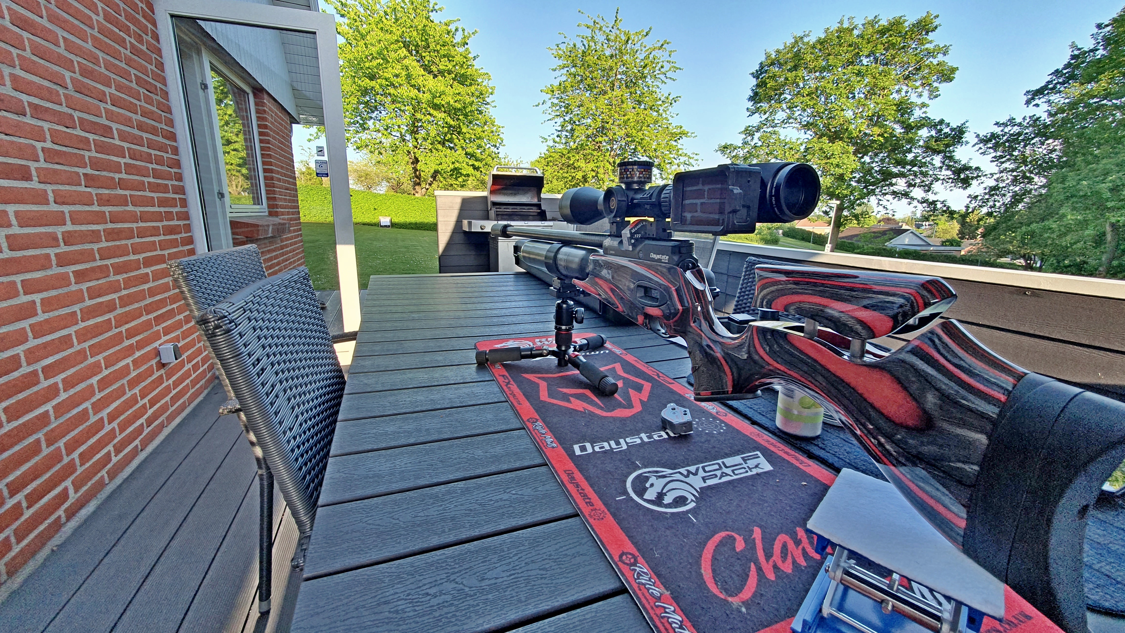

You can also buy a cheap Tripod from china - Alieexpress / Temu or others 40 USD + an adapter from Arca Swiss to Picatinni - Like I did for testing:
This is very stable and makes it much more easy to shoot different targets due to it can turn freely.
I normally use the fixed Accutac, but in the future I will only be using the Accutac FC4 gen 2 or the Tripod solution. Try setting up a A3 sized Benchrest target at 30 yards and shoot - You will note a big difference. (Image showing my latest rifle - Image with my temporary extended rail - Now I got the original Extended rail = much more steady). I still have the Avenger shoots great - I havent tested it on the Tripod but I will do and show shooting result and images.

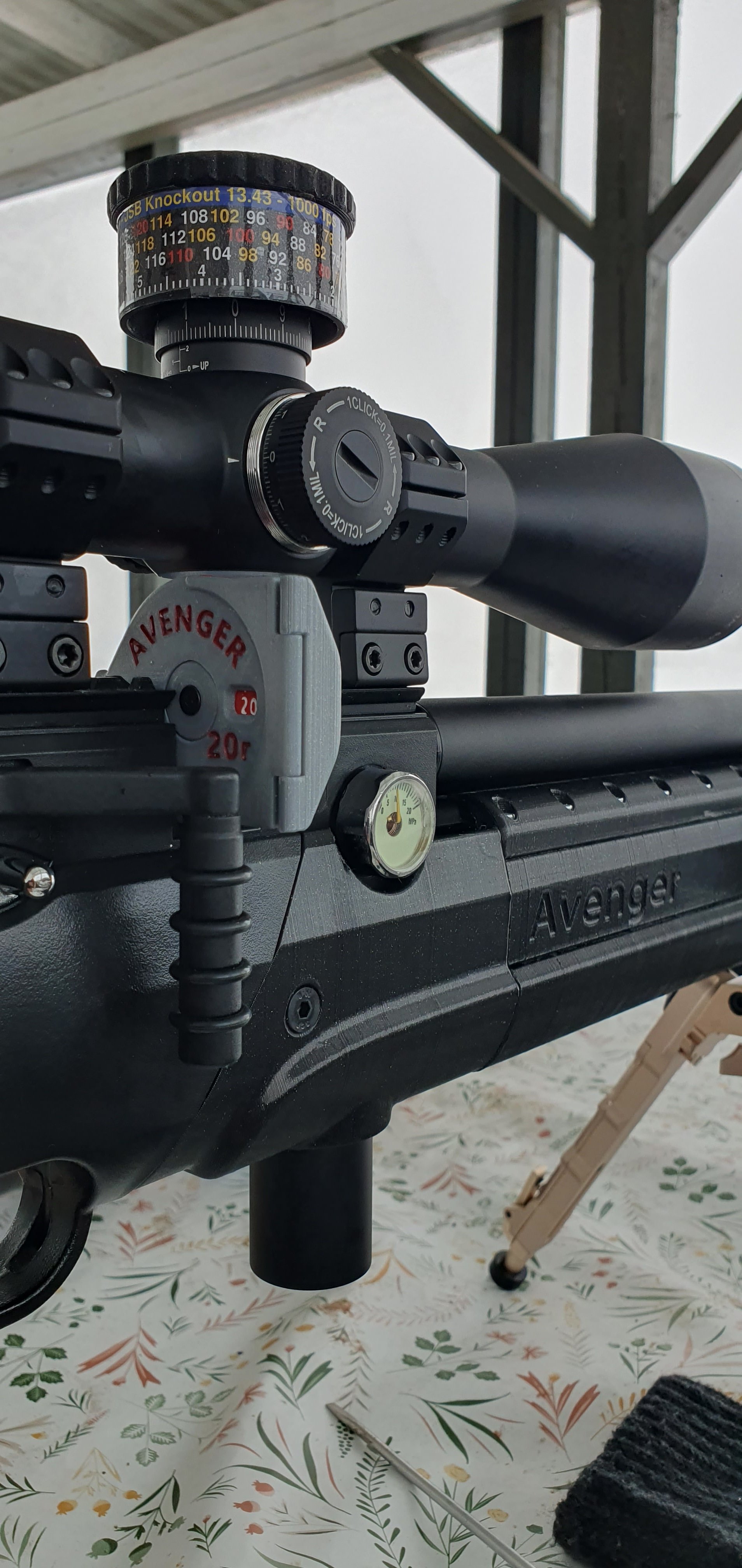

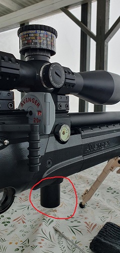

  • What is the vertical cylinder sticking out of the bottom of your Avenger build?
  • Also, any chance you'd be open to sharing the CAD on your stock? Looks great and I'd love to experiment with it if you're open to it.

Hi Mike,
The cylinder you marked with red is an external Plenum.
This means a larger chamber for regulated air = More power or / less air consumptions.
Airstripper means a part that separate the "dirty" air behind the projectile away from the projectile. In my case a 3d printed part that separate and divert the dirty air back in the shroud.
Send me a private message with your email address and I will forward the 3d files for the modificated front stock.
Be aware my Avenger is gen 1 - the stock has changed on the newer versions !
