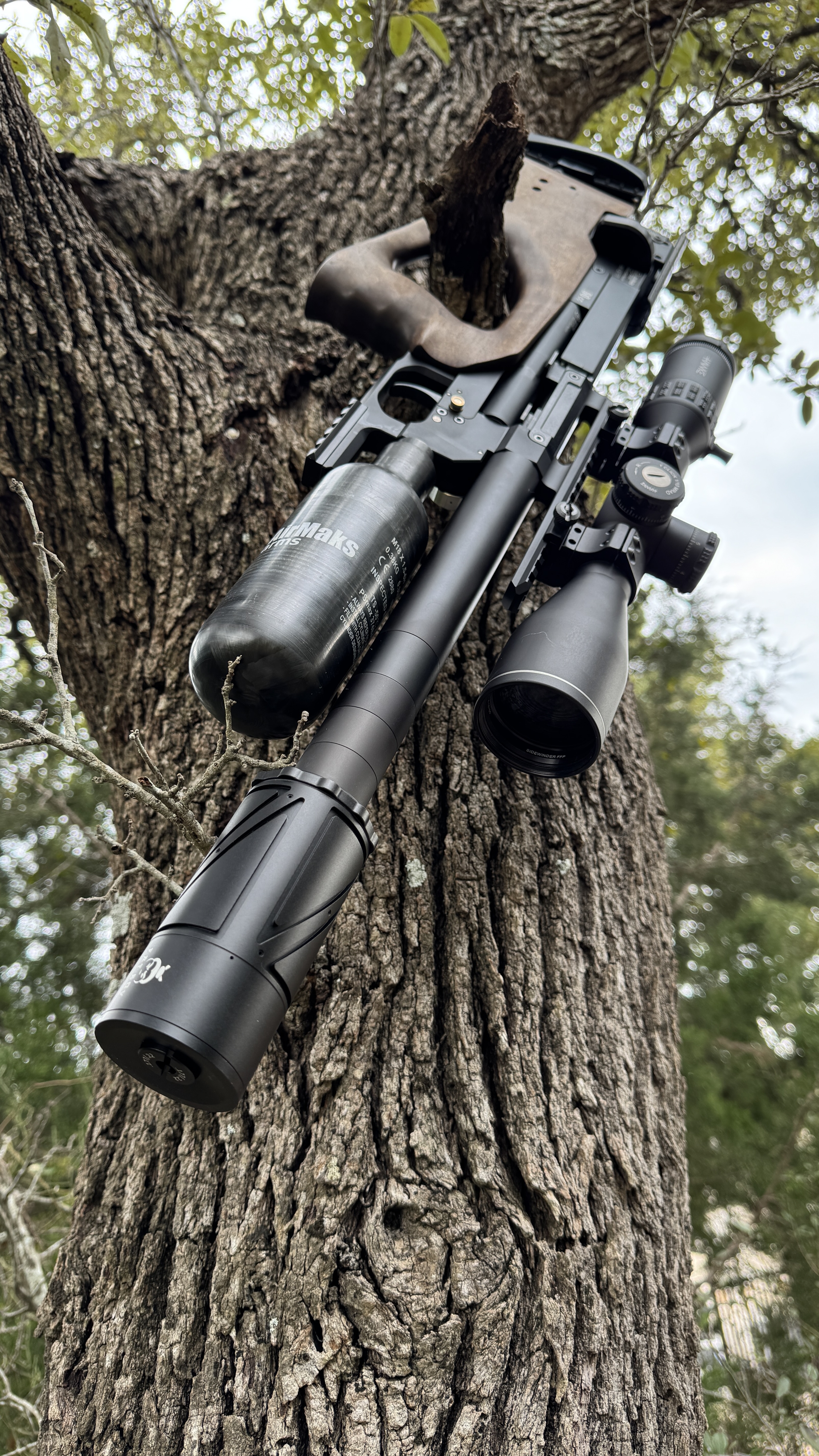

AirMaks Arms "Mr. Stubby"
Michael
Administrator
Staff member
Thats what I've named this one!
AirMaks Arms Krait Lite - https://utahairguns.com/airmaks/
Hawke Sidewinder - https://us.hawkeoptics.com/sidewinder-riflescopes.html#Sidewinder30FFP
Sportsmatch mounts - https://www.sportsmatch-uk.com/
DonnyFL Fat Boy - https://donnyfl.com/collections/ldc/products/2-x-4-25-inches-fatboy-2-0?variant=39995873656875
This Krait is .177 and was just detuned to shoot the 10.3g pellets at 820 FPS. It's silly quiet, and the unique "report" makes me smile & giggle (I'll try to capture some audio for you).
-Michael

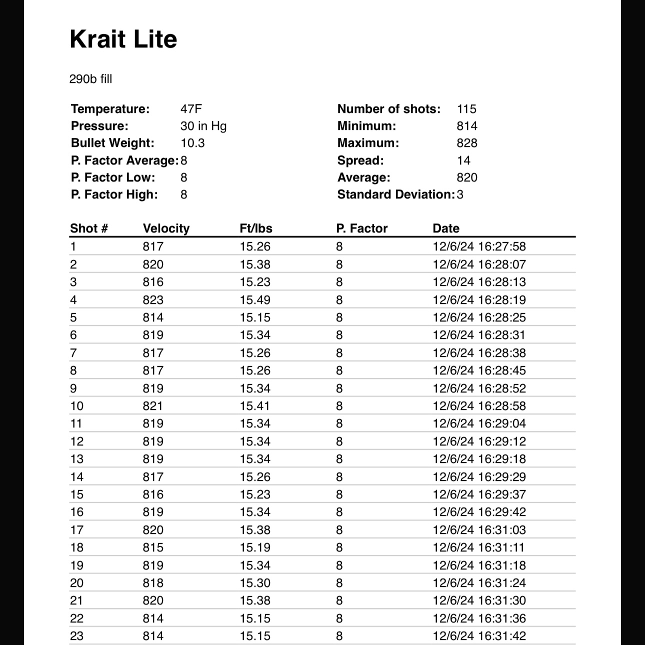

Holy smokes, I just ran it over the ProChrono and I got 115 shots (not including several dry fires I did on empty mags)! It looks like the reg is set at about 80 bar.
At only 29'' (with the buttpad extended & the DFL Fat Boy moderator) I'm really happy with these results. Not to mention the trigger is considerably better than most bullpups.

I had Utah Airguns tune it for me. I'm not a fan of adjusting internal regulators. Looks like mine is set to about 75-80 bar. Maybe someone else that owns a .17 Krait Lite will chime in with their reg is set.
Don't know about the Krait if it is similar to the Katran SC, but I found a lot of efficiency in reducing the size of the transfer port with a sleeve and increasing the preset on the valve return spring (fully tight). Shot count went thru the roof.
I also had to increase the reg on mine as it was clear down at 70 bar from the factory and I increased it to 82 bar.
