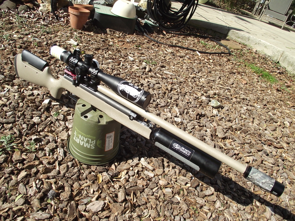

I did one and it increased air capacity and shot count massively w/ a 480cc bottle. One thing to be conscious of is weight, so be careful with overall length. Reg PSI will depend on how large the plenum is and what kind of performance you're looking for. The gauge block should stay in place if you have a hole for the factory gauge for your pressure tube.
I've got two now. One in 22 and one in 30. The 30 gets 42 shot around 70 fpe with 44.75gr pellets and I'm thinking the 22 will get close to a 100 shots with 25.39gr pellets shooting 850-870fps. I'm still working with the 22 that's why I don't have a definite shot count yet. It will lighten your rifle up too. You can either get a short tube with the gauge hole or one without it. Definitely a worthy upgrade.

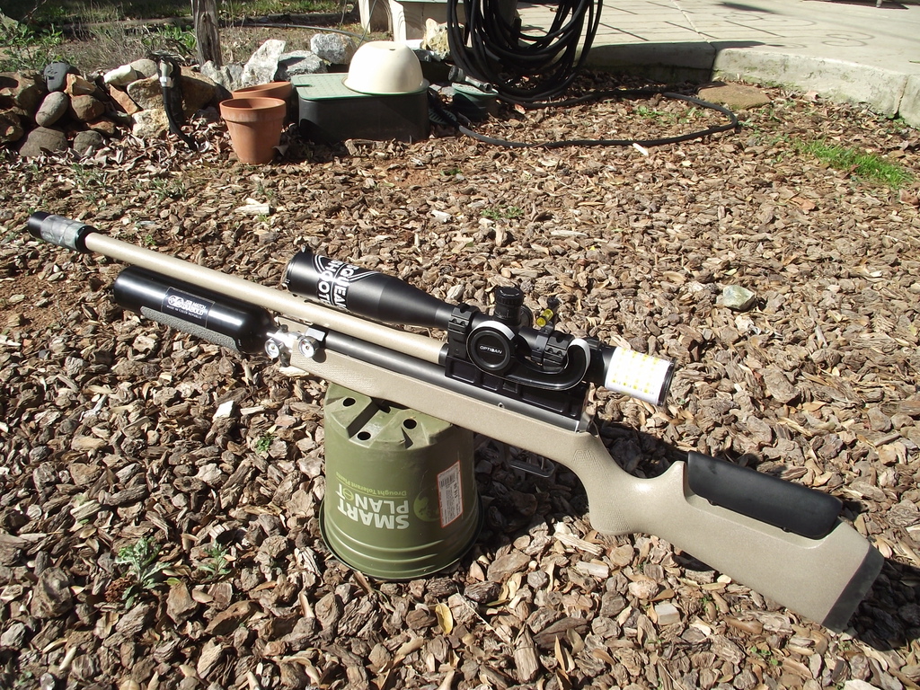

Second one built in the last 5-6 years This one as shown a .25 cal with a hybrid balanced valve and mostly custom everything else ... 58-60 fpe with pellets.
No gauge block ... BIG plenum ... Ninja adjustable @ 2200 psi ... 400cc 3K bottle, tho now wears a 480cc 4.5K CF bottle.
HAVE FUN !!!
Scott S
