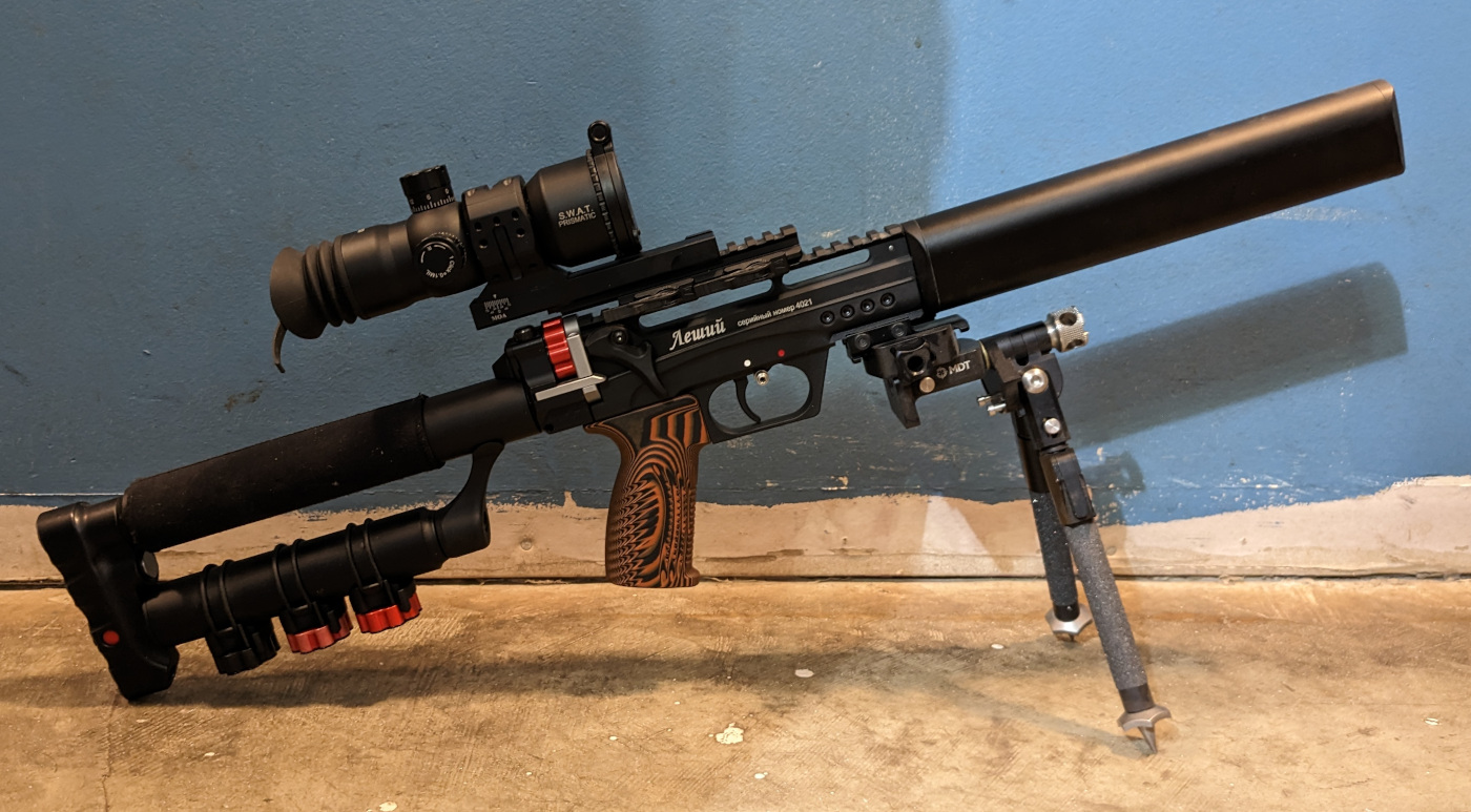

I've got the scope on a Leshiy 2 long and it's about an inch farther forward than I'd like optimally so I may get an offset pic rail extender to try under it. The magazine on the L2 needs height on the mount to clear that the stock mount won't allow.

For anyone looking for an offset riser to mount a prismatic scope to the L2, this one worked out well for me. It clears the magazine and brings the scope back to where it needs to be.
Lion Gears makes a variety and sells them on Amazon as well. They seem reasonably-good.

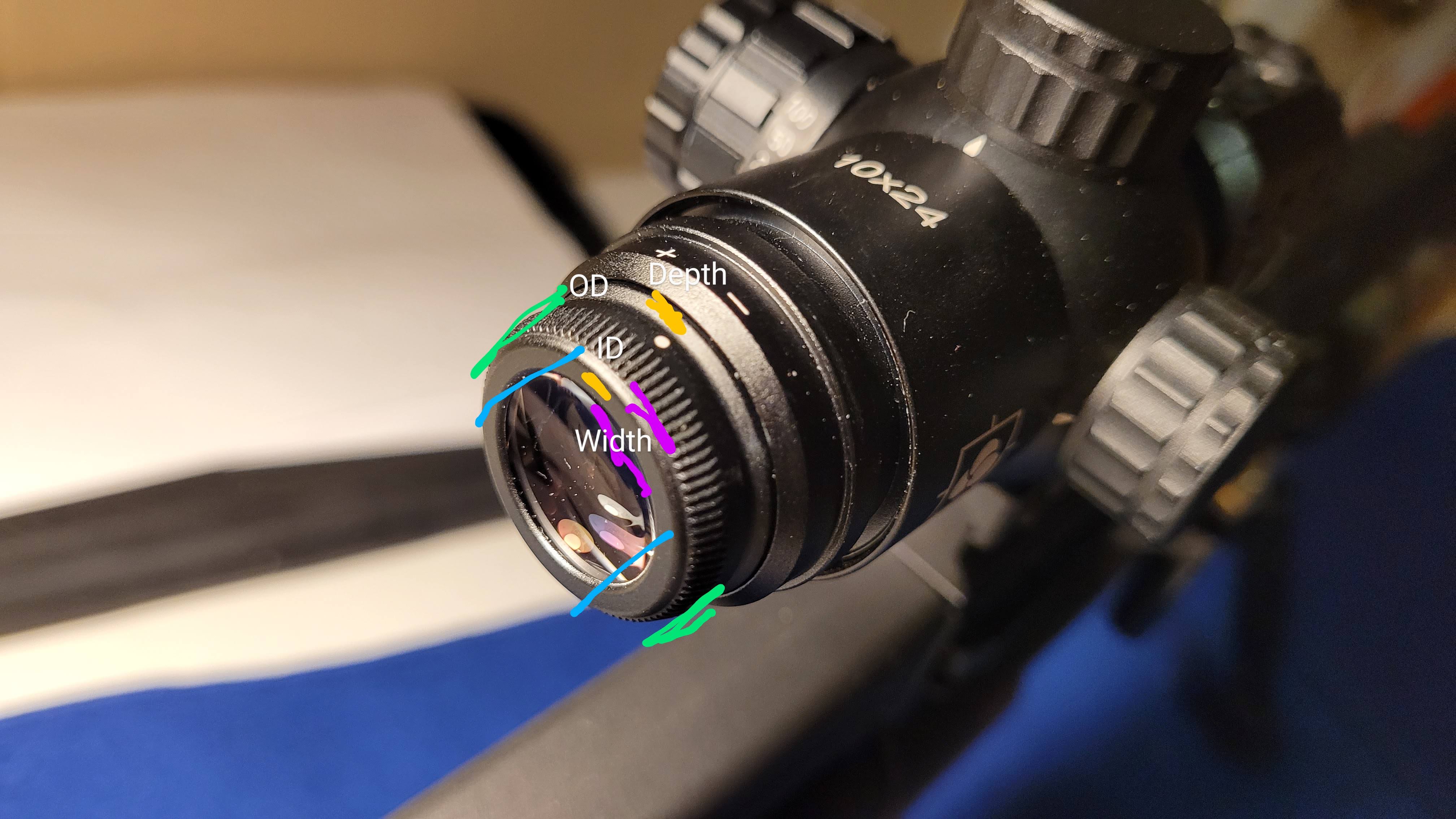

I have a few Immersive Optics prismatic scopes and I wear glasses. My only issue is worrying about scratching my eyeglass lens when it's pressed up against the ocular lens and the ring that holds it.
My daughter's boyfriend was able to print some rings that fit around the eye piece from TPM plastic which is kind of rubbery and flexible.
This is what I was trying to avoid hitting my glasses and some of measurements I gave him:
They ended up fitting reasonably well. I'm sure I'll lose a few but he printed a bunch of variations for me.

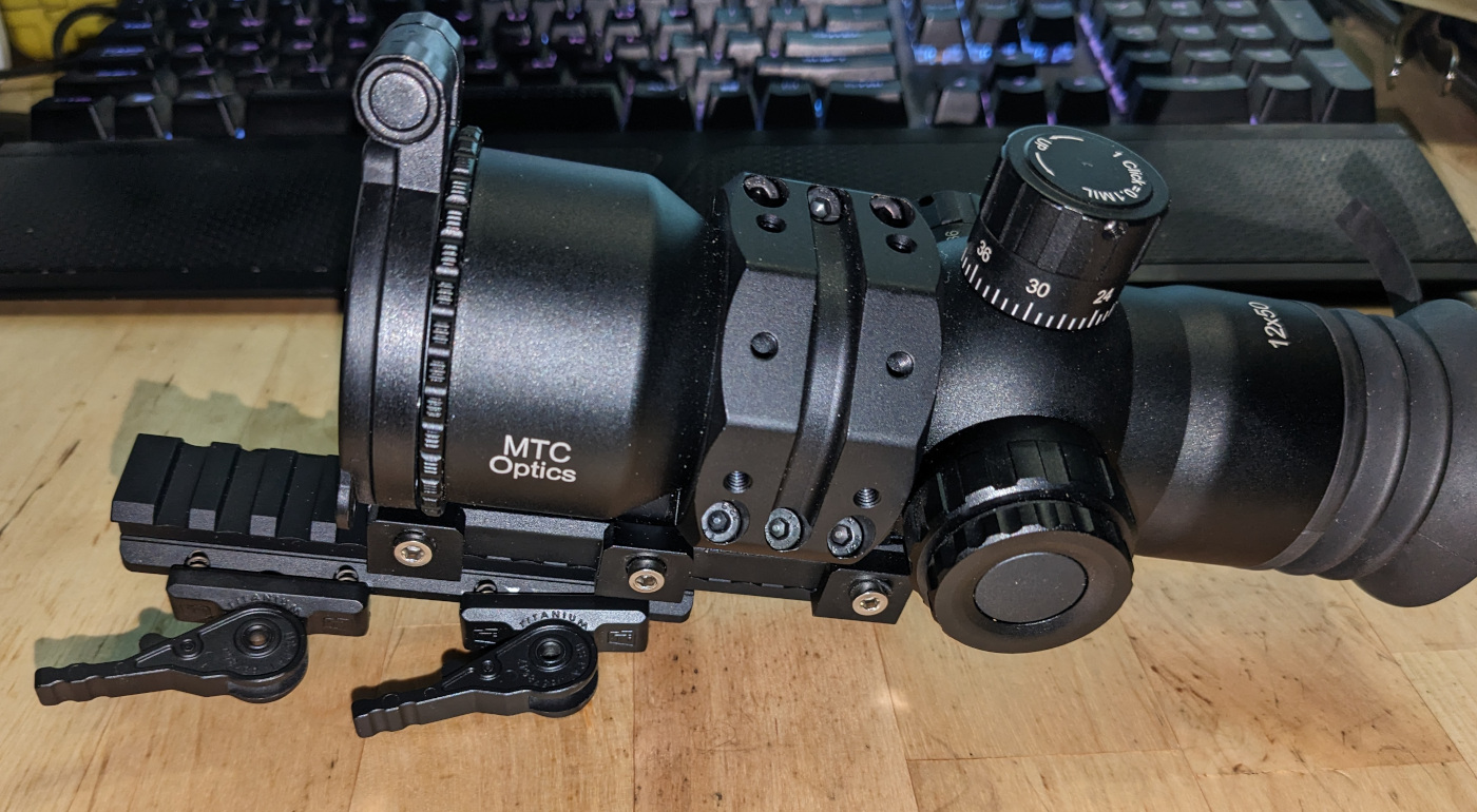

Trimmed a bit off the ADM mount, now I can get the scope as far back as I like.
I wanted a reliable quick-release mount for the SWAT since when the scope is mounted properly, the Leshiy isn't very compact when folded. I didn't want mounts that took forever or were unreliable. The ADM mounts solve those issues.
You can see the little bit I trimmed off the mount, about a 1mm notch right above where the magazine sits. It only really need about a 0.4mm notch, but this gives it plenty of clearance.

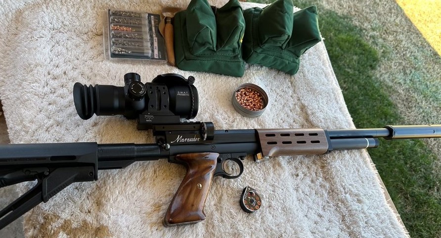

I just got the 12X50 MTC S.W.A.T. and trying it on my P-Rod. Takes some getting used to put one's eye so closed to the lens, but it does open up a wide world of view. With parallax focused at closer ranges (<20 yds) the edge of the glass is not always crisp. I doesn't affect the center of the lens and crosshairs though. I just took out a Starling, high in a tree at 50 yds offhand, and the glass was crystal clear all the way to the edges, so I deduced the 12 power lens is best at >25 yards. I'm guessing the 10 power model would be preferable for shoot under 25 yds mostly. Also, at the under 20 yd distances I have to readjust parallax to get a finely focused target. I wasn't sure if I was going to use the rubber eye accordion, but I found I like it because I can adjust/rotate it to rest against the upper side of my nose to create a consistent eye relief point and a comfortable one at that. I is much lighter than the other scopes I have use on the P-Rod so I like that aspect very much. I was impressed with how the scope got my crosshairs on the that 50 yard starling shot and somewhat surprised that I nailed him. The "Whack" was very loud and solid sounding.
