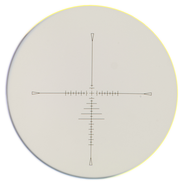

So, I have the MTC Viper Pro Tactical 3-18x50mm.
I usually use fixed magnification scopes.
One thing I do not understand is how to use the SCB2 Reticle. Specifically, as the scope is zoomed, each graduation means something different.
Is this correct at 3x or 18x?
<img src="
" />//www.w3.org/2000/svg%22%20viewBox=%220%200%20210%20140%22%3E%3C/svg%3E
Found this on AOA’s site. Description there and elsewhere say the turrets are .25 MOA per click.
This scope is a Second Focal Plane. You can't use the reticle reference mark at any zoom unless it is at the calibrated magnification. If the reticle is calibrated at 10x for a mil the adjustment or reference mark should be true. When you zoom in or out that measurement is not the same/untrue. That is where the First Focal Plane comes in it doesn't matter what magnification. At any magnification, the measurement adjusts to the zoom...
Does this make sense? I just started my weekend and I'm tipsy.

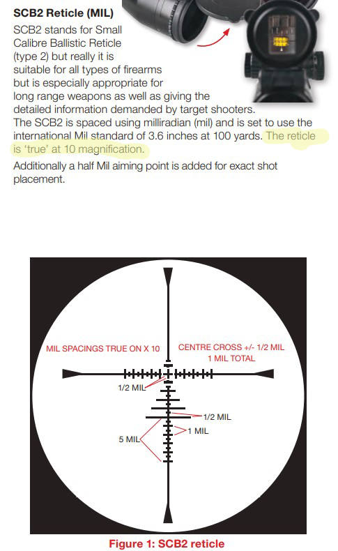

bd2021 - "One thing I do not understand is how to use the SCB2 Reticle. Specifically, as the scope is zoomed, each graduation means something different."
Boy you said a mouthfull. Why in the world would they use a mil reticle and MOA turrets - and then say it was designed by shooters. HA!
Here is what I found from the manual on the Krale website re what magnification the SCB2 reticle is set for:
And it is a SFP scope.
Reactions: CyberDyneSystems
Yep, seems silly to pair...unless *maybe* they had the true at 10x and it were a 3x-10x scope. Then I wouldn't have to think, and try to figure out if I am *really* on 10x.
