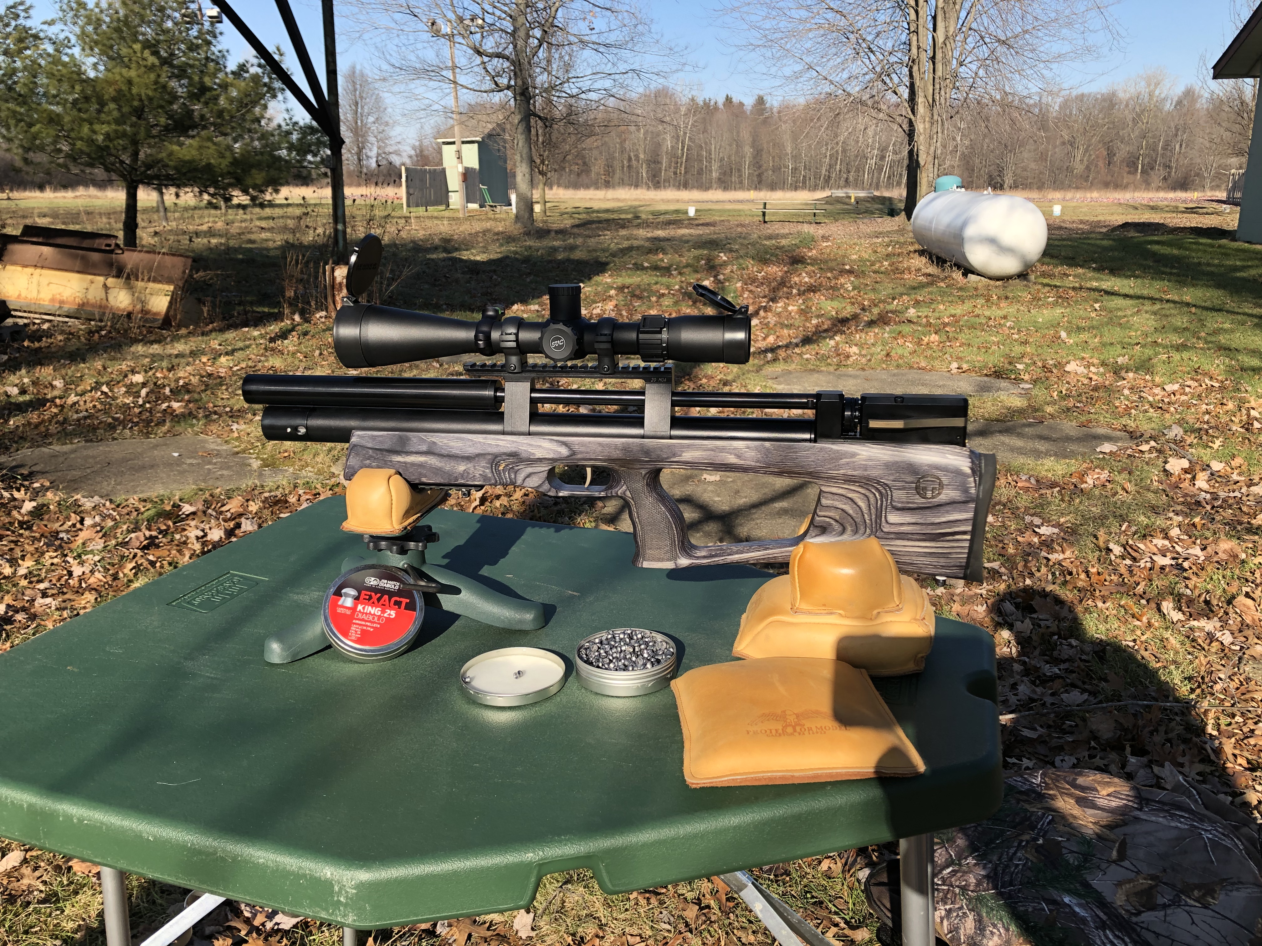

Taipan Veteran Standard .177​

Taipan Veteran Standard .177 with gray laminate stock.
DonnyFL moderator adapter and hammer spring adjuster
Anschutz Rail (never used)
Hawke Vantage 3-9x50 Mil Dot
FX No-Limit Scope Mounts
Carbon Fiber Moderator (can't remember where I got it?)
This gun is spot on at 50yds!
$1,000 shipped (no trades) (US only) Paypal FF - [email protected]
Reactions: maxtrouble

The Taipan Veteran in .177 would be a beast. High shot count, deadly accurate and built like a tank. I have a .25 Veteran that holds air forever, trouble free and is very accurate. I highly recommend one.
That looks like a sweet setup and range there...man I miss country living and my powder burner range!
