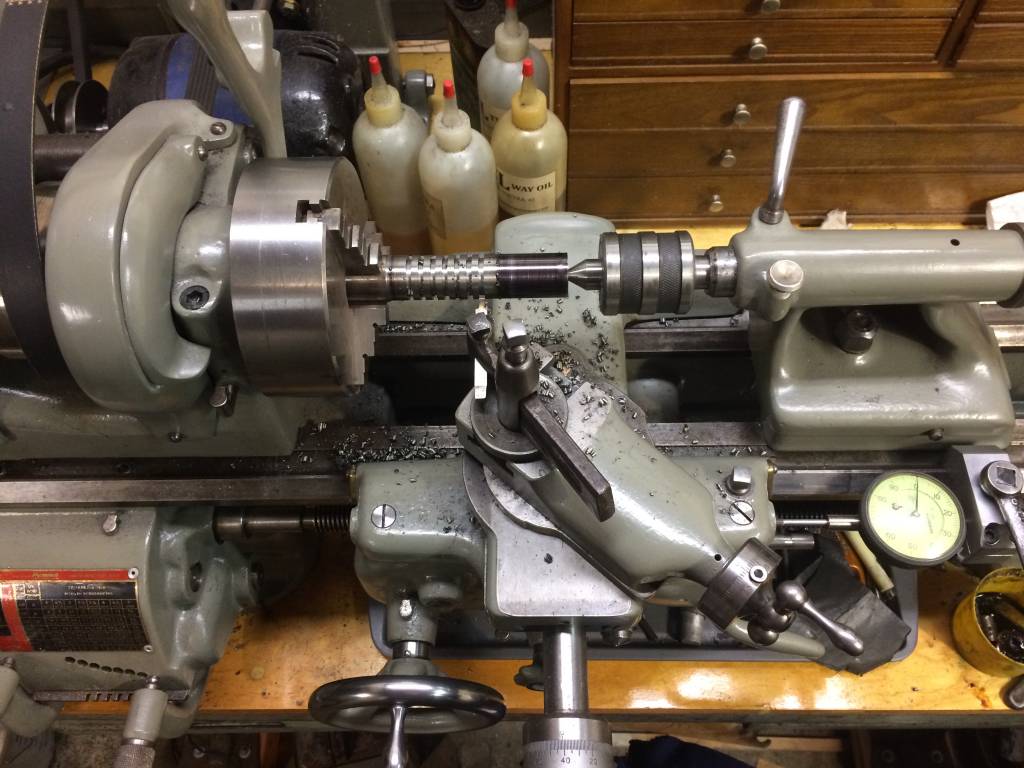

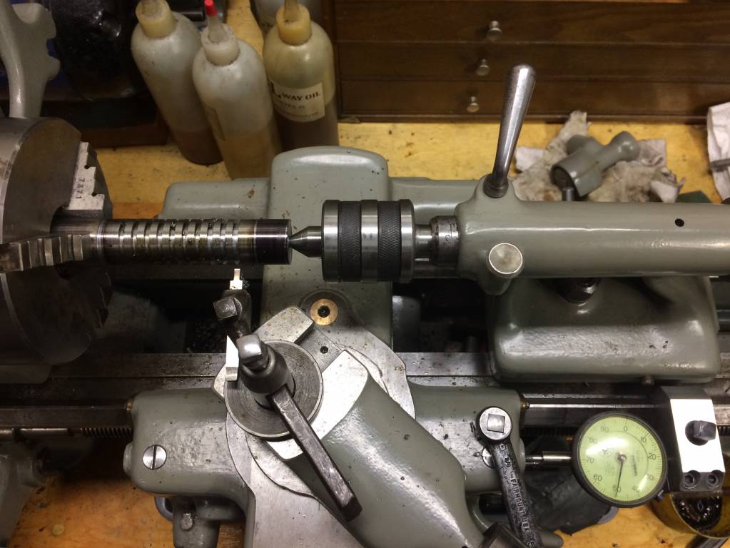

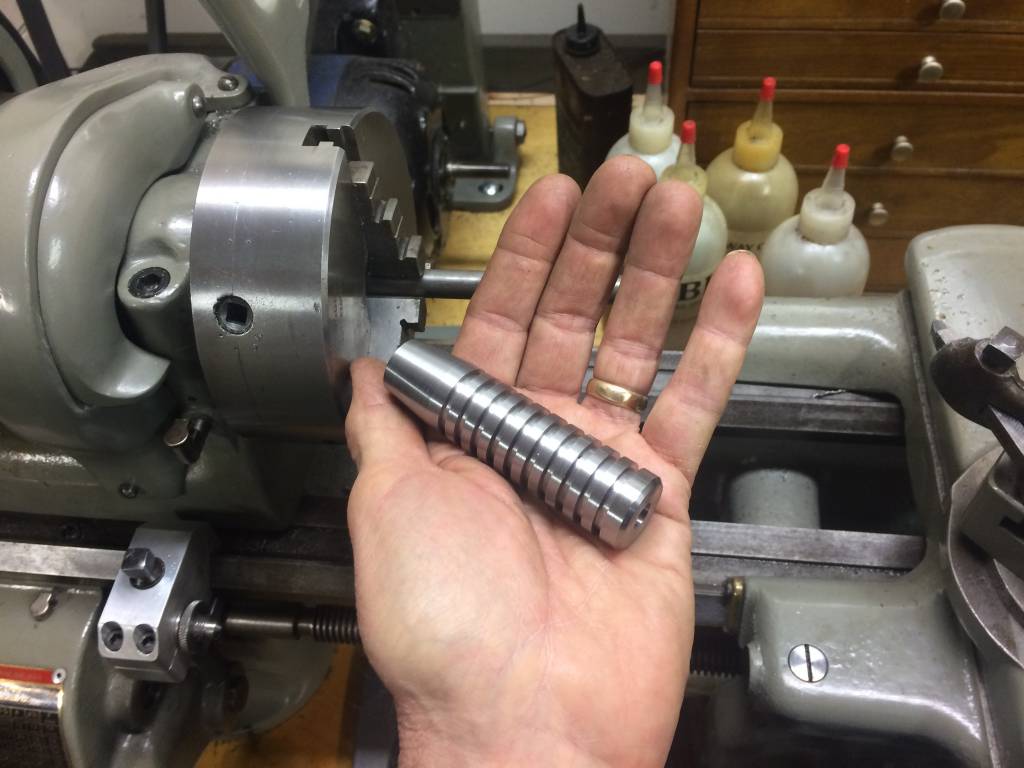

Trued up the scrap steel bar and cut 10 grooves .114 wide (wider than a parting blade)with a profile bit I ground. This is a good exercise for folks learning to part on the lathe. You need the right profile bit, slowish spindle speed, proper feed rate, and apply cutting oil continually as the cut progresses with an acid brush. Just enough to provide lubrication to the cut. Makes a big difference and you can even hear/feel the difference. Too slow of a feed rate will cause chatter. don't be afraid to try increasing feed a little. Once you get the feel for parting you want to do it with power cross feed. Works even better. Maintains the proper feed rate which is 75% of it.

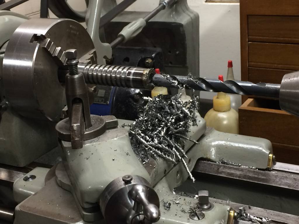

Next the center had to be drilled out. And bored to finished dimension. I'll show the boring bar later

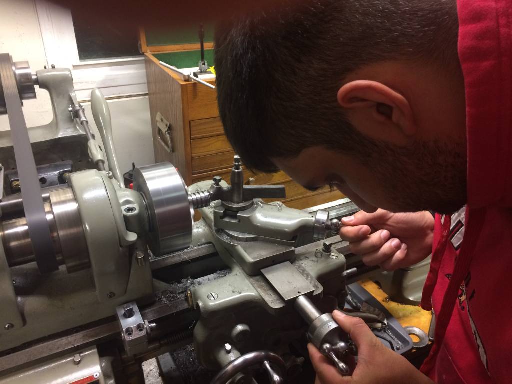

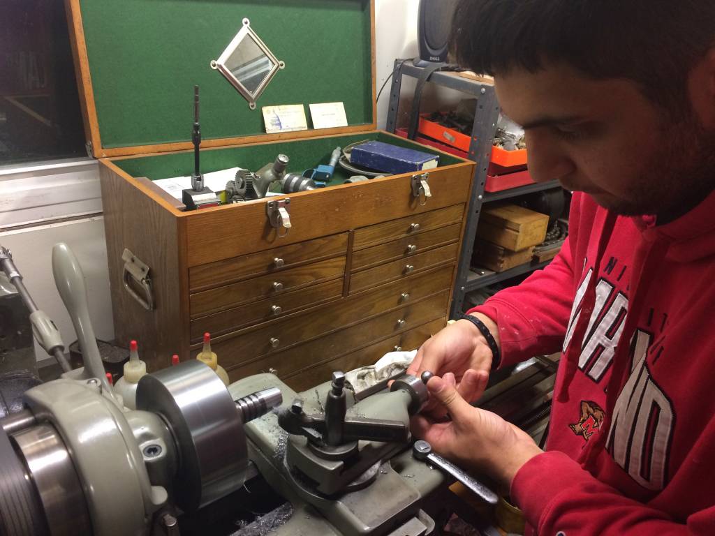

Here 20 yr old Tristan is cutting the tapered end with the compound slide set over about 7 degrees. Feeding by hand he is getting a very good finish. He's so big he makes my 9 inch South Bend lathe look smaller.

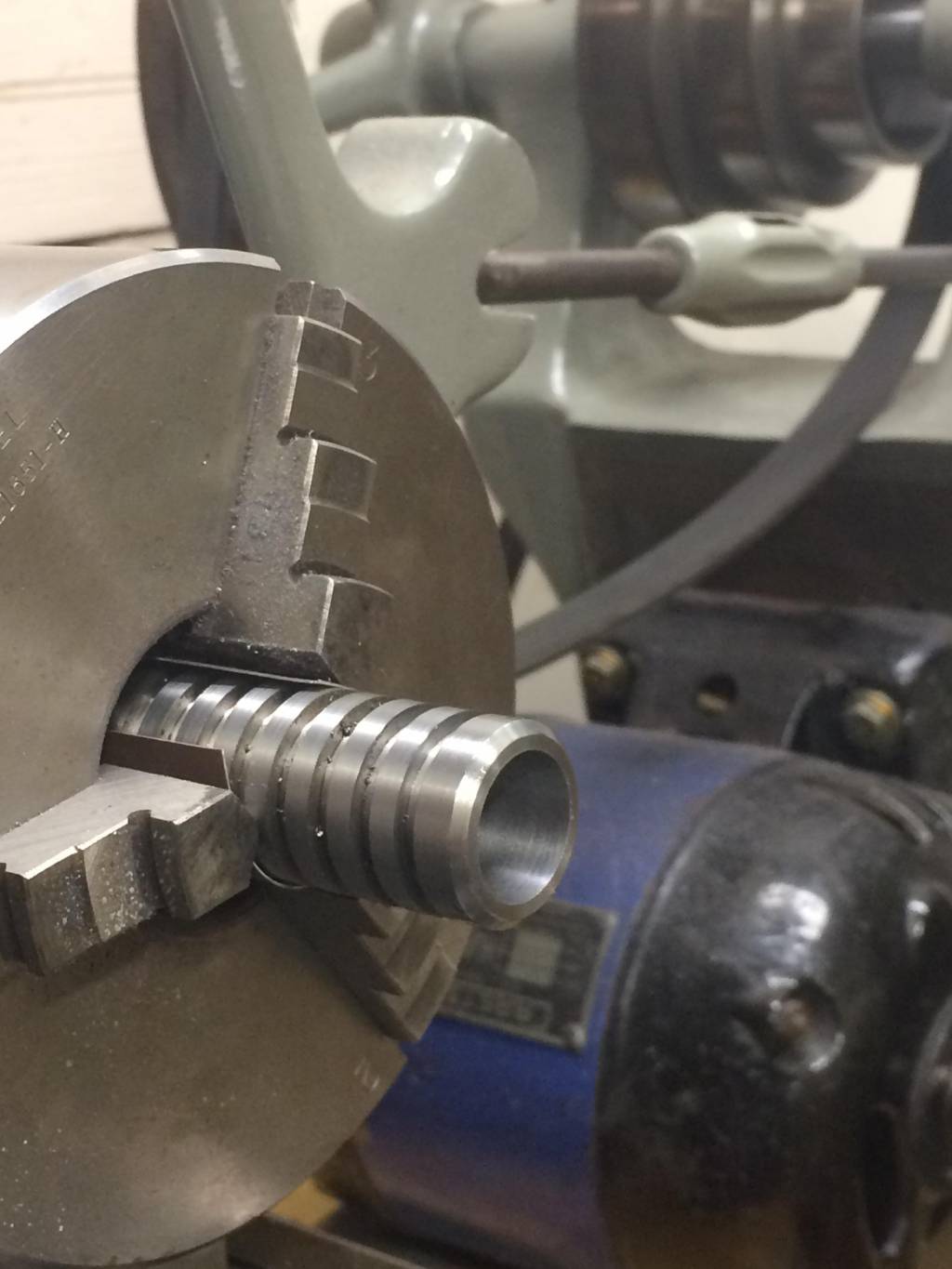

Now he is cutting the large 45 degree chamfer on the other end.

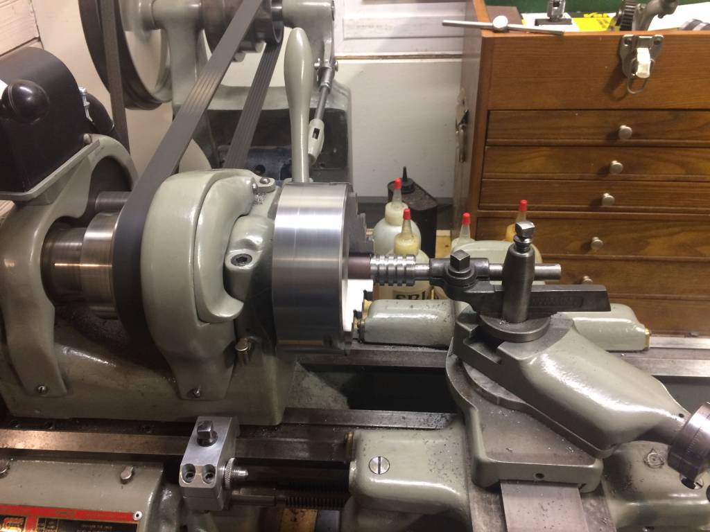

Had to bore it out from both ends. Too deep for me to do with the bar extended so far. Getting excessive chatter. Just bored about 1 3/4" and flipped it in the 3 jaw. Then bored the other end. Close enough for this job. Not perfectly concentric. Going to use two aluminum sleeves and two set screws on this one. Certainly don't want the set screws going directly into the barrel. Got a nice finish and avoided any chatter by running the spindle in back gear and slow feed for the finish cuts. Avoid chatter by slowing it down. Especially when using form bits or large radius bits. 👍
After boring I made an interference fit plug with a 5/16" hole to plug the crown end. Then faced it off. Has to be drilled and tapped for set screws and then painted. Already made one of the aluminum sleeves. Have to make one more. Ape hands 😐
