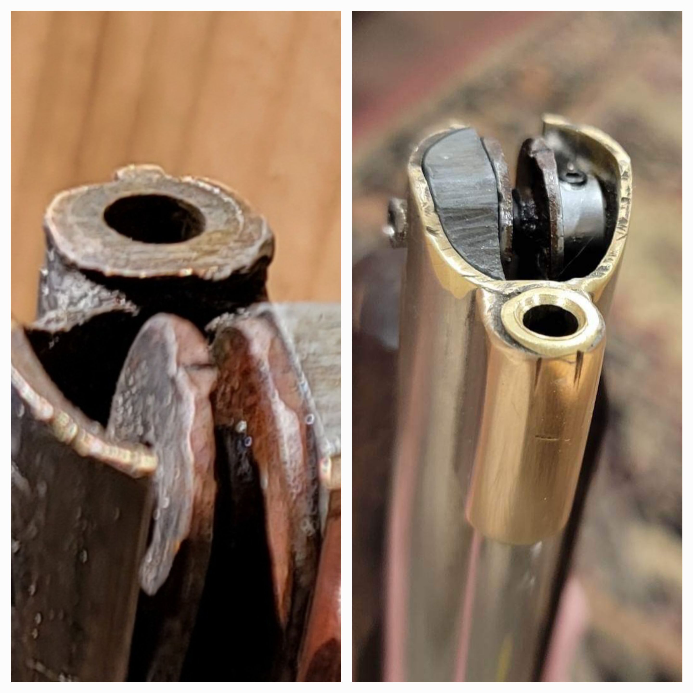

I have used cone shaped die grinder stones for cutting and rough polish on crowns or the little Dremel ones for small caliber. Slow and steady let the bore tell you what it wants and most time it's turning it in fingers keeping it square.There are threads online about coning muzzles on muzzleloaders so there is no need to use a short starter to load the patched ball and the effect on accuracy for those that wish to look into such things. Some say there is no effect or little and some that it ruins accuracy! There are a lot more variables involved with those than airguns though.
