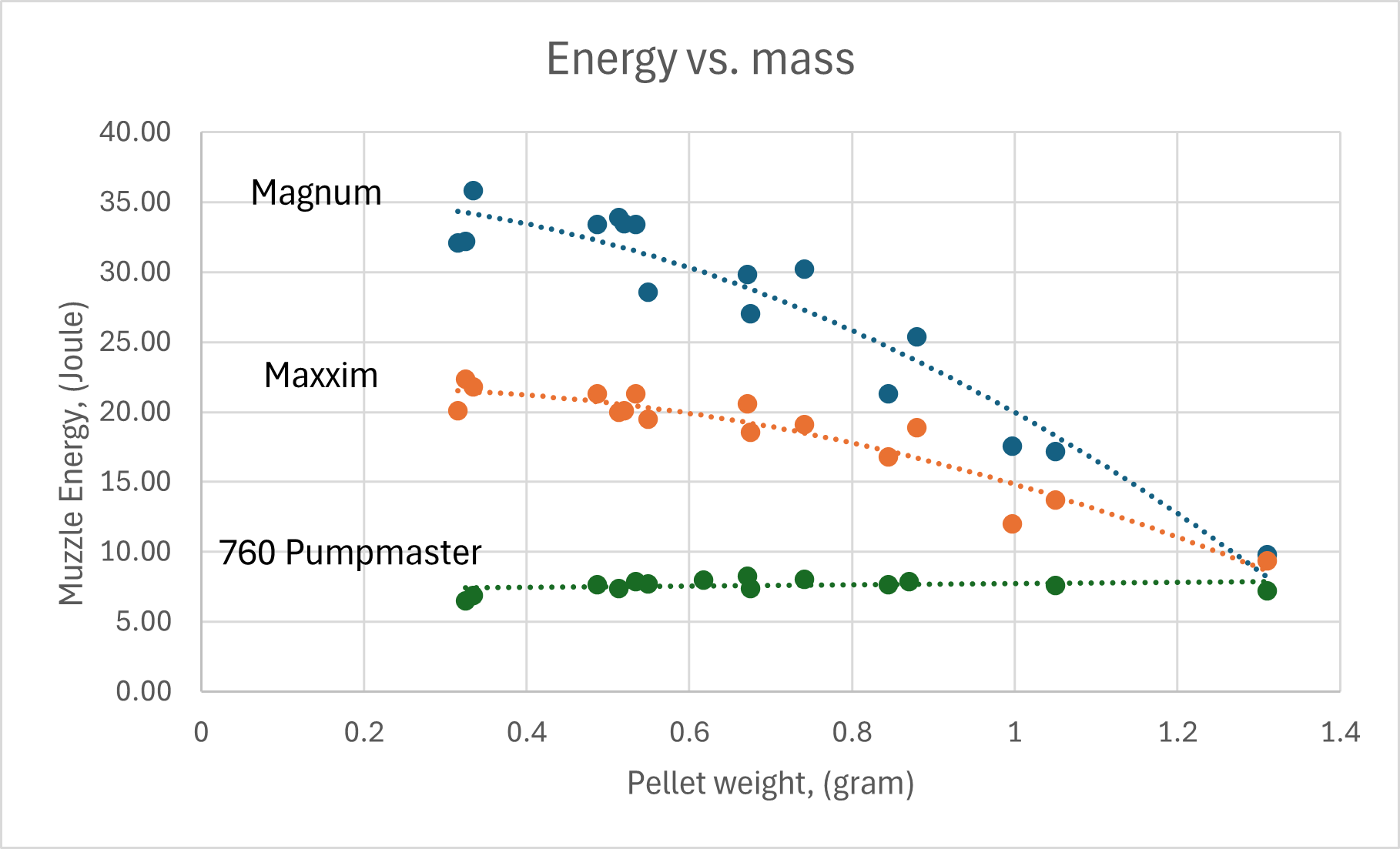

I want to show my energy measurement results on 3 rifles with 16 different types of pellets (all 0.177 caliber)

I shoot 16 different types of pellets with weight span from 0.325 gram to 1.31 gram, 5 shots each. Pellet weight was checked on analytical balances. An average weight distribution was within 1% accuracy.
Pellet velocity was measured with CHRONY Beta 2 inch from muzzle. Average velocity distribution was also close to 1%
BUT, velocity variation with pellet weight puzzles me!
Below are my data in graphical form
As you can see velocity drops with increase of the mass of the pellet - this is expected. What is unexpected is that it drops at significantly defferent rate for different guns, and for extra heavy 1.3 g pellets velocities fro all 3 guns are virtually the same!!!. Old 760 Pumpmaster with 10 pumps shoot 1.3 g pellet with the same speed as brand new the most powerful break barel rifle (Gamo Magnum).
Energy graph also show that that old Pumpmaster shows same stable muzzle energy independent on the used pellet, while muzzle energy of both Gsmo Swarm Magnum and Gamo Swarm Maxxim drops with increase of the pellet weight from 35 Joules (for Magnum) and 22 J (for Maxxim) down to the level of this old Pumpmaster with just 7 Joule.

The energy decline with increasing pellet weight you are seeing from the two Gamo rifles is a behavior common to springer (or gas ram) power plants. It is related to the smallish volume of high pressure air available to accelerate the pellet.
Pneumatic rifles will generally produce increasing energy with ever heavier pellets, provided the valve is knocked open hard enough to provide an adequate volume of air to accelerate the projectile.

A piston gun use the inertia of the piston to hold the compressed air forward momentarily before that piston is forced back (piston bounce) by the compressed air. Ideally, the projectile leaves the barrel before the piston reverses direction significantly, thereby maximizing use of the compressed air. A heavier projectile accelerates slower, taking too much time, allowing the piston to be pushed backward before the projectile can get up to speed, wasting some of the energy from the compressed air.
If you increase the piston mass significantly, the piston gun will do better with heavier projectiles, at the expense of performance with lighter projectiles.
Most factory .177 piston guns are optimized for light to medium pellets.

Here is something else to consider. In a PCP or Pumper (to a certain extent), when the trigger is pulled the air in the plenum is released instantly and the full force of the compressed air pushes the pellet out of the barrel. This normally is a consistent process. In a springer, as the piston moves forward it compresses the air behind the pellet and the pellet begins traveling down the barrel before full compression is reached. The pellet could be pushed forward a few inches as the piston moves forward and thereby reduce the compression of the air. The amount the pellet moves forward would vary by pellet weight. Heavier pellets would not moves as far as lighter ones. This could have an impact along with all the other explanations presented here.
This is true. There's several things to consider. Piston guns have many variables. Typically past a certain pressure point as pellets require more pressure to break free (start pressure) and move forward energy decreases. In part because the piston is rebounded harder on an air cushion. An increase in start pressure is normally associated with increasing pellet weight but pellet fit has a lot to do with it as well. This is why some pellets make more power than others in the same weight class. A looser fitting heavy pellet can make more power than a tight fitting lighter. Its a delicate balance.
Piston guns are very fussy when it comes to efficiency. You'd think opening a transfer port would reduce air restriction and increase power. Sometimes it does, sometimes it doesn't. Typically it doesn't. It increases lost volume which usually reduces peak pressure which usually reduces power. There are so many variables the only way to know what works is to try it.

A Pumpmaster produces the same pressure behind the pellet until the pellet is gone. Heavier pellets just take longer.
A spring piston produces a spike of pressure. The pressure falls off as the pellet starts to move. It can only be tuned well for a specific pellet weight. The goal is to match the pellet weight to the pressure spike. Too light or too heavy of a pellet will reduce efficiency and power transfer. So I can see how a spring piston will not produce equal power across a range of pellet weights.

Yeah, It is sort of pressure distribution between connected vessels with variable outside forces. Does anyone know of any physics literature about it? It should not be too complicated physics (Freshman level probably). The more I go into it the more I want to buy PCP!
The physics of compressible flow is anything but freshman level. It’s probably not unlike flow through rocket nozzles..
