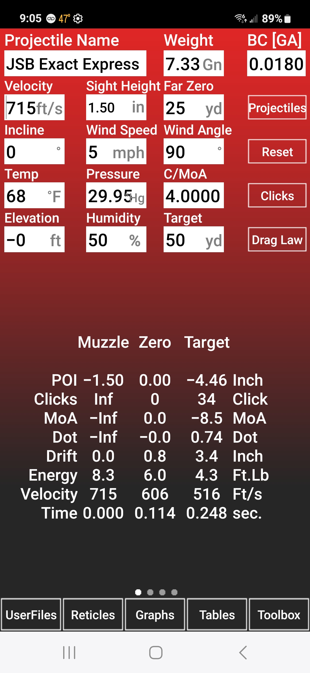

No problem Mike. You know I love you. The R1s disparity is somewhat extreme but not far from common losses when increasing weight and or using tighter fitting pellets. Here's a more typical example. My Hw30s shoot 7.33 at 715 fps (8.32 fpe), JSB 8.44 at 645fps (7.79 fpe) and the very slightly heavier H&N FTT 8.64 at 615 fps (7.25 fpe). The latter never make good power in my 177 Weihrauchs because the tighter fit and lead alloy. The FTT are very accurate but the power penalty is a little too much for my taste.
Let's compare with BC data from personal testing between muzzle and 30 yards.
Red= 7.33 @ 0.018 BC

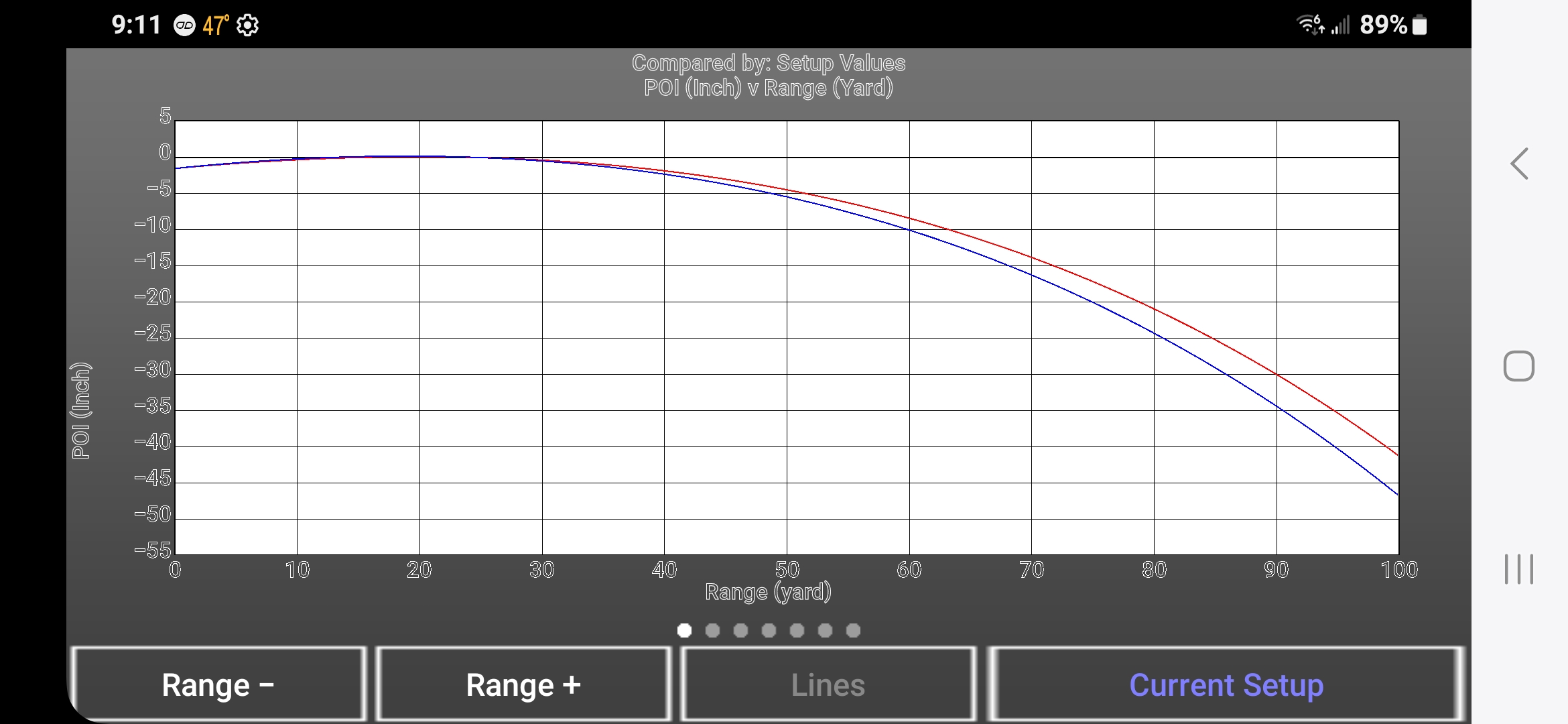

Blue =8.44 @ 0.021 BC

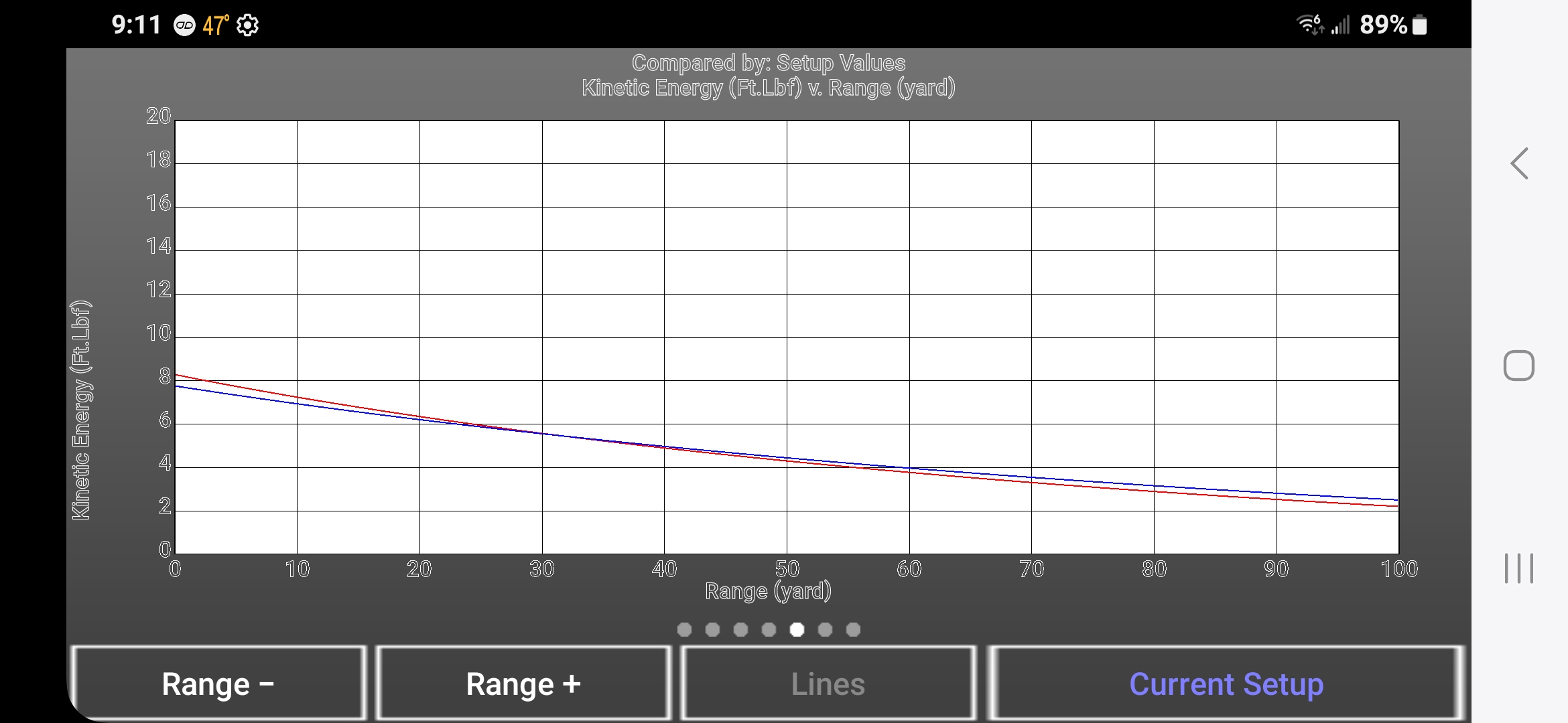

Here you see it takes 30 yards for the 8.44 to catch the up with the energy of the 7.33 and 40 yards before it passes it. Still you'd be correct in your earlier post.
Here you see the POI on 7.33 is always higher.

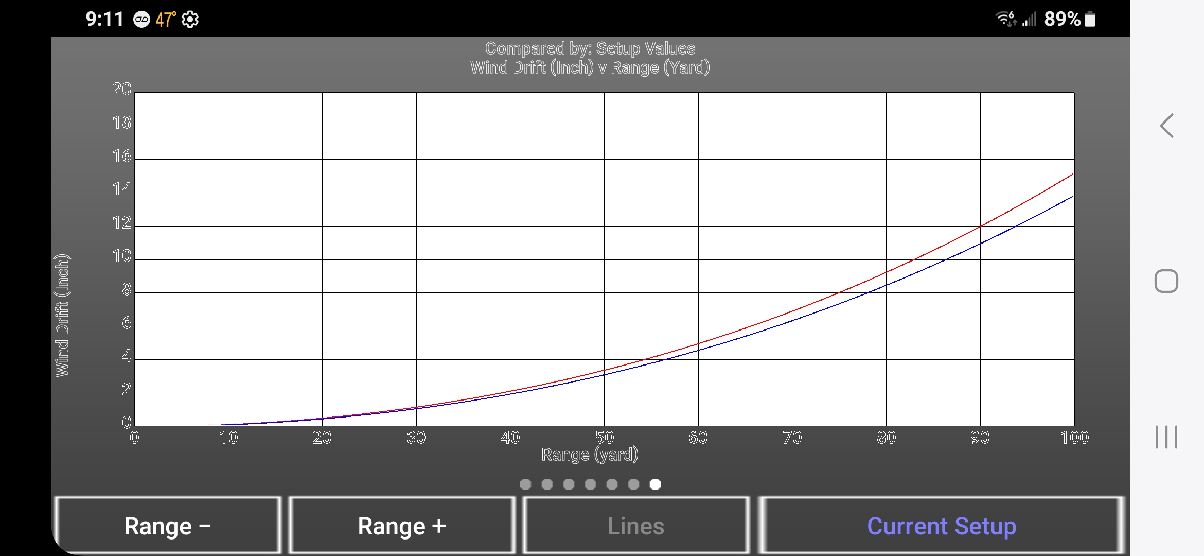

Here you see there's less wind drift with 8.44s.
In this real world example the better BC of the 8.44s doesn't really take affect until 40 yards. Most people shoot these rifles inside of that. I charted it out to 100 yards because I'll plink soda cans at 100 yards. At that distance I'll use the 8.44s if there's any wind.

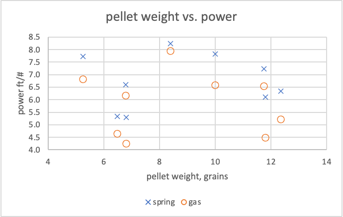

And since everyone is showing data, here are results from a Hatsan Mod25 with either a .177 or .22 barrel, driven by either a metal or gas spring, one gun, four configurations. The pellets were non-lead alloy, so the .177s are under 7 grain and .22s are over. My apologies for the non-SI units.
In this particular case the gas ram wasn't as powerful, but note say the 11.7-11.8 pellets, how one showed ~10% more power with the metal spring but the other ~33% more. I note that the ones where the power was relatively high for weight, and the closest between springs, have the softest skirts (Predator GTOs, Winchester MVP). I don't know why the gas ram prefers a particularly soft skirted pellet (if one could even call an alloy pellet "soft").

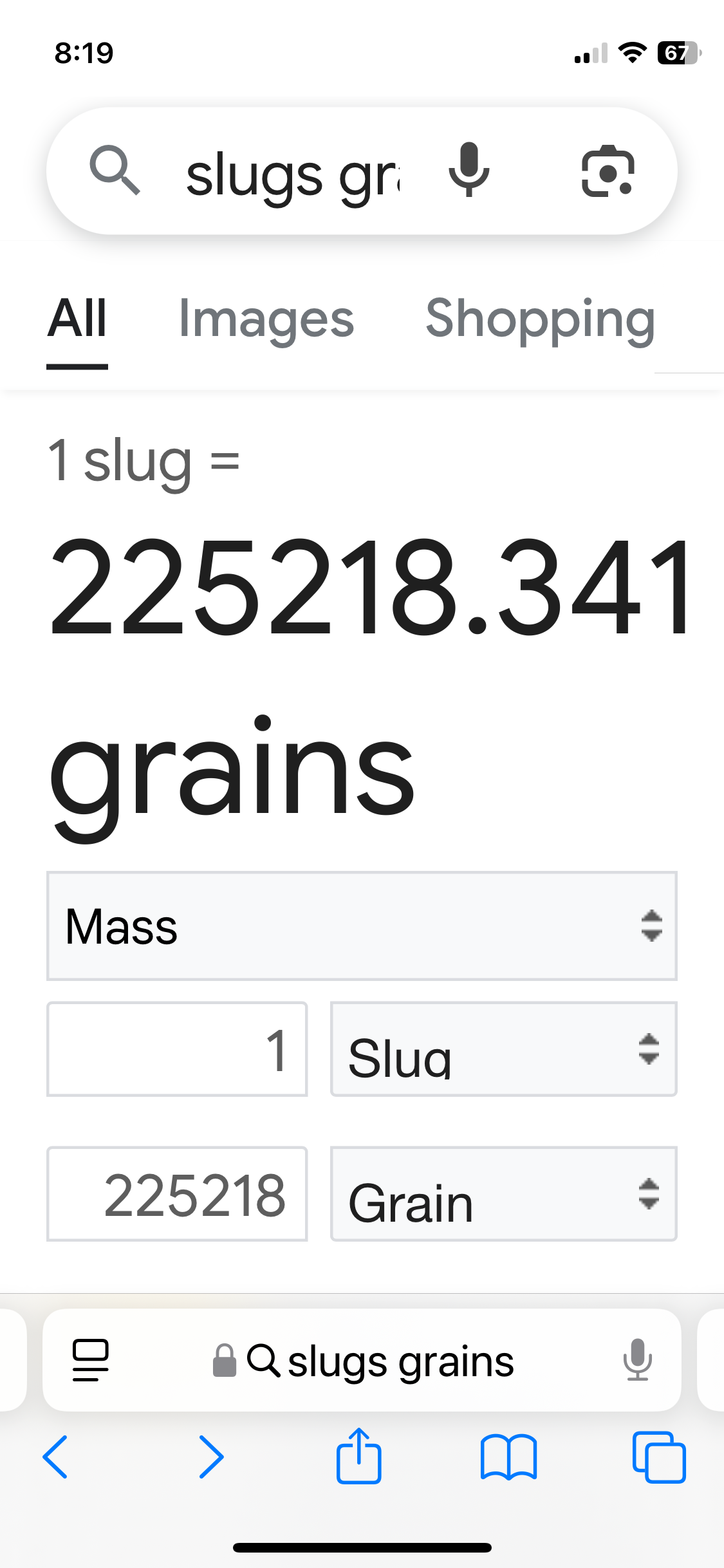

I don’t need the acceleration of gravity to calculate kinetic energy. The kinetic energy equation is:
KE = 1/2 * m * v^2
Gravity is not part of the equation. If v is in feet/sec, than m would be in slugs mass. Convert grains to slugs:
https://www.unitconverters.net/weight-and-mass/grain-to-slug.htm
and then plug it into the KE equation.
