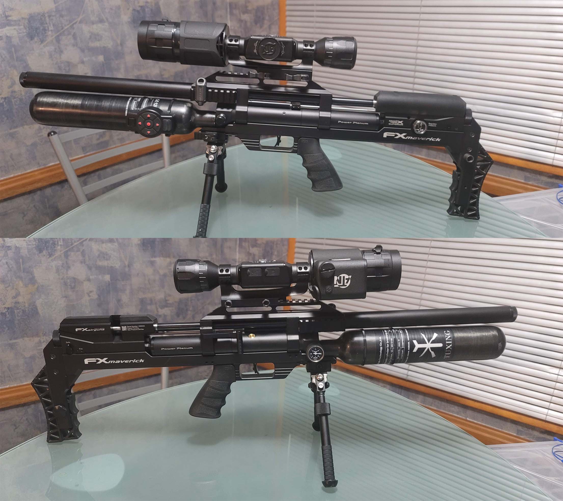

I swapped my Aluminum tank out when funds were available. I once 3D printed a top piece for a friend's Wildcat, so there is probably a design for the Maverick floating around on the wen somewhere.

I purchased this 580cc 300bar tank off of Amazon for $160. I then bought the valve for the tank directly from FX USA for around $50, as I wanted to use the old steel tank as a possible spare while hunting.
It's hard to say how much everything weighs, as my scope weighs a ton (over 3 pounds)! I also run with a DonnyFL Ronin on the front all of the time. Adding the carbon fiber tank was noticeably lighter, but not a massive difference in the grand scheme of things.
Everything about the airgun is the same as the Maverick Sniper, except the shorter barrel and steel tank. I wanted a shorter barrel in the first place so it would be more comfortable while walking through the woods. I did do a modification to my airgun and I added a MagPul connector to the rear for a sling, and I used the front pic rail for a MagPul adapter.
I also just use a $250 Yong Heng 4500psi compressor. If you are in a pinch for cash, I think this is a reasonable downgrade. I use it to fill up my 4500psi SCBA tanks as well as filling my airgun directly.
