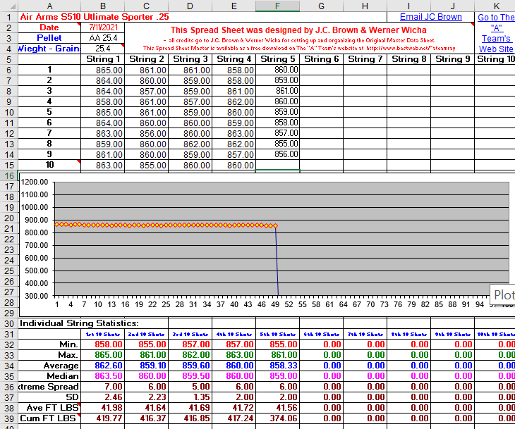

Stock, the S510 was shooting the 25.4's at 860. Here is a sample shot string. I was getting ~49 shots with the factory tune.
Like I said, extremely consistent tune, but too weak for what I'm after.

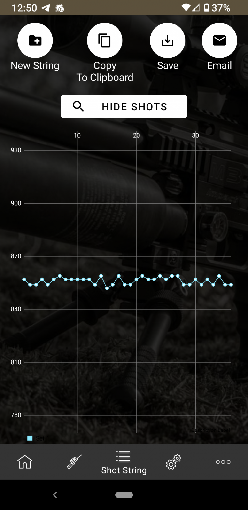

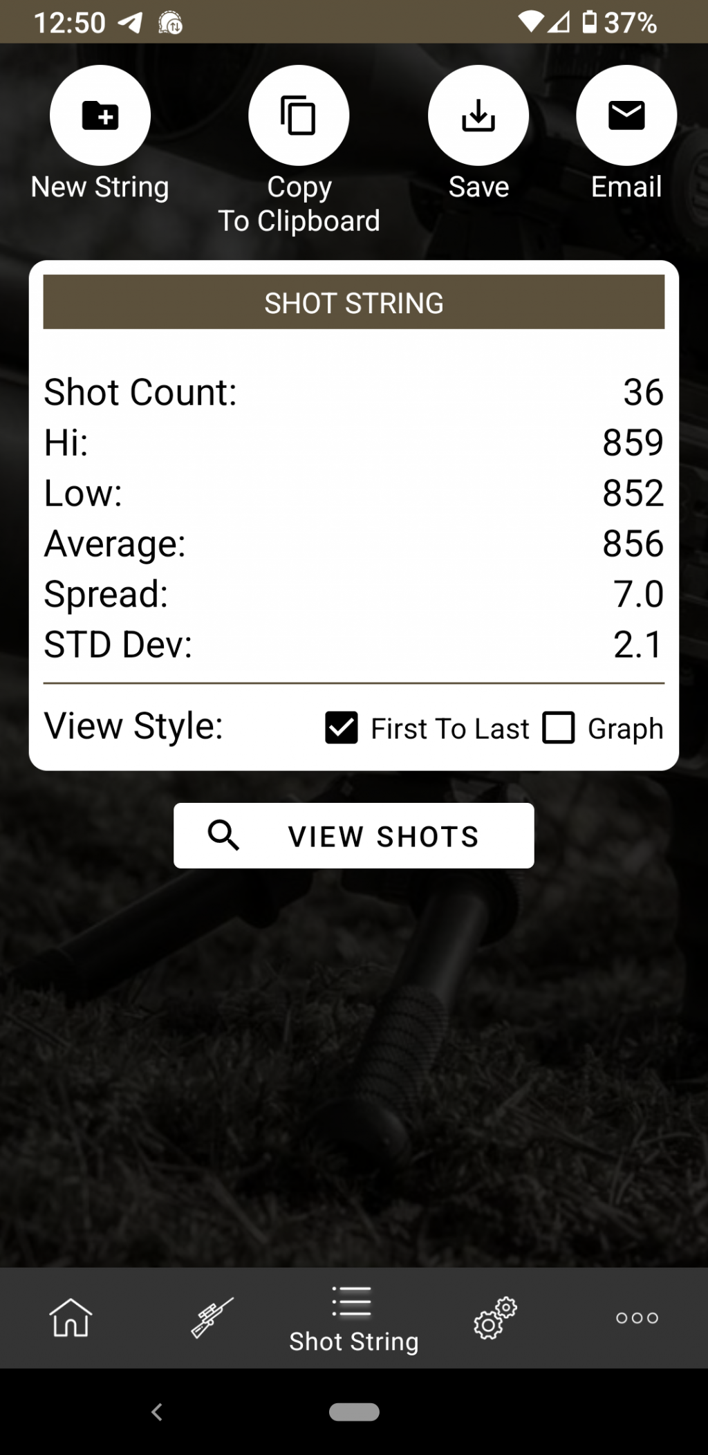

After fiddling with the reg, I ended with a pressure of 152 BAR. This results in 36 shots at 856 with Barracudas and 825 with JSB heavies or 50.5 and 52.5 FPE respectively. I can get 4 additional shots after falling off the reg before velocity falls below 840 with the H&N's. The barracudas shoot significantly better in my barrel, so I will be running those. Here is a shot string:
Very happy with this tune. It is VERY consistent, with a .25% SD and .875% ES. Most importantly, the shot cycle is sublime with only slightly more muzzle flip than the stock setting. Accuracy is A-OK as well. These are groups shot with HN barracudas - both sub MOA.

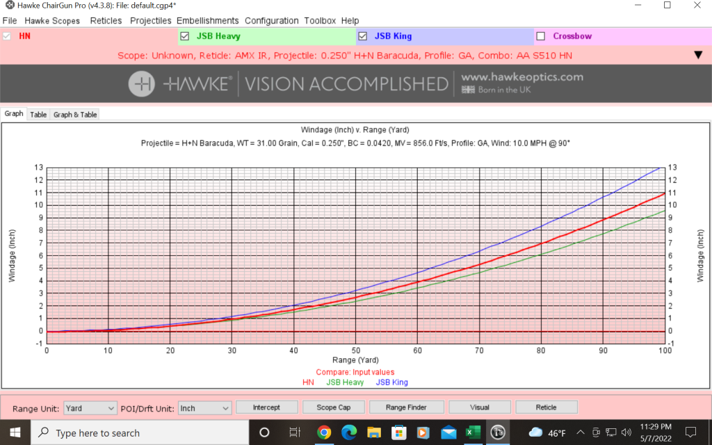

44 FPE with JSB heavies prior to the tune, and 52.5 after equates to a 20% increase in muzzle energy. 49 shots to 36 shots equates to a 24% decrease in shot count. That seems like a pretty good "efficiency" trade off. Needless to say, the ballistics in the wind are much improved shooting these heavier pellets at this higher velocity. JSB getting a full 33% (ish) less wind drift than the stock tune running 25'4s, and the HN's are getting approximately 25% less wind drift at 100 yards. Wind profile is 10mph and 90 degrees.
