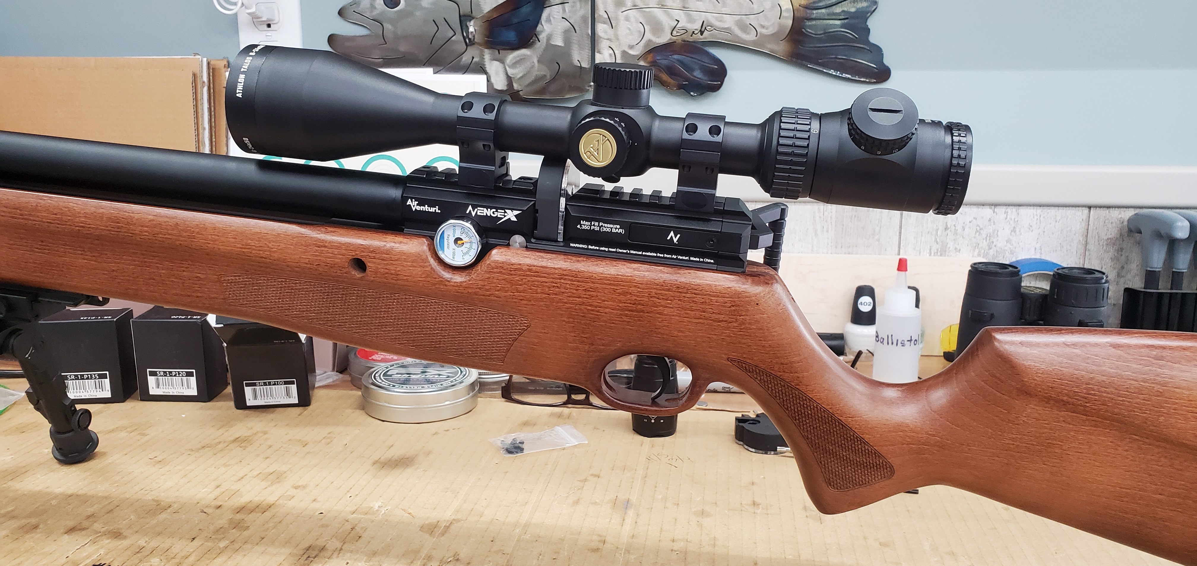

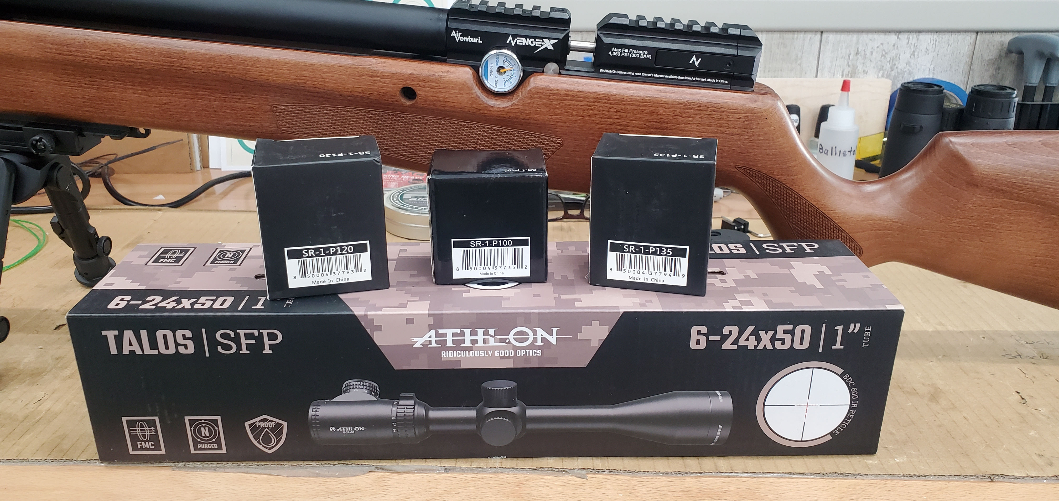

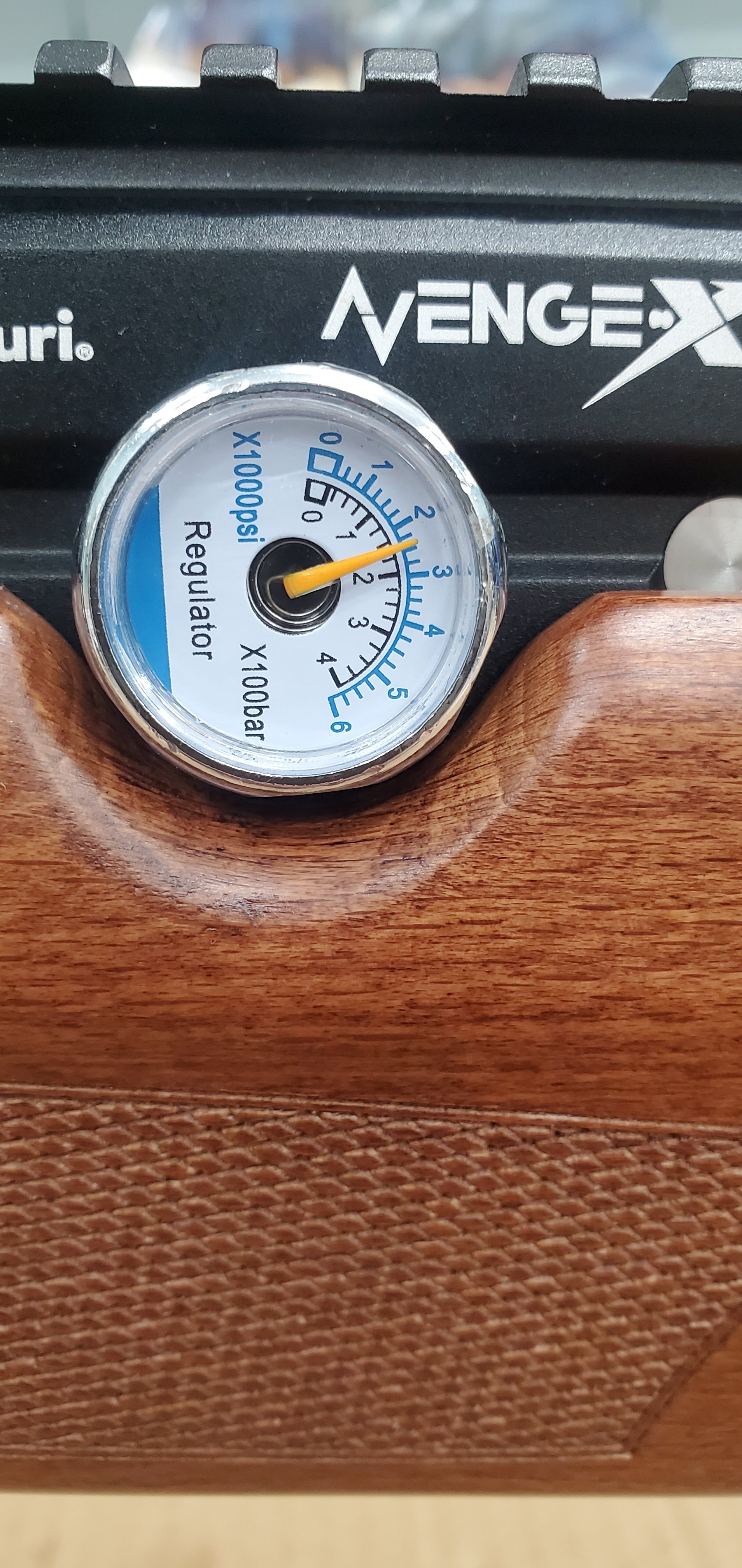

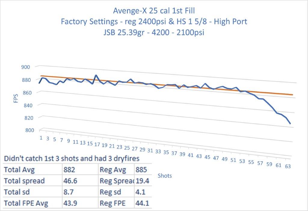

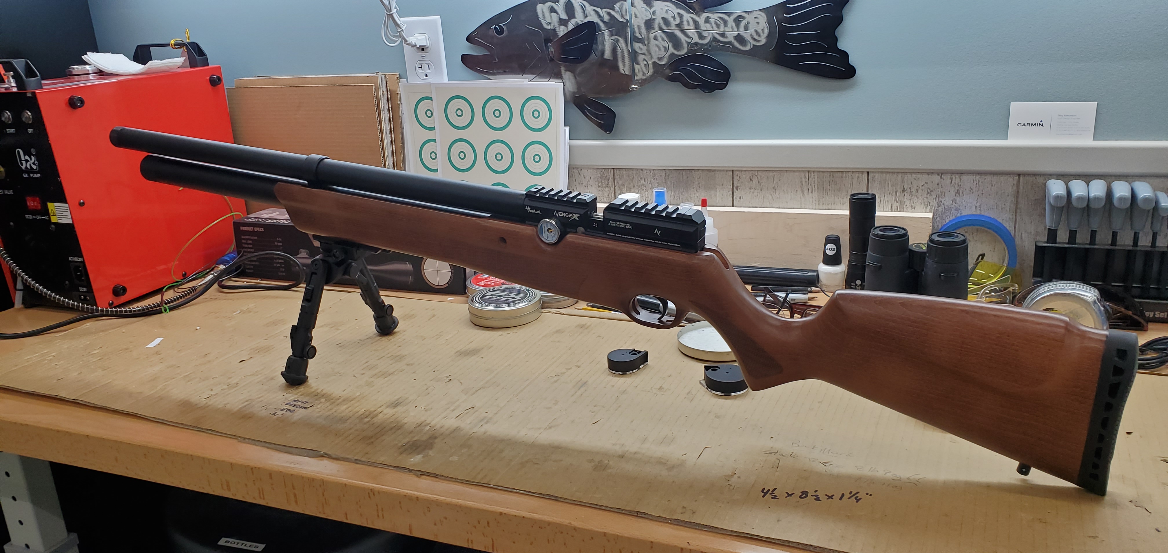

What a nice day-early UPS delivery today for my first pcp rifle. First impressions... I'm gonna like it! Arrived in great shape still with 4kpsi in tube and reg at ~2750. I checked things out, tightened screws and put a few pellets through it. Reg dropped to 23-2400 and stayed there. So some creep I guess. She's new. With the 25.4 JSBs it was doing 880-900. The hammerspring was +1 5/8. Ran the snake thru several times and cleaned out the barrel. Clamped on the bipod, installed the hi-cap mag and grabbed some rings. Had 3 sizes on hand. 1", 1.2" and 1.35". Ended up using the 1" ht Monstrum and they put the Athlon 6-24x50 Talos right where I wanted it. Clears the shroud and mag nicely. 4 or 5 shots and it's hitting pretty close. Gonna give it some air and shoot till dark!

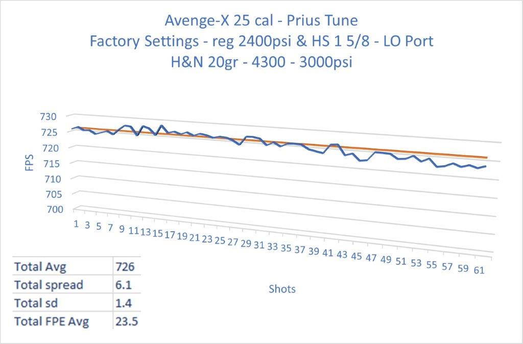

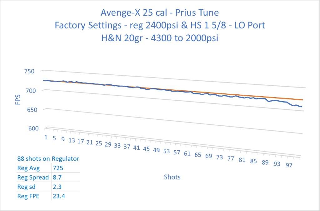

I had the idea at work today that I wanted to dial it back and see if I could find something for the 2 tins of H&N 25cal 20gr pellets that Amazon "gave" me on a goofed order. Thinking about a low-power hi-mileage 100-shot tune. It was easier than I thought it might be. I just left the reg and HS at the factory settings and simply turned the transfer port knob to LO and it got me pretty close. I ran out of time to shoot more than 60 pellets but still sitting above 3kpsi, so I'll finish it up tomorrow. The spread and sd are respectable. I was rushed but accuracy seemed decent at 25yrds. This rifle is gonna be so fun to try out all there is to tweak on. Other graph is from last evening of the 1st fill at factory settings. I forgot the chrony for 1st 3 shots and I had some dryfires at the end of a couple mags. Not sure what that was about?

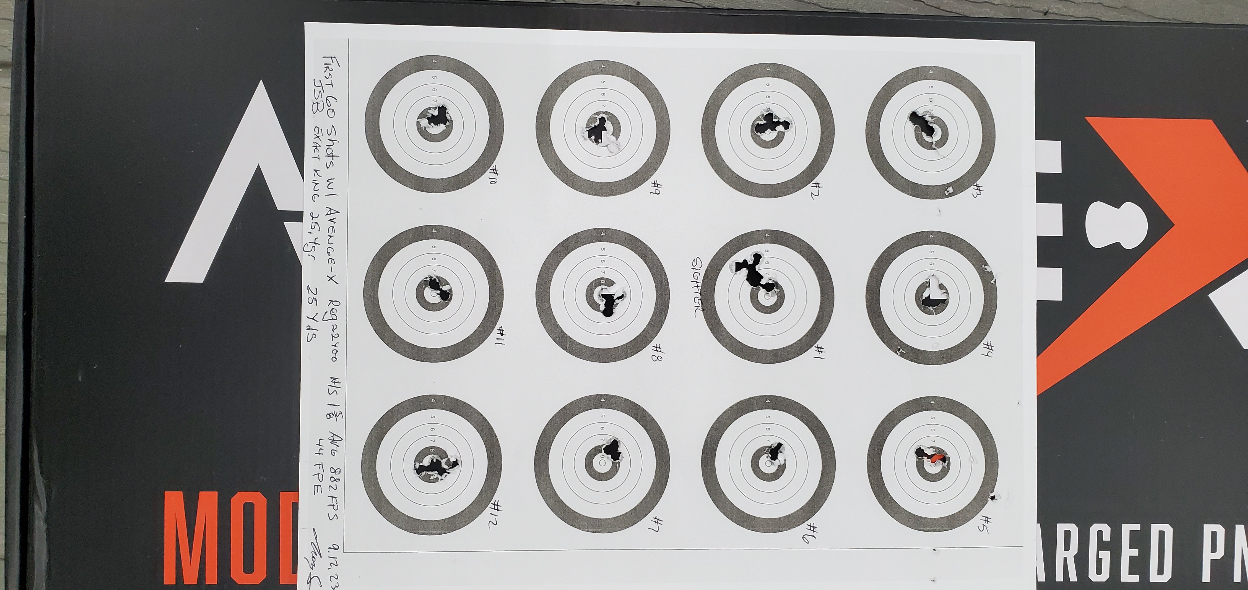

A couple of 50yds groups and testing from last night. We had 2 Avenge-X .25 out shooting and tuning.
Hoping to find a better more consistent pellet that it likes to help eliminate the fliers. There was a touch of wind but not to cause the major fliers.

I ended up with 88 shots on the reg with the low power tune using the H&N 20gr. Accuracy is not as good as with the JSB 25.4 but plenty good for a 25yd squirrel headshot. Quiet too.
