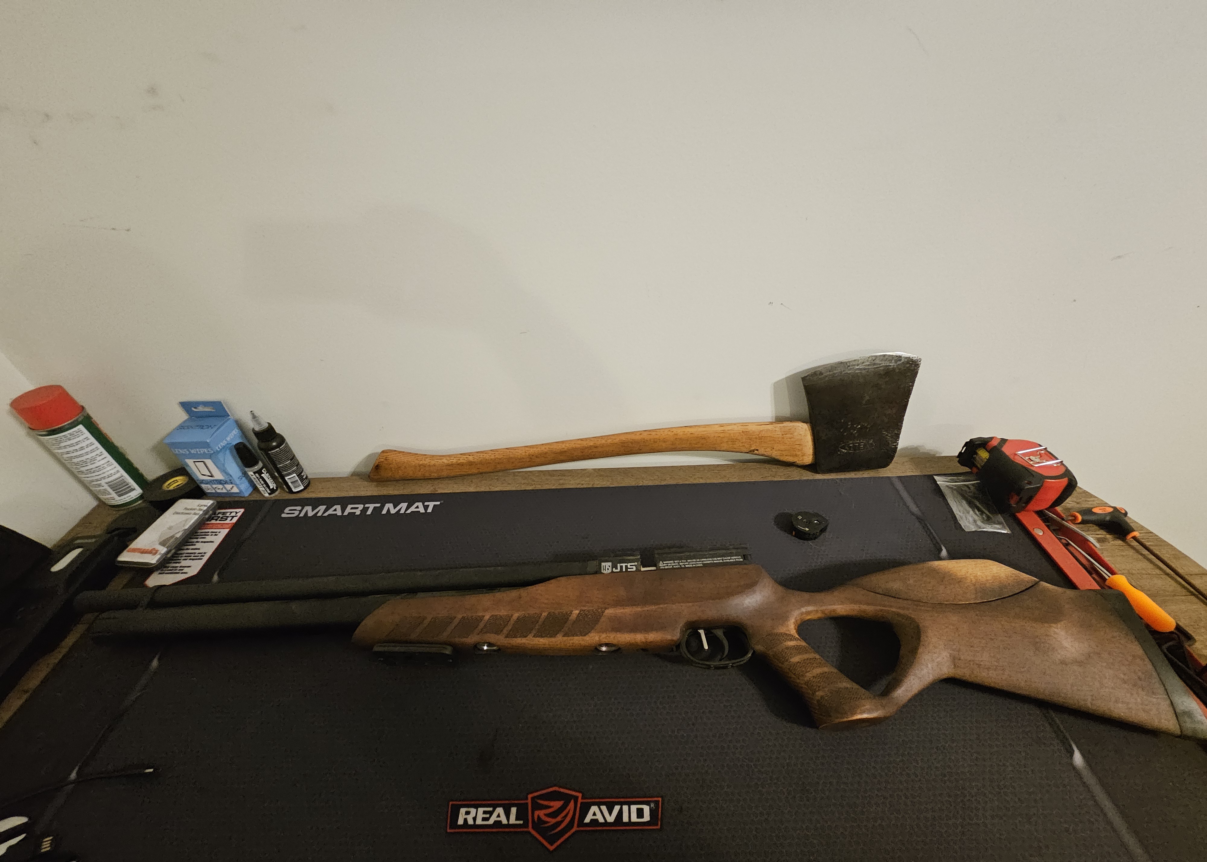

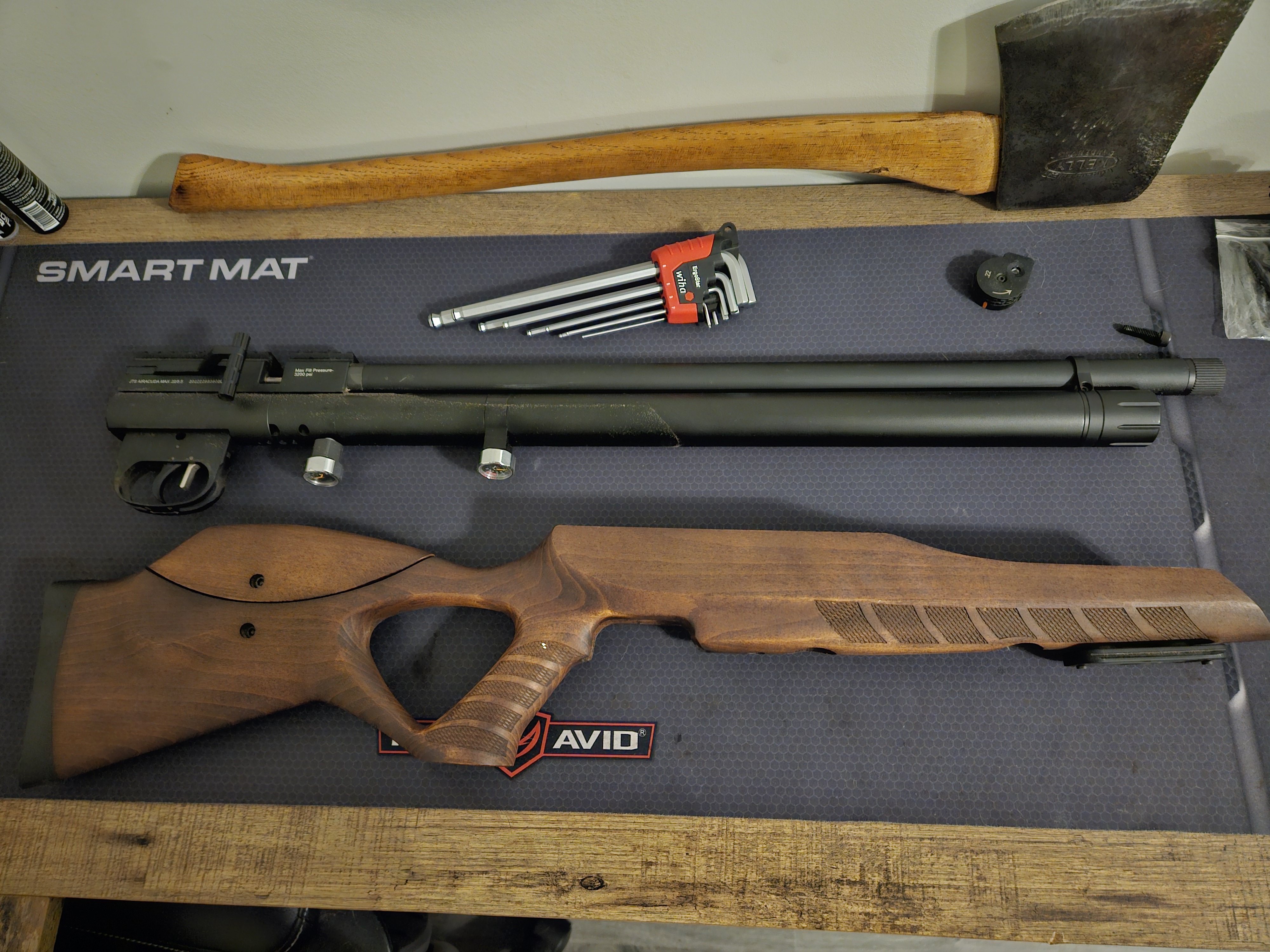

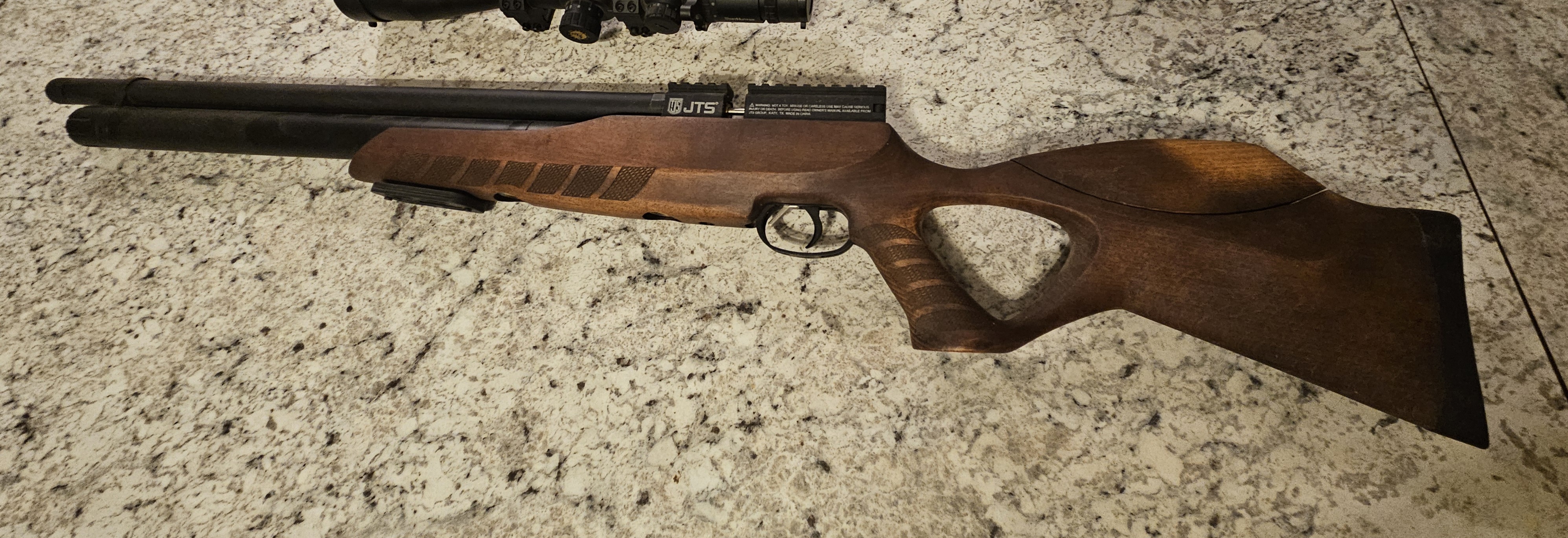

Since I shifted hobbies a bit from a year ago I am not in the same financial position to be unloading 10000 dollars on airgun setups lmao hence why I have been looking at budget setups. Well a friend of mine who's moving to a far less restrictive part of the country (so he can go back to PB'ers) did some old school bartering with me and I traded some mechanic work for his JTS Airacuda Max .22 scoped (west hunter 4-16 , not a bad scope actually), air supply setup, case, and ammunition. Win win for me , love using my automotive tools and have been on the fence of which way to go with airguns.
I am going to set this rifle up for 50 yard bench rest in Salem NY that a few other shooters I know frequent as its a dog friendly event and in a beautiful area. Also will be my plinker but also with its cost being so cheap, I want to have some fun and build it.

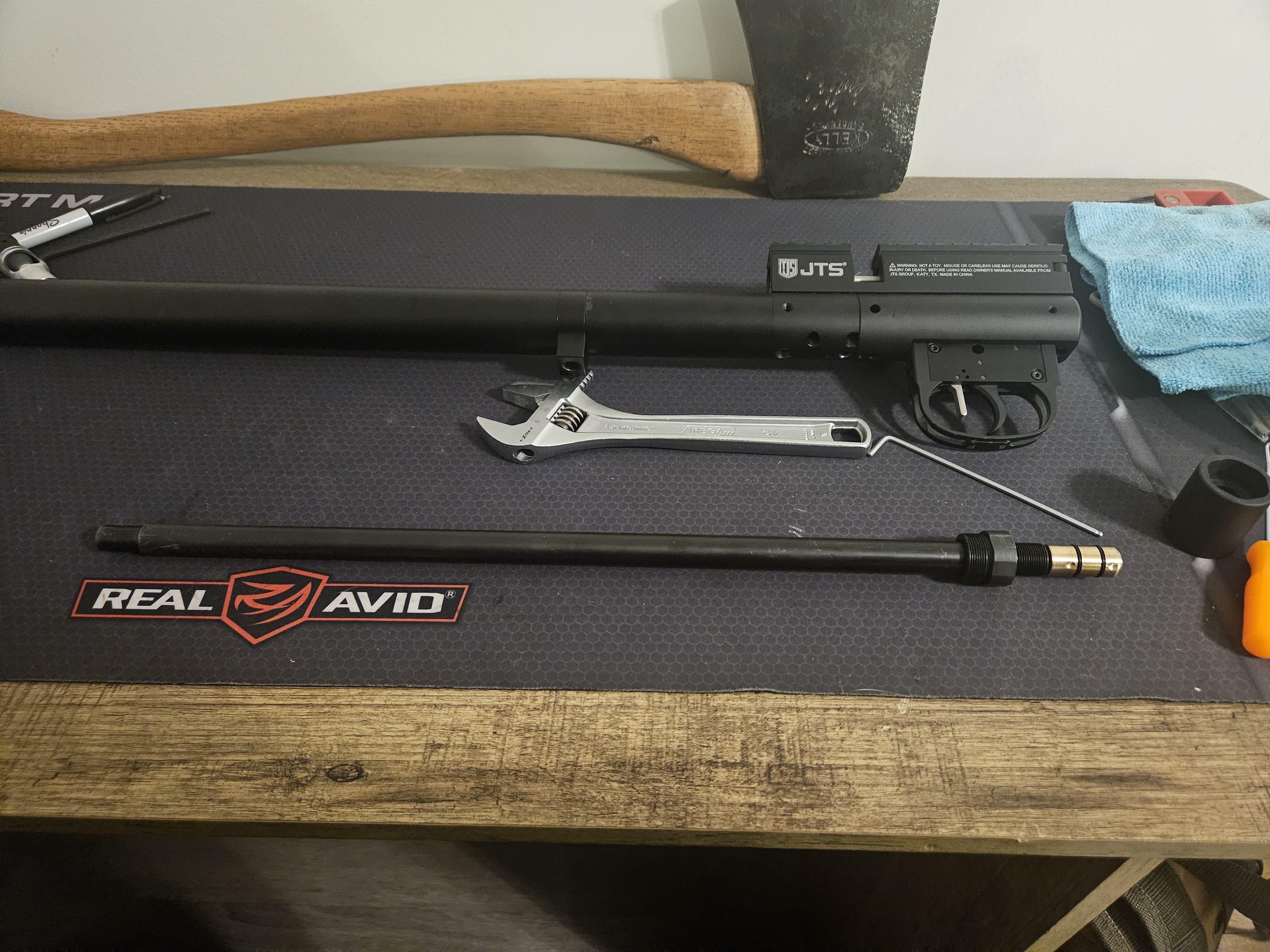

I plan to open up the ports, smooth the transitions, work on the hammer spring, and valve spring, and go from there. Target goal is a consistent 30-40 shot fill with 22.07 grain JTS pellets at 880 ish FPS with less than moa accuracy at 50 yards.

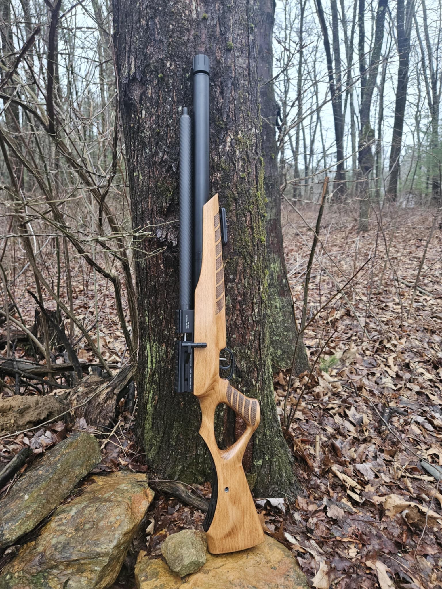

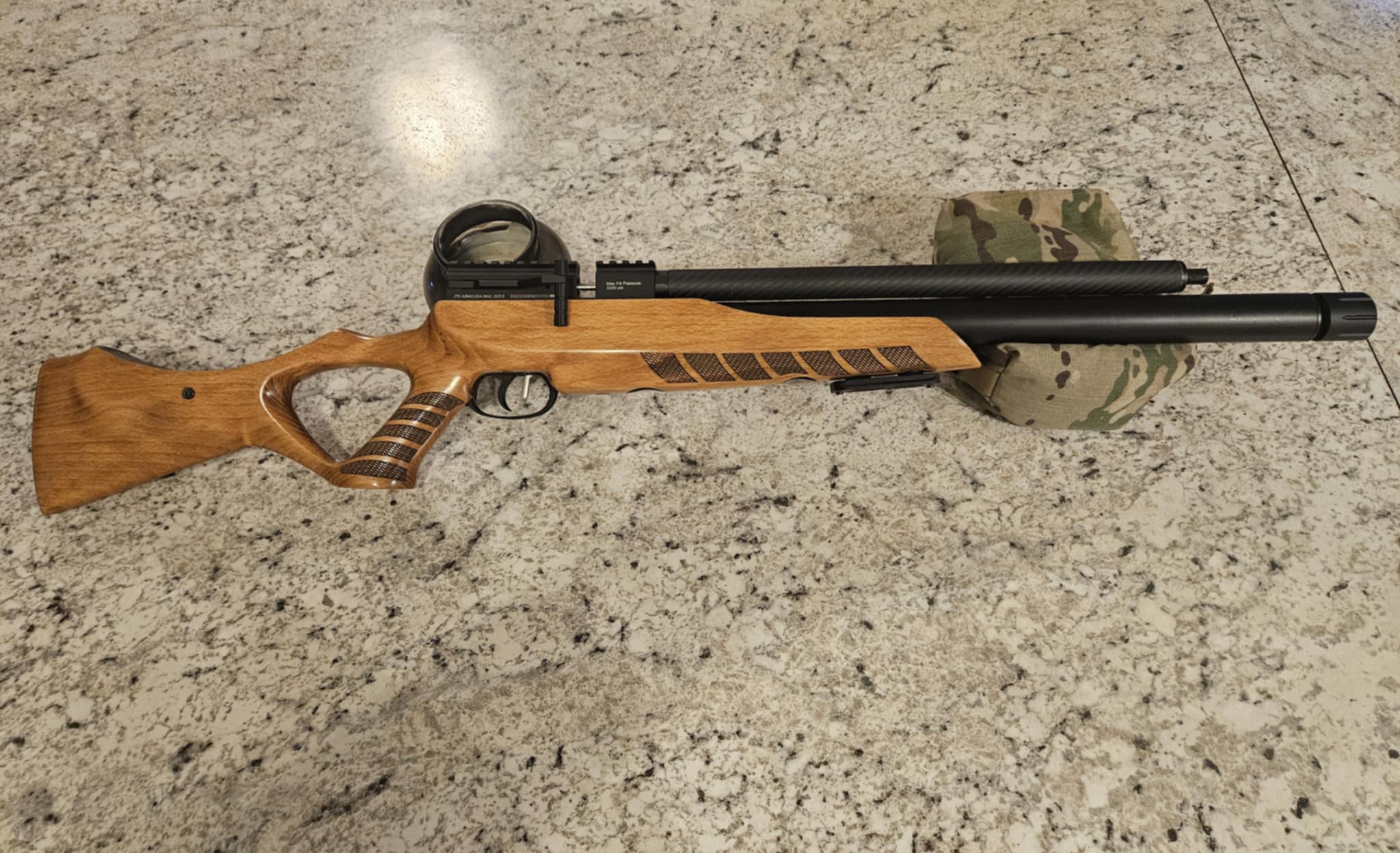

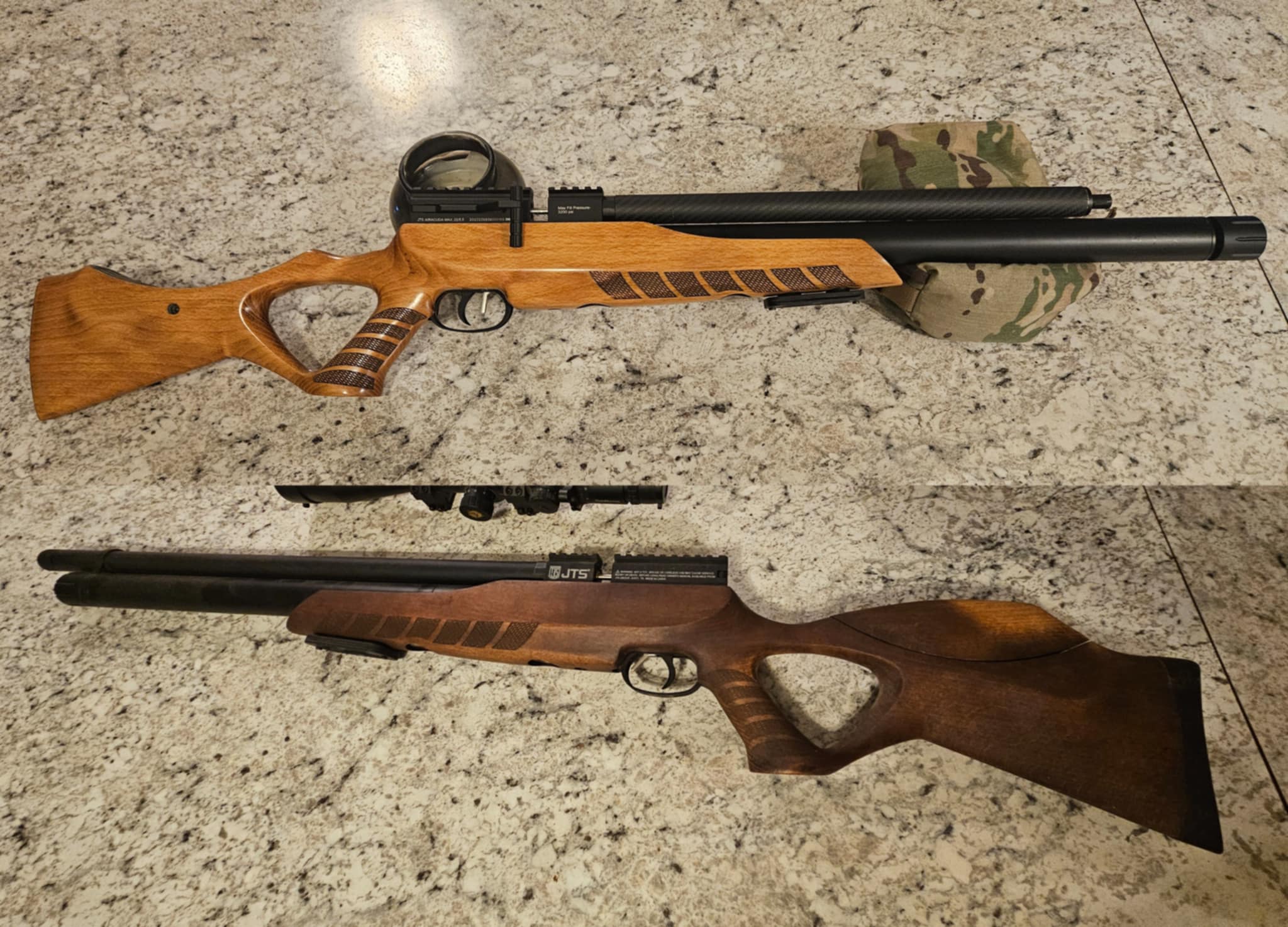

I have experience shooting this particular rifle as it was owned by a friend of mine, I actually modded it when he first got it and added an arca rail (see above thread).
There are a few items I'd like to have made though, id like an external plenum made/machined to take the place of the regulator gauge, 16cc-22cc will work perfect I think, also a few other small items if anyone has any good recommendations on who I could go to, I am all ears. EDIT: ALREADY FOUND A GUY AND WE ARE ALREADY WORKING ON MAKING A PLENUM FOR THIS.

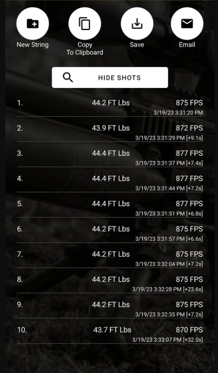

The regulator on these rifles are actually super consistent so that will stay, the string shown is from the .25 I used to have, it was always insanely consistent, this .22 is no different (just can't find the strings we had anywhere) .
And here is a picture of it with my old .25

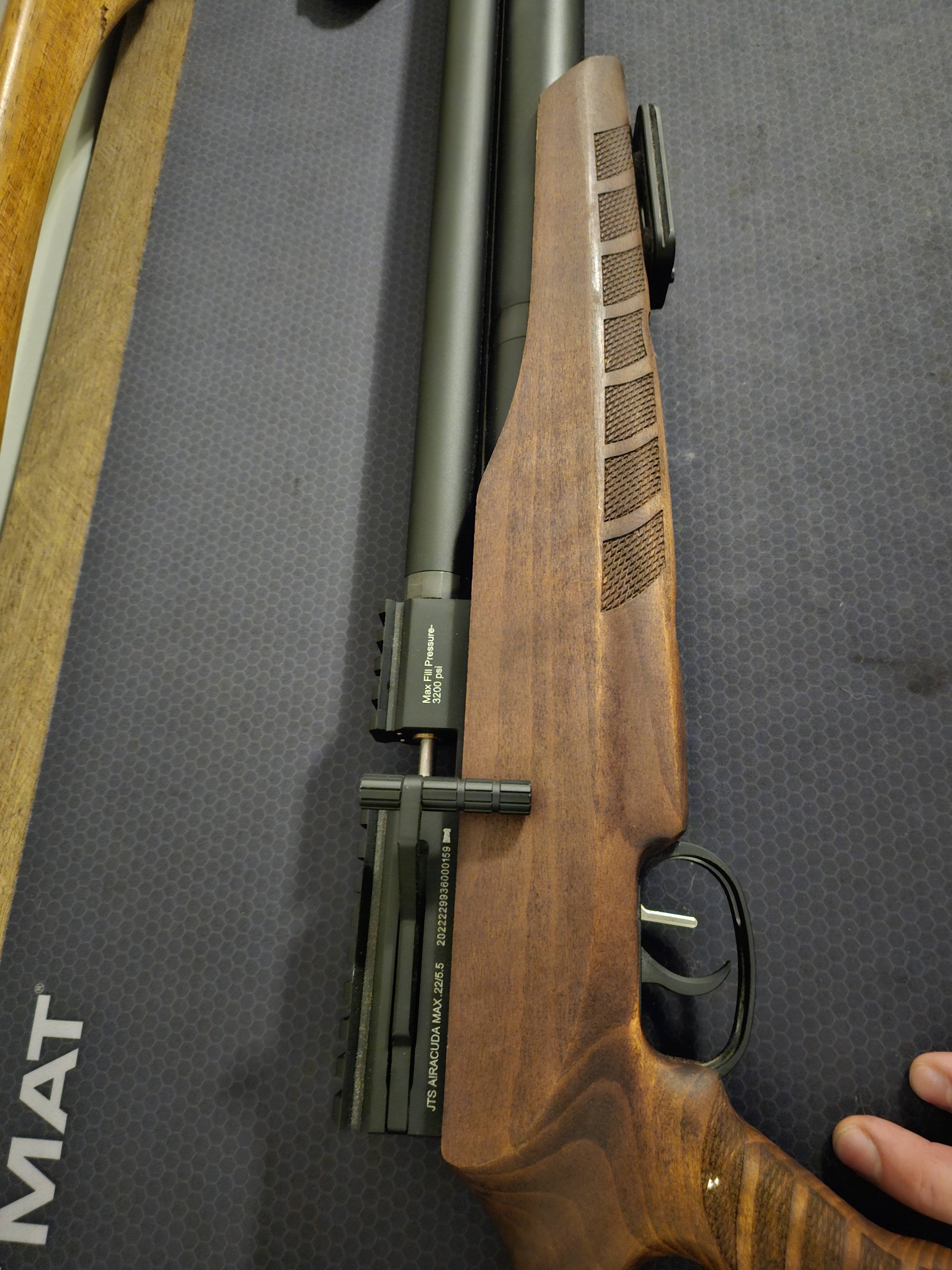

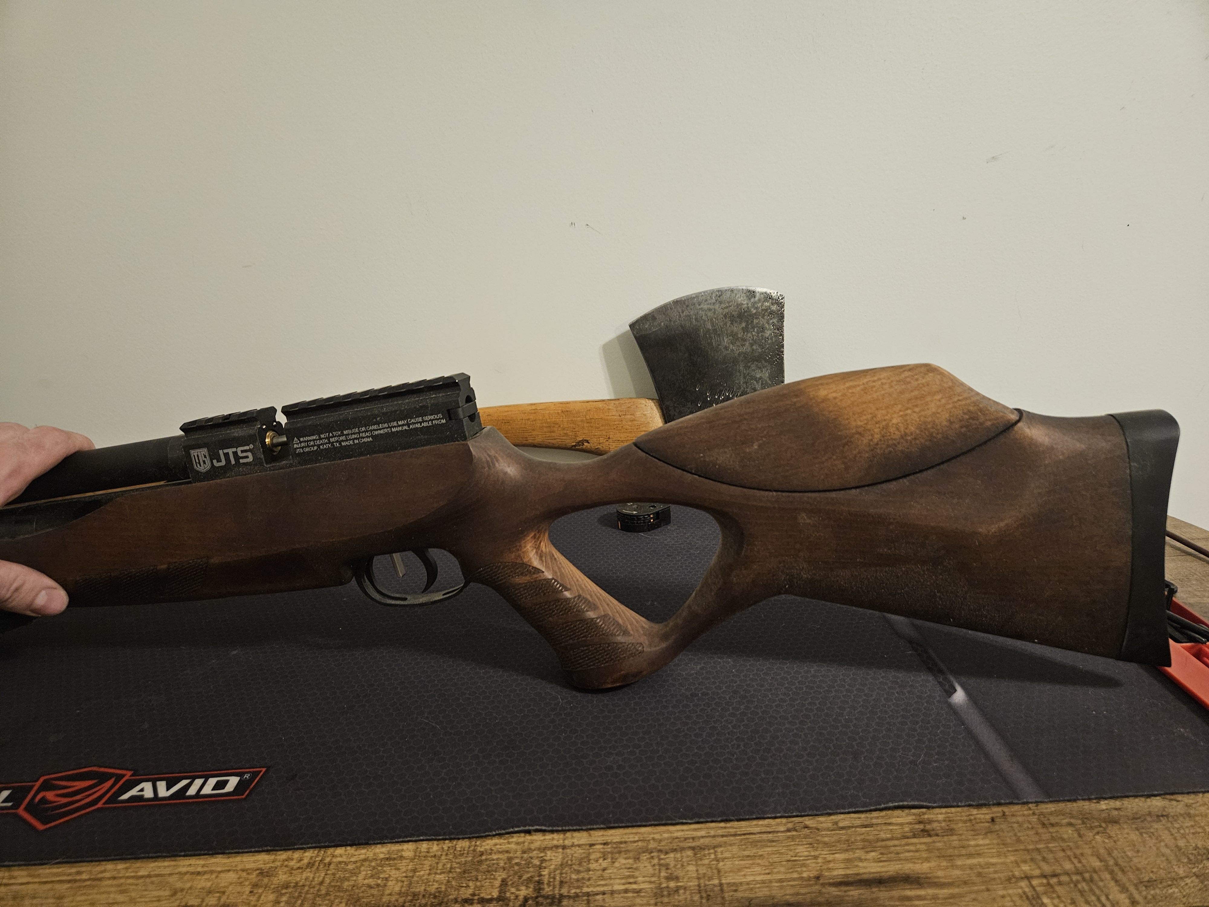

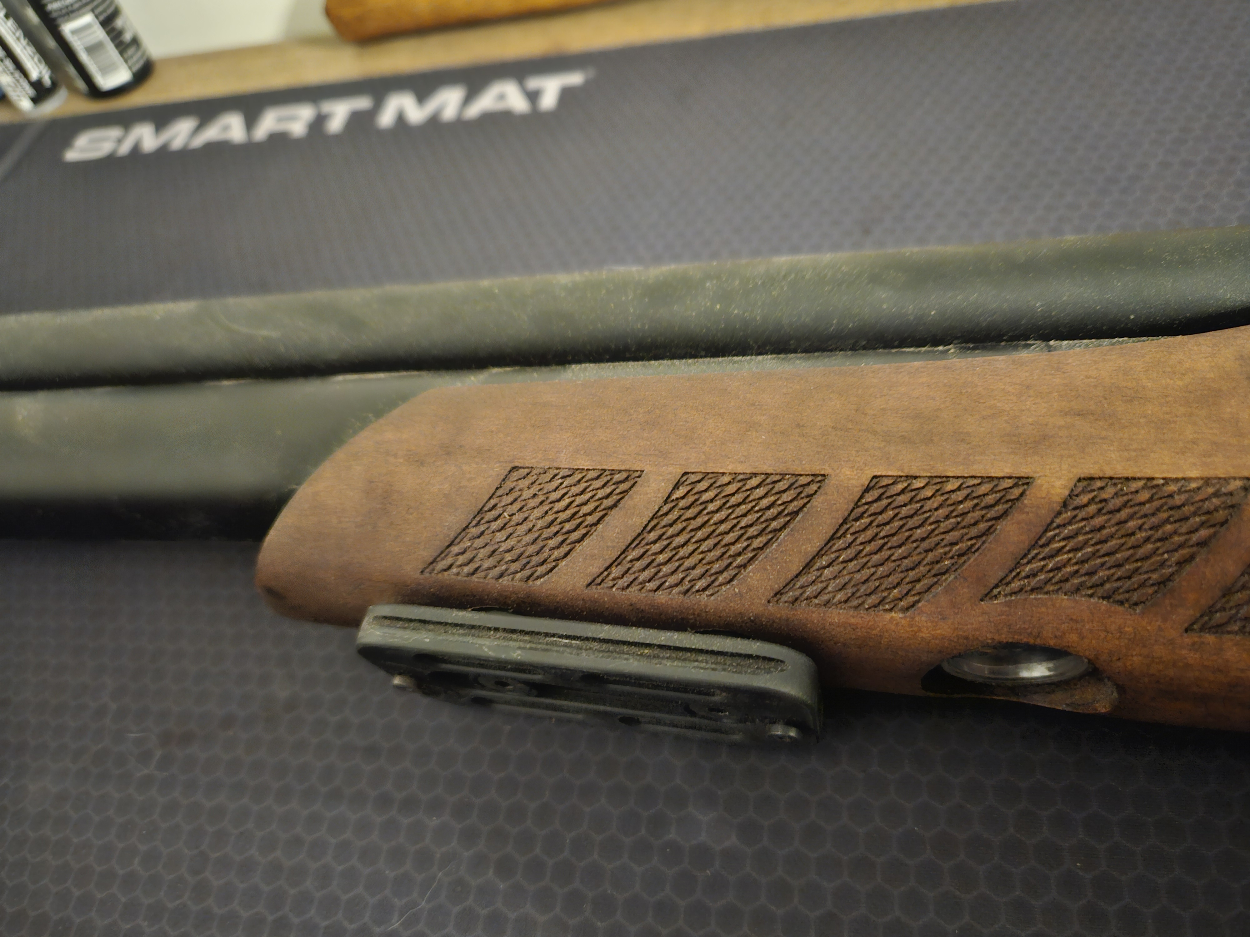

Adding an Arca rail to a JTS Airacuda Max

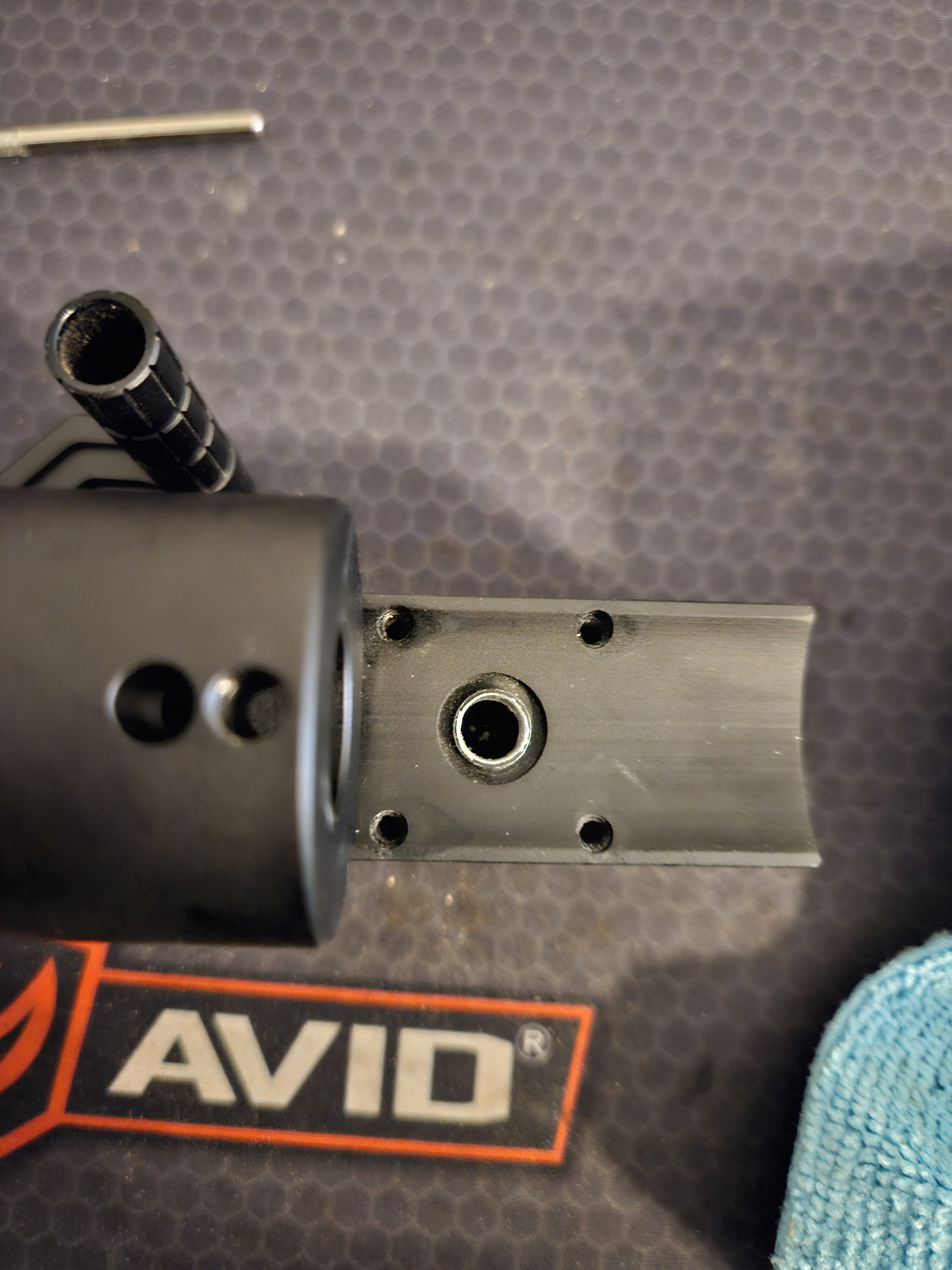

I am a big fan of mounting pic and arca rails "properly" imo. So I will show you how I did it on my buddies rifle on Sunday evening. Also these rifles aren't bad for the money, that's a 35 yard 10 shot group.
