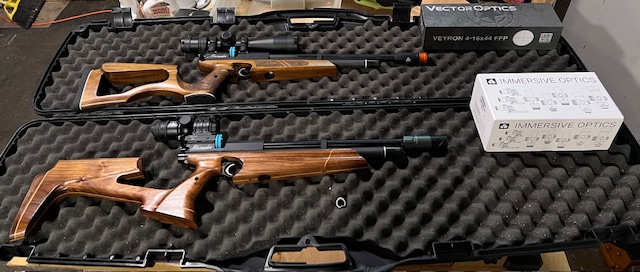

I dont mind the fill location at all, I prefer a foster over probe myself.
@_CTAIRGUNNER_ Makes sense seeing that the barrel on your Prod appears to be longer than what comes with the stock gun.either that or there’s some sort of add-on piece between the barrel and the moderator. Therefore the affixed moderator does not interfere with the foster quick connect on a fill whip. Not a bad idea.
@_CTAIRGUNNER_ Makes sense seeing that the barrel on your Prod appears to be longer than what comes with the stock gun. Therefore the affixed moderator does interfere with the foster quick connect on a fill whip. Not a bad idea.
Yeah, I have never really looked at a stock Prod too in depth, I just called Rich and asked for something haha, I am glad it is pointed out to me that he added this because now I know, I definitely think its a good idea myself.

Yeah….if u look at hill’s moderator for the prod he extends it to make room the a fill fitting.
But I’d rather somebody made up a side filling option like Hume did for the mrod.

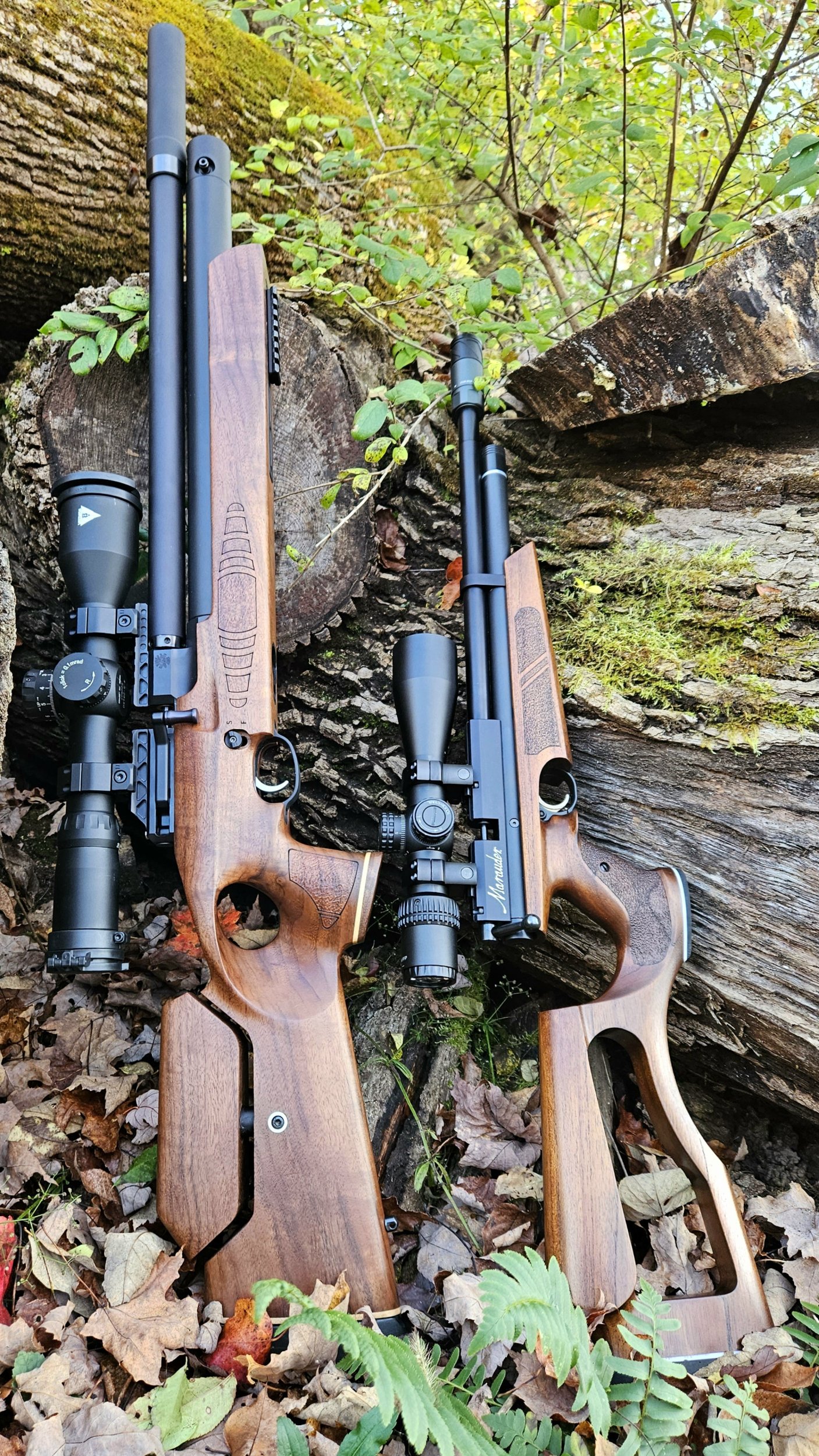

Is this the Rapid-70 kit? Can you list all the mods? I think this would be great next to my wood stock to highlight the range of possibilities. Any links to the mods would be appreciated. TIA
So I’m not sure the rapid frame is still available. But yes….this is one of them :)
Mine has a Huma reg with a custom 16cc plenum. .18” transfer port.
Hill light weight hammer with peek striker and hills .047x2” hammer spring.
(Hard to believe how much that hammer settled down the shot cycle)
Got is doing 3 mags (24 shots) of 18 gr jsb at 655 fps
It’s impressively accurate out the 50y
For some reason my barrel doesn’t like the 16gr jsb and hades.
It’s a DonnyFL extended adapter
I had one along with a full fitting with gauge from MAP on my Rapid 70 Prod bullpup. I don’t have the Rapid 70 kit anymore. It was interesting at first but I couldn’t get comfortable with it and didn’t like the ergonomics of it. The Prod is a much better carbine than a bullpup IMHO.

I have the same config with light hammer, large TP, other porting and reg at 120. Shooting Hades at 700. Action is much quieter than stock and very crisp. I could not get rid of hammer bounce (farting) with orings or tuning. However, it sounds like CT’s tune is very good in that regard. My next step is to get this stock so thanks for highlighting it, CT! I’m tempted also to get a slightly longer LW barrel (rabbit hole syndrome again 🤓). FWIW, I use an Impulse 1200 mod and its tapering allows me to attach the foster fill without removal or extension. Two sections quietens it down as well as anything else.

Rich has a new stock coming for these rifles that is the same as mine but extends/flows all the way down toward the end of the tube. May be something worth waiting for :D
