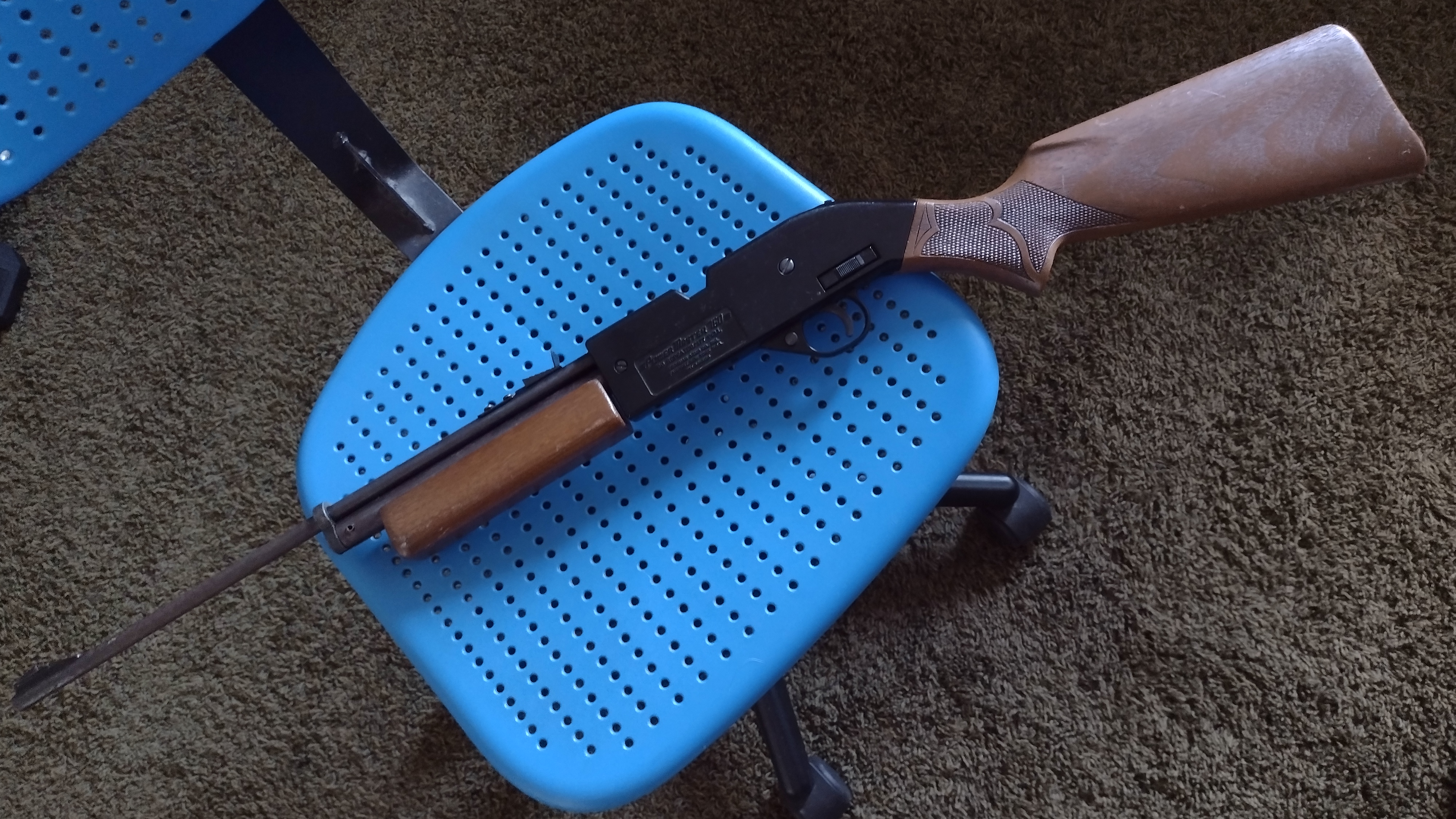

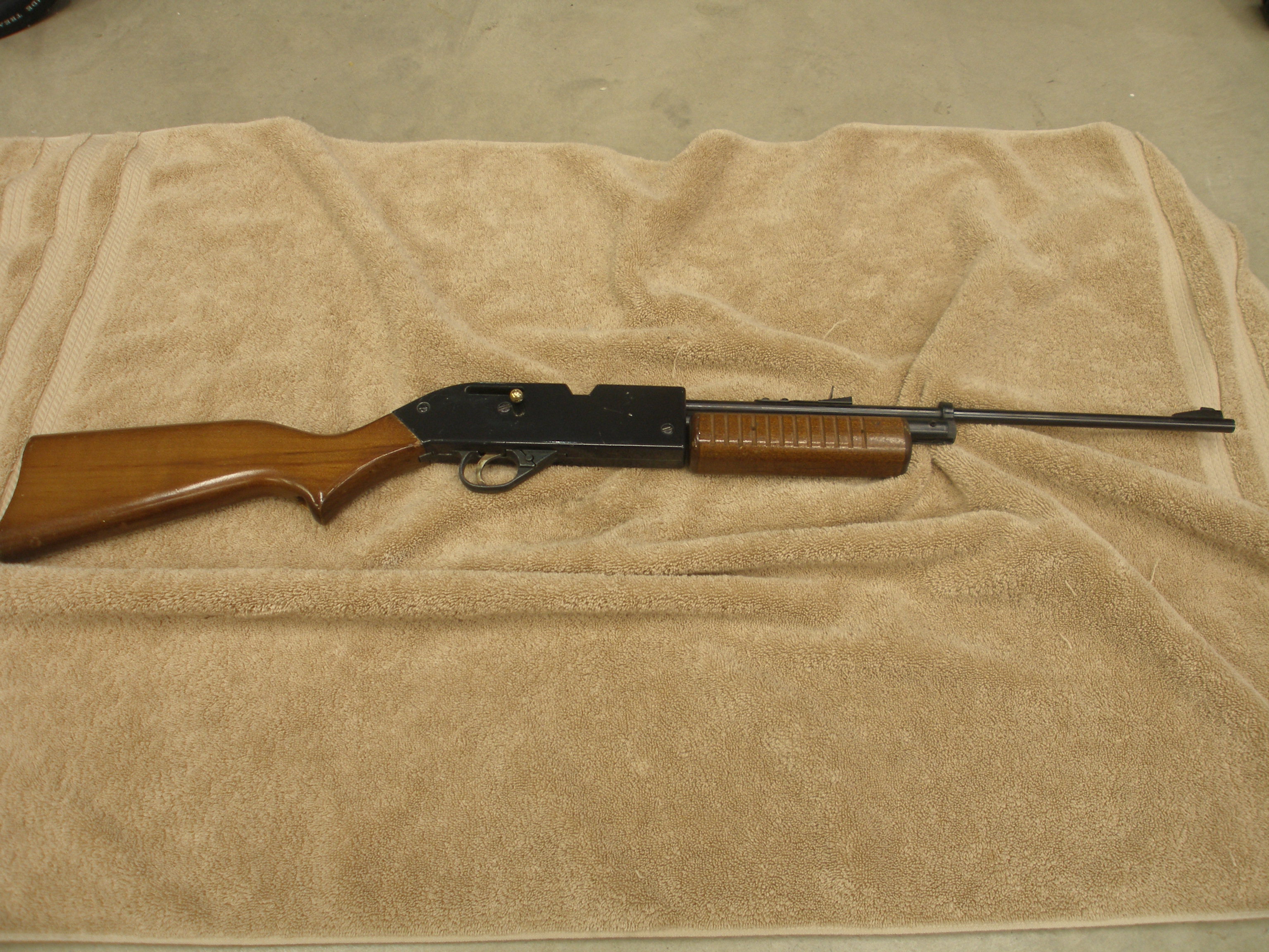

My childhood 760 Powermaster. I think first variant but not sure.

I think this wood handle is a one year wonder. Maybe a reject design over the 1st variation handle?

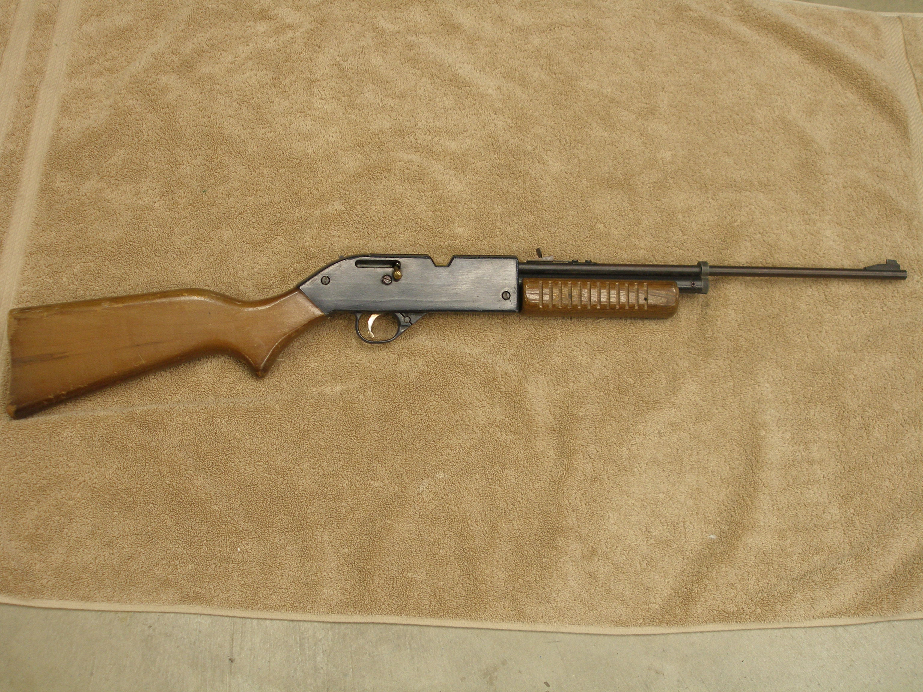

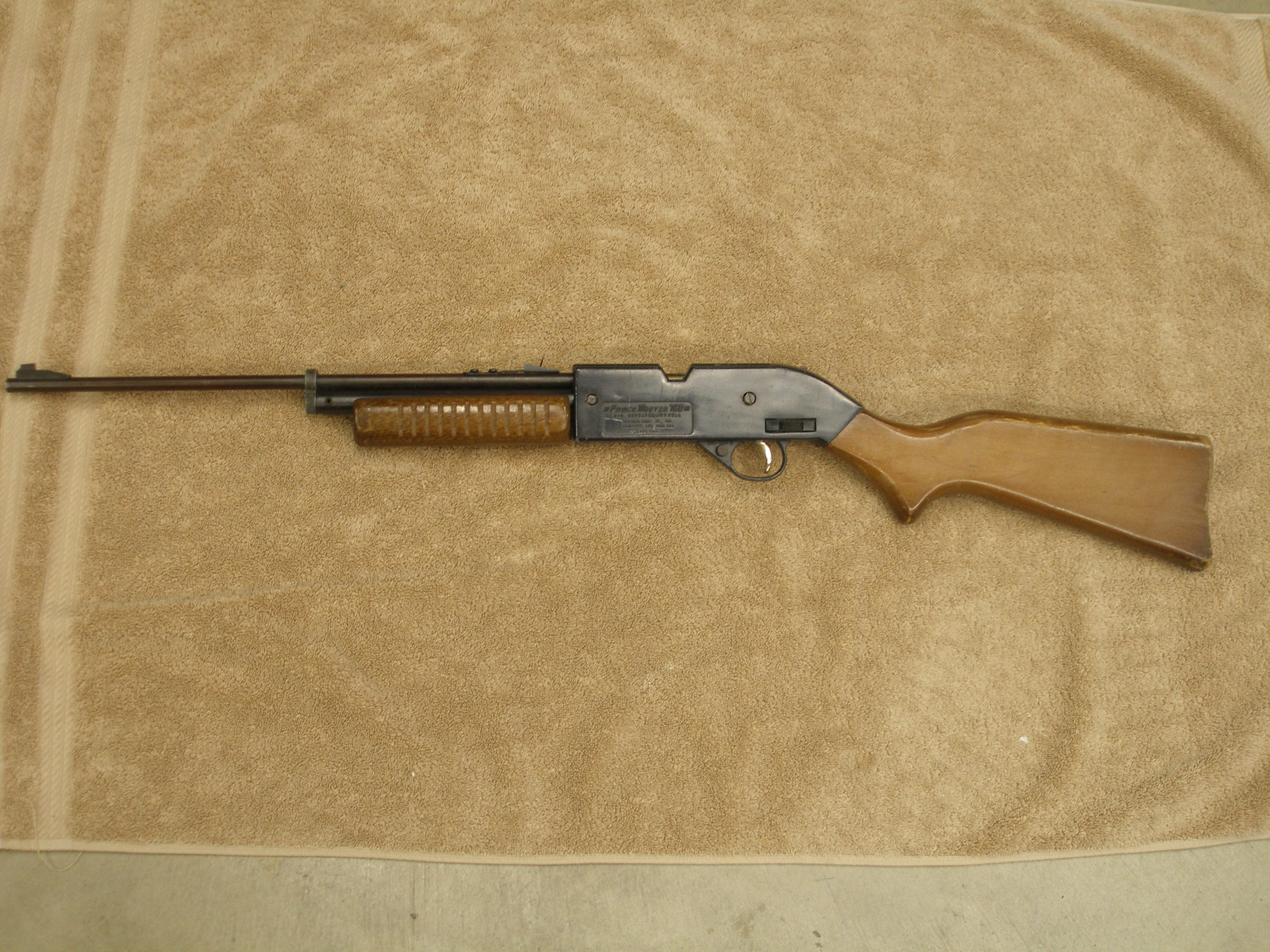

It looks like yours was only made in that configuration for a couple of years. They went to all cheap plastic soon after that. I have one with the same stock and fore-arm.
You can find it here. - https://discover.crosman.com/blog/crosman-product-dates-of-manufacture
Model 760 PowermasterPneumatic, BB repeater, .177 cal., pellet, single shot. Third variant, self-cocking w/styrene stock & wood forearm.Rifle1974-1975

That variant was one of the last good ones it seems, before they went mostly plastic. Glad i saved it.
They're not hard to fix, so you should be able to get it going again. That's a really nice one. I tried lubing mine using 'Prestone power steering fluid with leak-stop' after it started losing air. That worked and it's fine now. I'll replace the seals eventually.

That leak-seal has lasted three days so far. Lol. The problem is usually the quad-seal. The o-ring that replaces it is 4x8x2mm. You can get it at just about any auto parts place. Remember to grease it when you put it in. That helps. Youtube has some very good repair vids.
