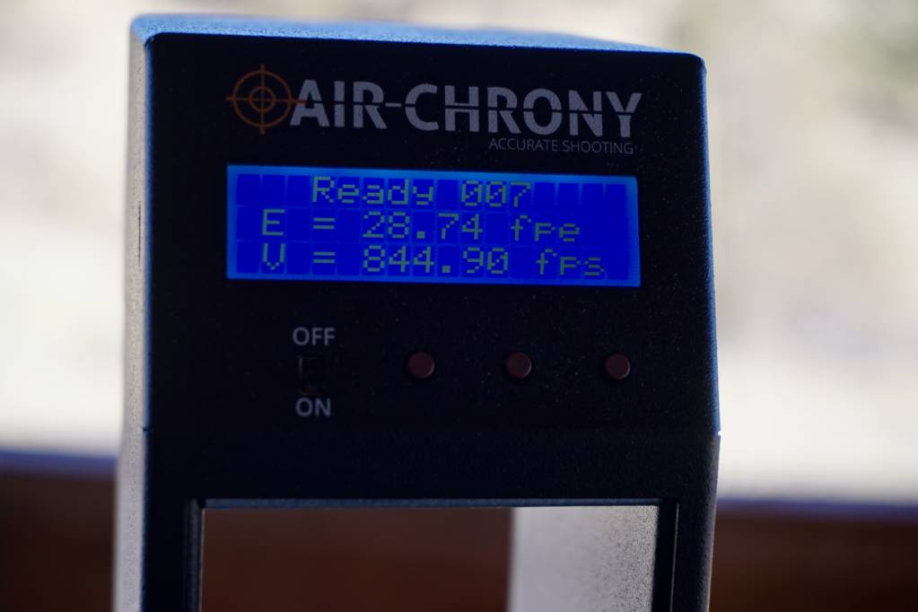

I wanted to see how the onboard crony was performing so, I whipped out my Air Chrony and sent some shots through.
There was an 11 fps average difference between the two readings. But, the difference was consistent. I expected that there would be a few fps difference between the on-board crony and an external crony. (I didn't quite expect it to be ~11fps but, I could believe it to be true.) This test shows me that the on-board crony works and that I can trust the numbers it's showing me.
It does make me wonder though. If someone says that MKII's shoot best at 860, are they technically shooting around 870 at the muzzle? When I chrony my other rifles, I don't go through the trouble of exposing a bare barrel so my crony gets a true "at the muzzle" reading.

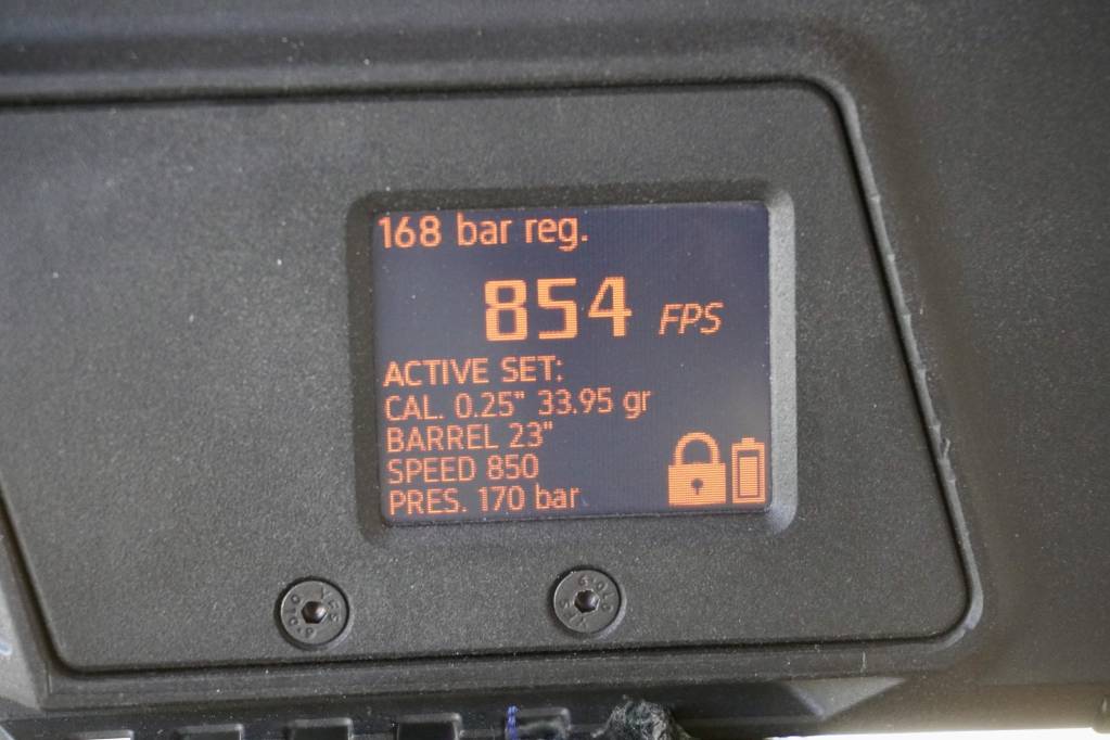

A few notes on the screen readout. 1st off, don't necessarily program your rifle to shoot the numbers shown. That's not a secret recipe, it's just me messing around.
On the top, you can see "168 bar reg" That's the actual reg pressure. If you decide to adjust the mechanical reg, that's where you'll be looking to set the pressure. The reg can be adjusted UP at any time with a flat head screwdriver. But, the air must first be fully drained, if the reg is to be adjusted DOWN!
"Active Set", and everything below it, is the programmed recipe the rifle is working towards achieving.
The last line, "PRES. 170 bar" is what the program wants the reg be set to. In this pic, my reg is technically 2 bar lower than what the program wants. That's well within the margin of error (5bar+/-) and the rifle will function just fine. In other words, you probably won't notice a difference by chasing down those 2 bars of pressure.
The very first change I made to my rifles setting was the "Auto Power Off" time! It arrived set at 1 minute and was constantly shutting off before I wanted it to. This setting has a bunch of selections ranging from :30 seconds to 1.5 hours. The rifle does make a noise when it turns on so, if you're using it in the hunting environment double check your time setting.

You are comparing two different measurements so maybe the 1.3% difference in indeed ok. The Air Chrony claims accuracy of 0.459 fps which at 844 fps would be 0.06%. The table below then shows errors greater so something is off. Looking at other chronographs I think their accuracy claims is too good to be true. LabRadar claims 0.1% and and my ProChrono DLX claims 0.5%. I don't know what Daystate specifies for the built-in chronograph but I would be very surprised if it was 1.3%.
