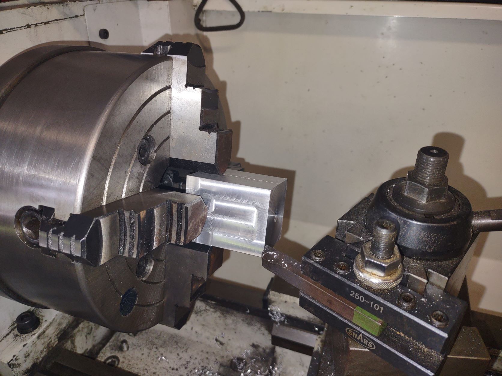

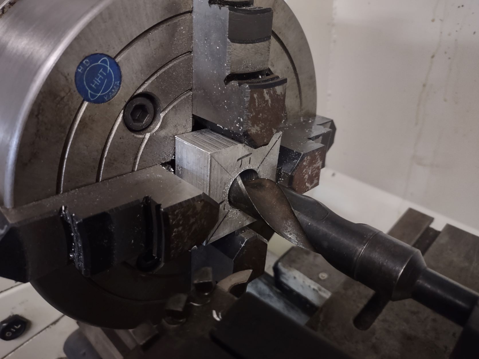

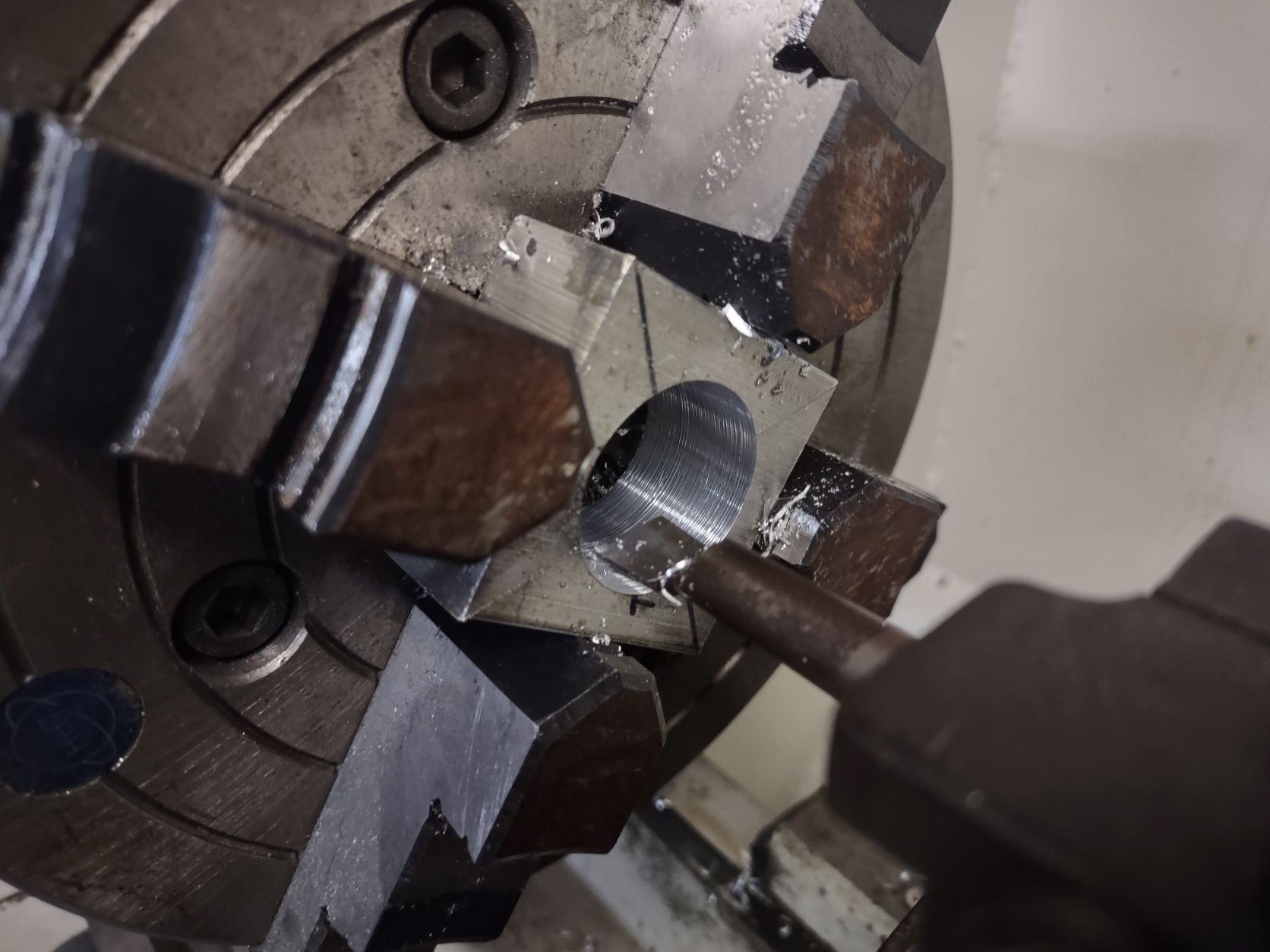

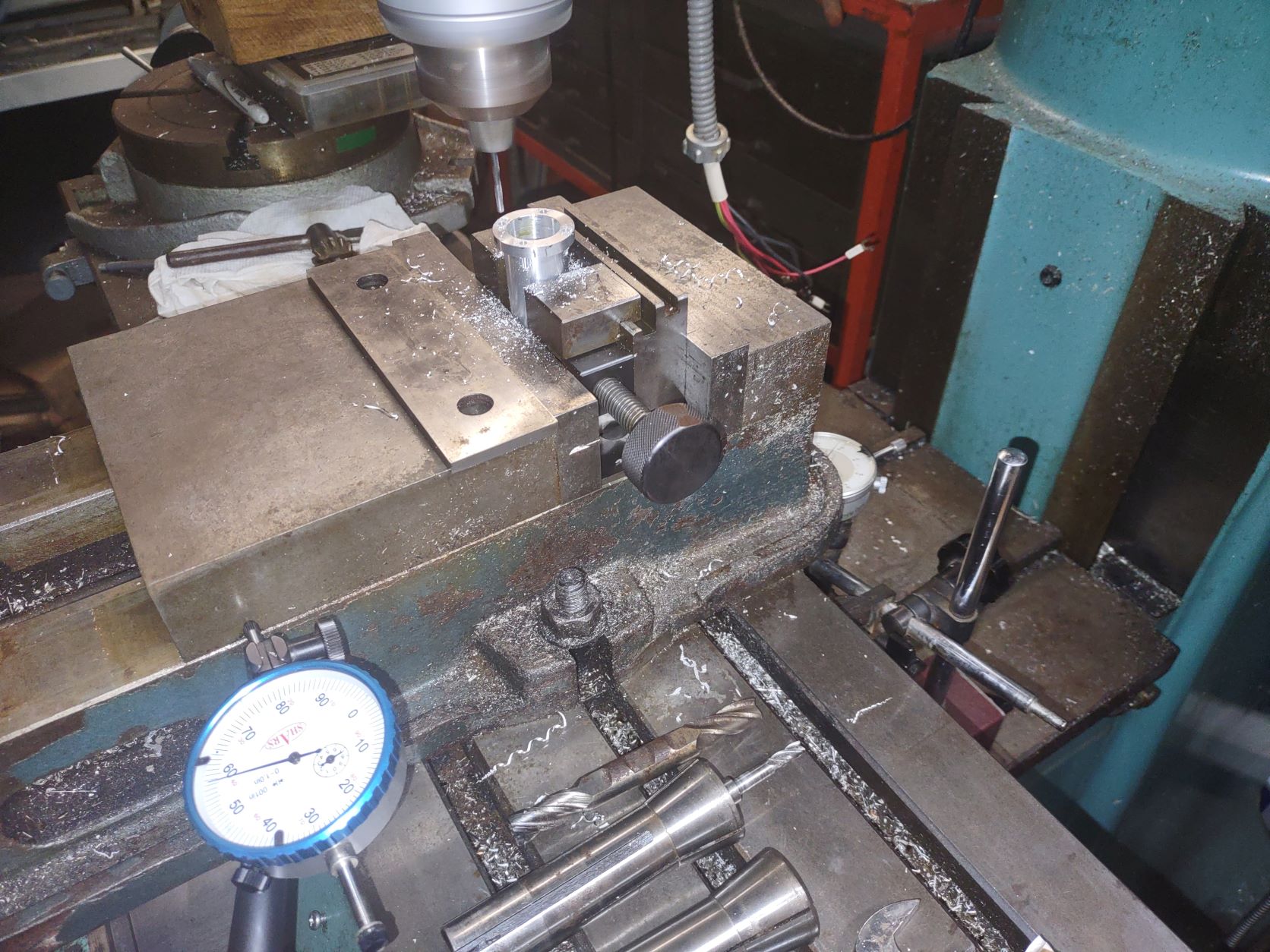

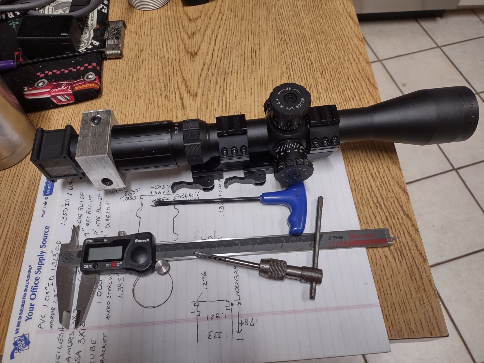

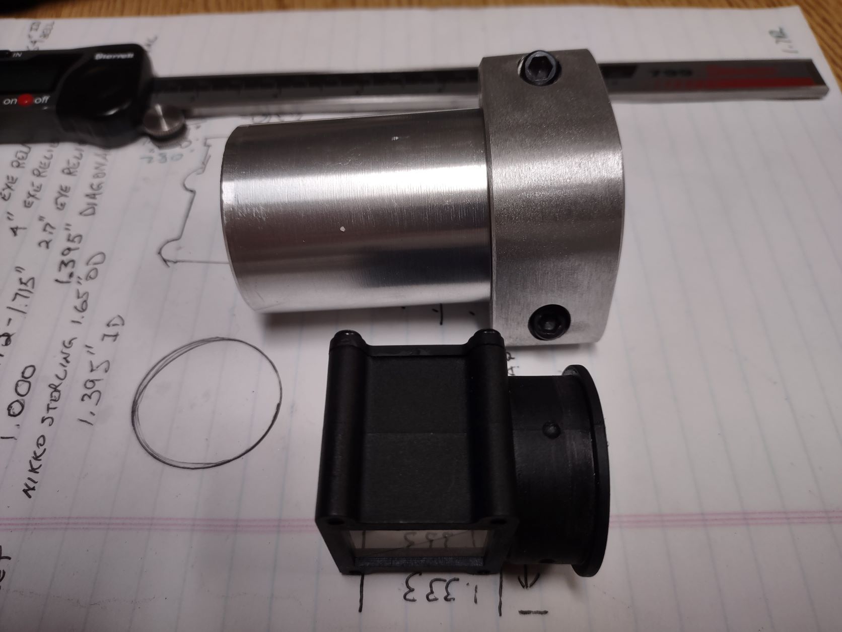

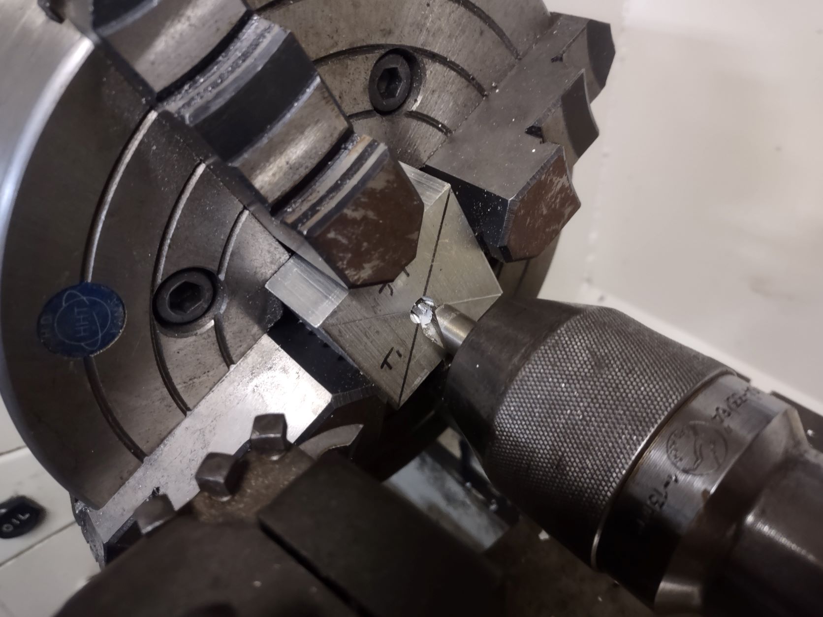

Here I'll say that I am not a machinist. I wish I had machining skills, but everything I know (very little) I've learned watching YT videos. I made several mistakes the first of which was cutting my mounting bracket into two pieced diagonally first thing. I should have cut a square, then drilled/tapped the holes for the mounting screws, bored it too size and then cut it diagonally with a slitting saw on the mill. I faced the 2 cut edges on the mill, then mounted it in 4 jaw on the lathe, drilled and bored to the proper dimension to mount on the scope. I left a lip on the back to hold the prismatic lens housing and keep it from slipping out.

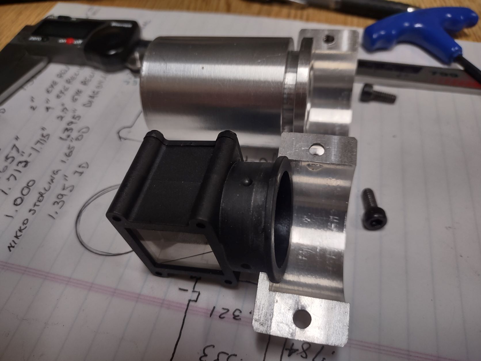

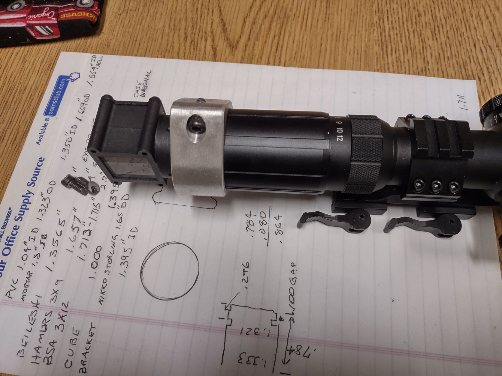

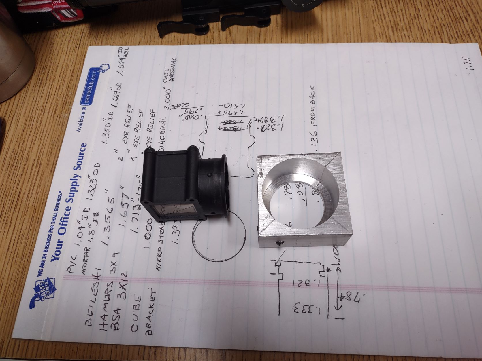

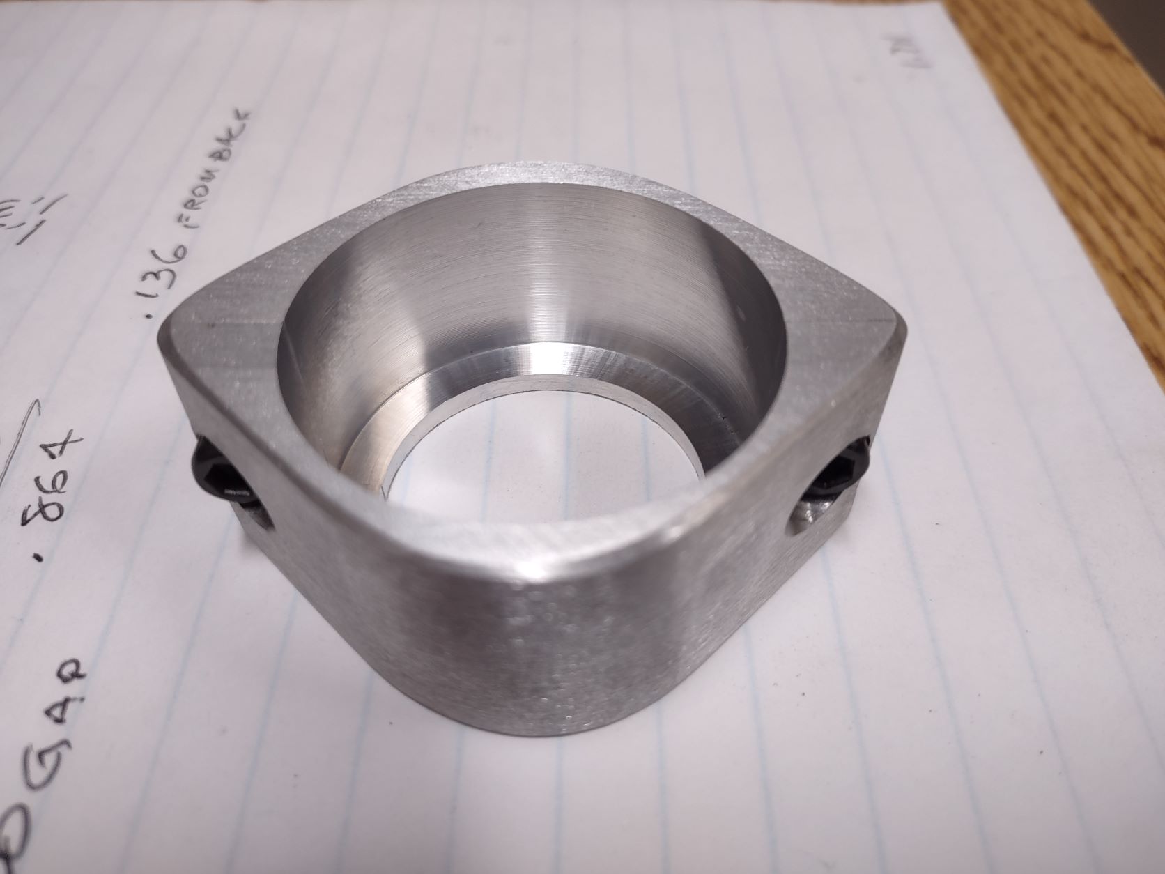

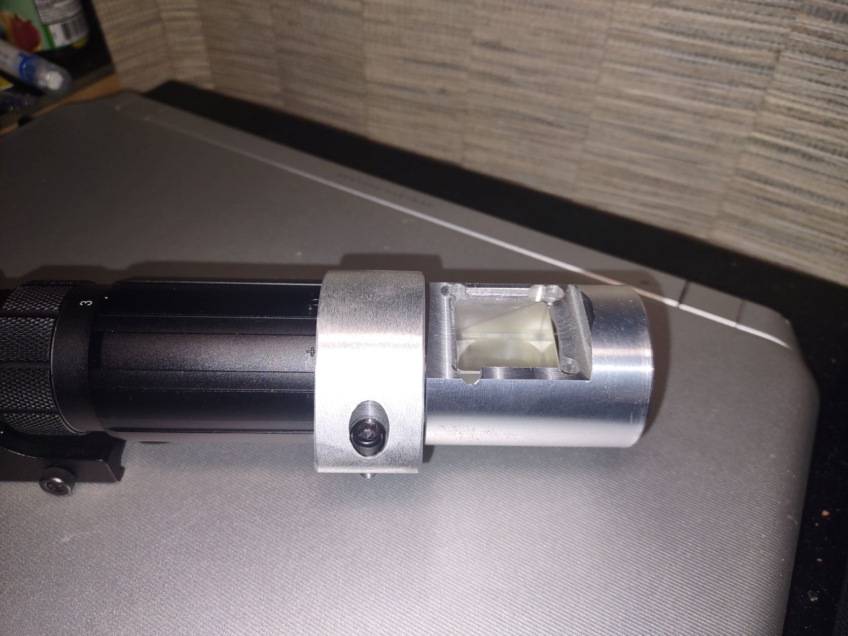

I'm not sure how many files I can load at once. So I will break it down into several post and try to explain things as best as I remember them. If you have any questions, please ask. Here are a few more pics. I was originally going to try and use part of the plastic housing that the prismatic cube was in but quickly decided to machine an aluminum housing out of another piece of scrap 6061. First pic is the "square" bracket mounted on the scope, a couple of pics showing the lip to hold the housing in place. Then final piece after shaping on my 2X72" belt grinder I used to make knives with years ago.

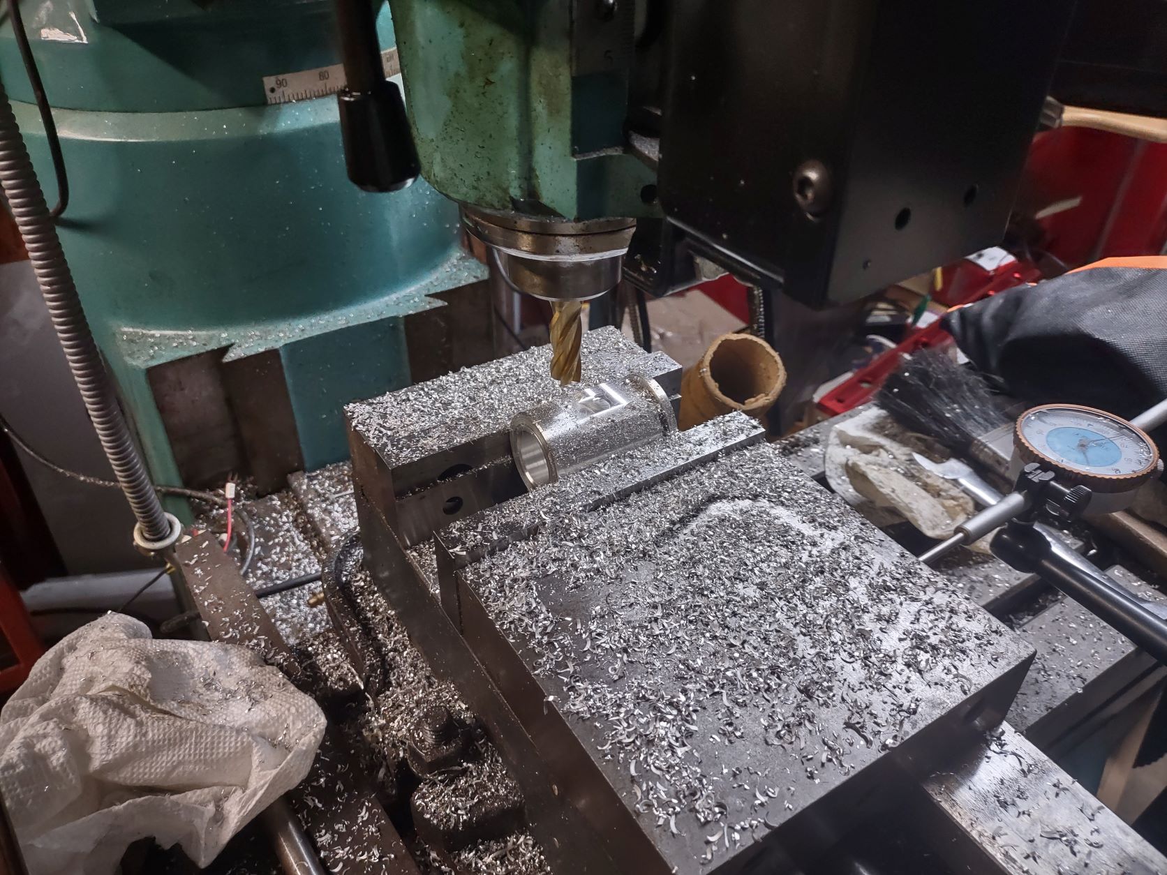

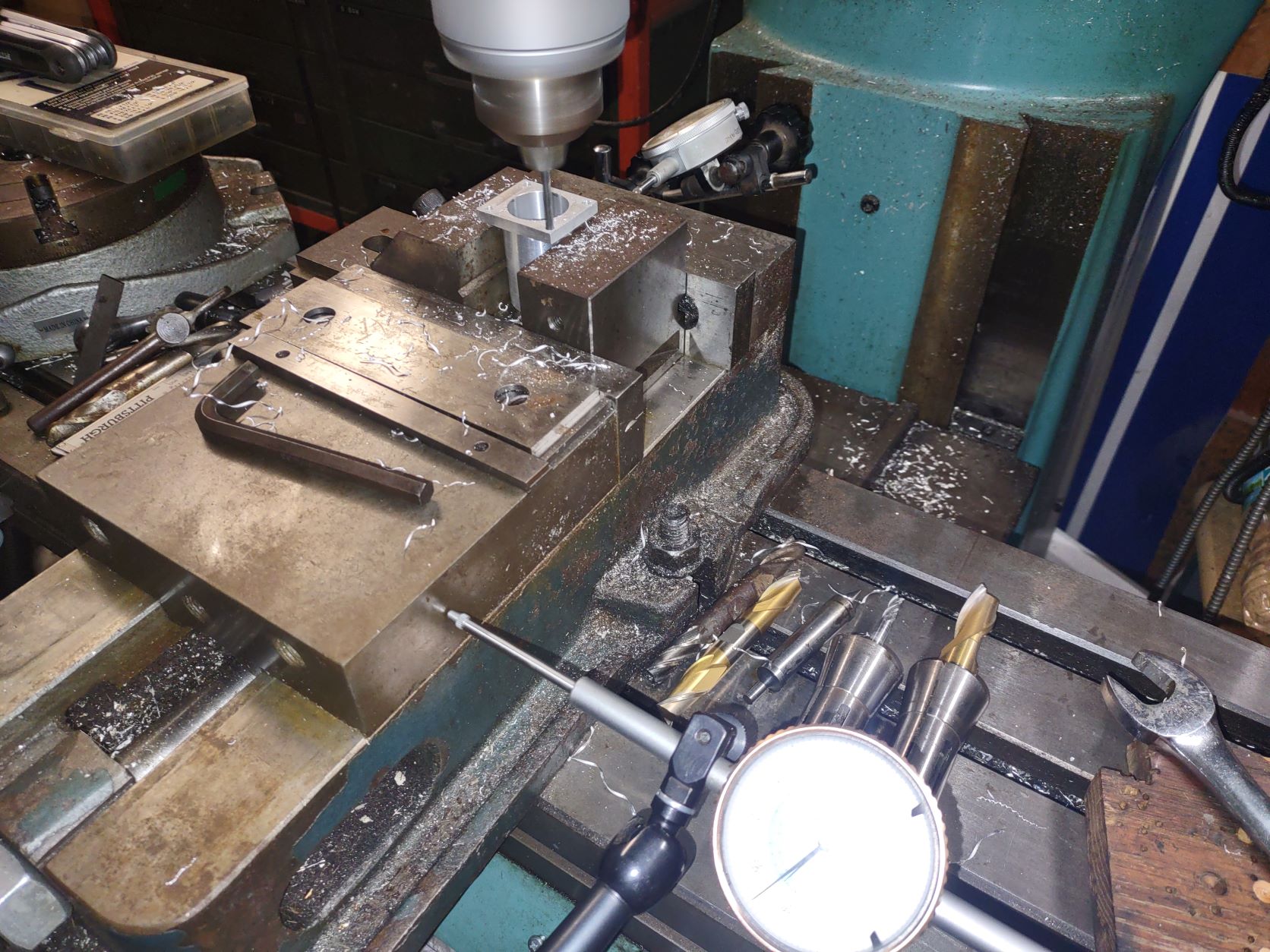

Like I said I used a scrap of 1 3/8" rectangular 6061 bar stock to turn a cylinder, then I bored it to 1", and finally started machining the square hole into the cylinder to hold the prismatic cube. A side note here, when I bought the mill about 10+ years ago it was a manual mill that was in the middle of a CNC conversion. So all of the dial indicators on the X and Y axis had been removed. I had to use a couple of magnetic dial indicators to measure the X and Y travel movements. It was slow tedious work and had me pulling my hair out trying to figure things out. (I've since gotten it working again with Linux)

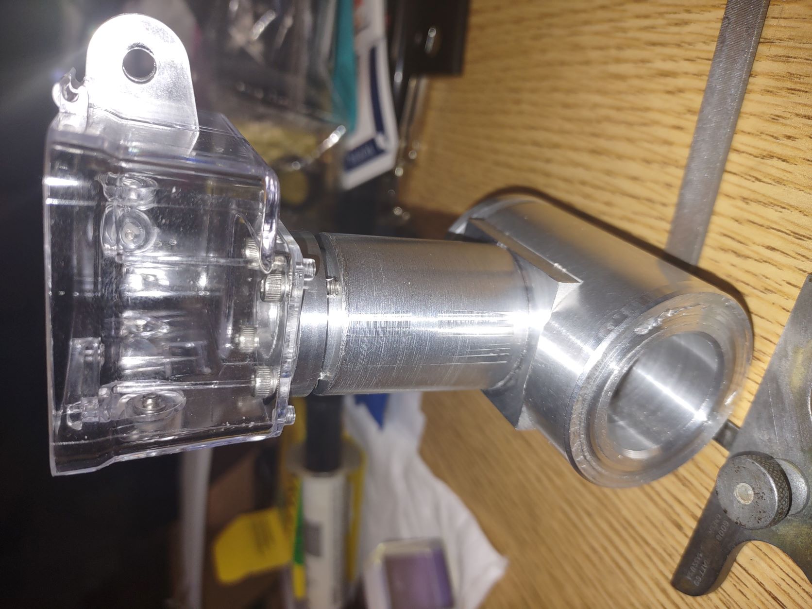

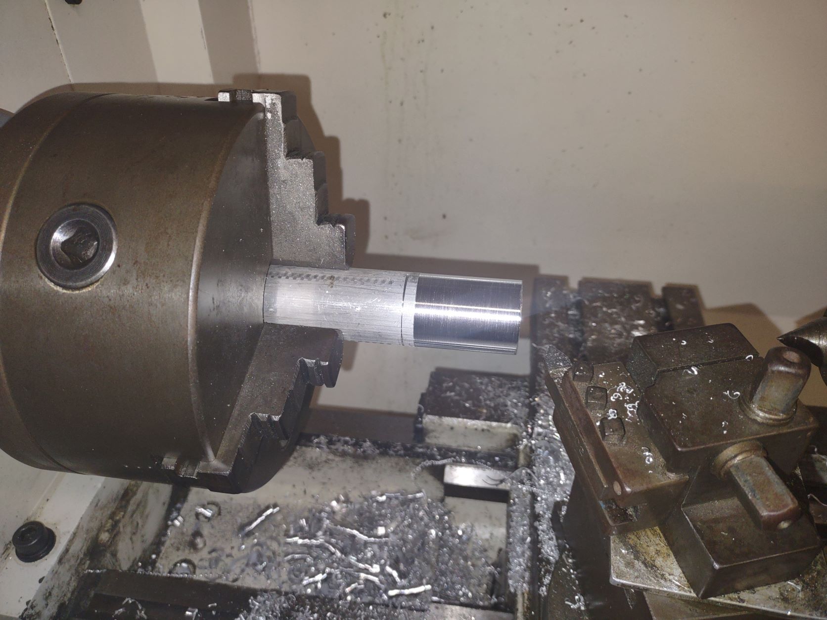

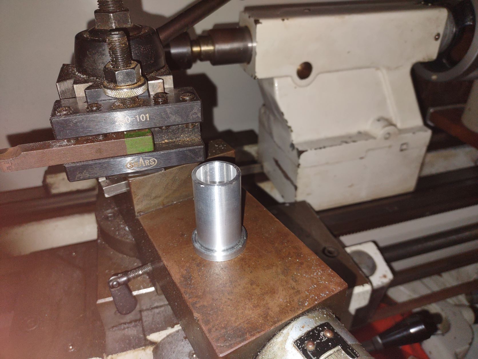

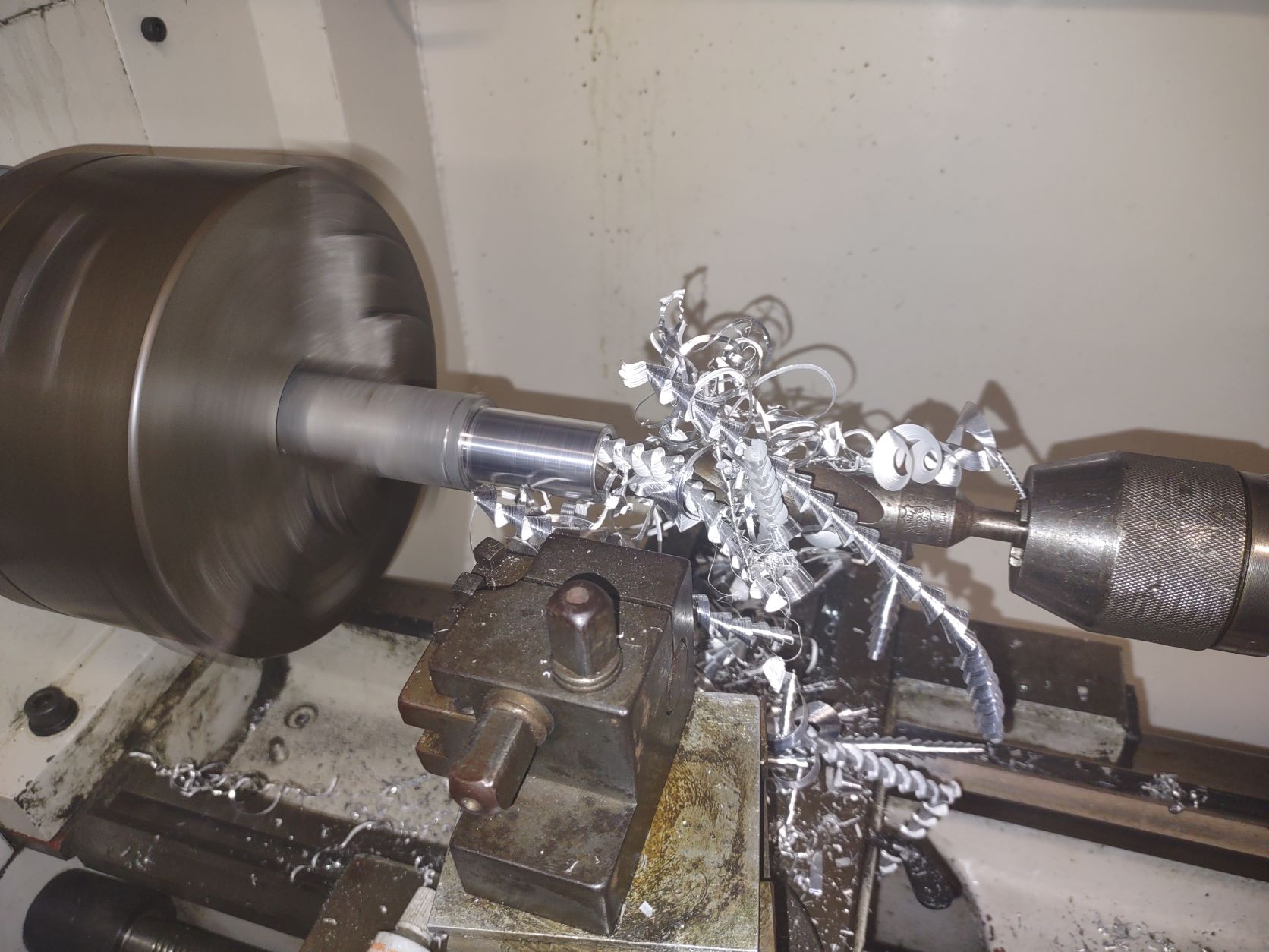

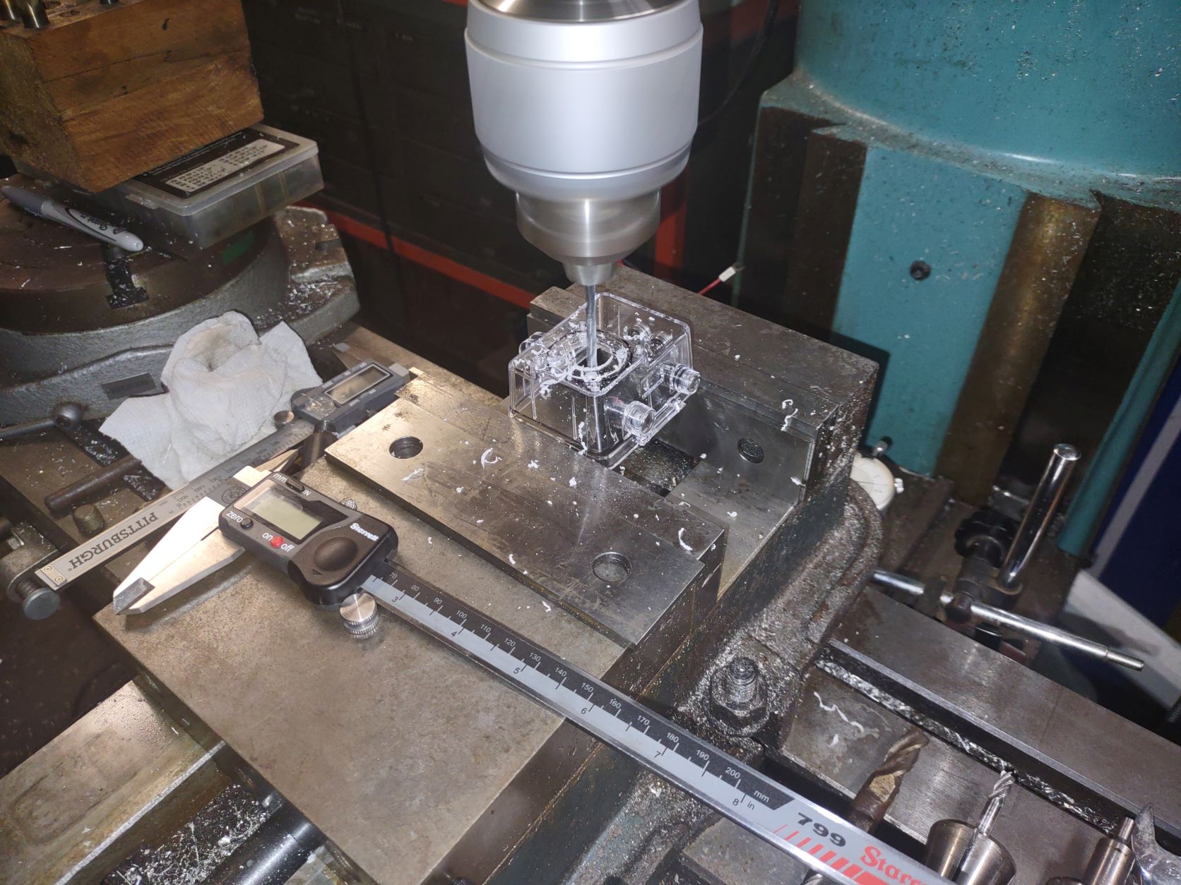

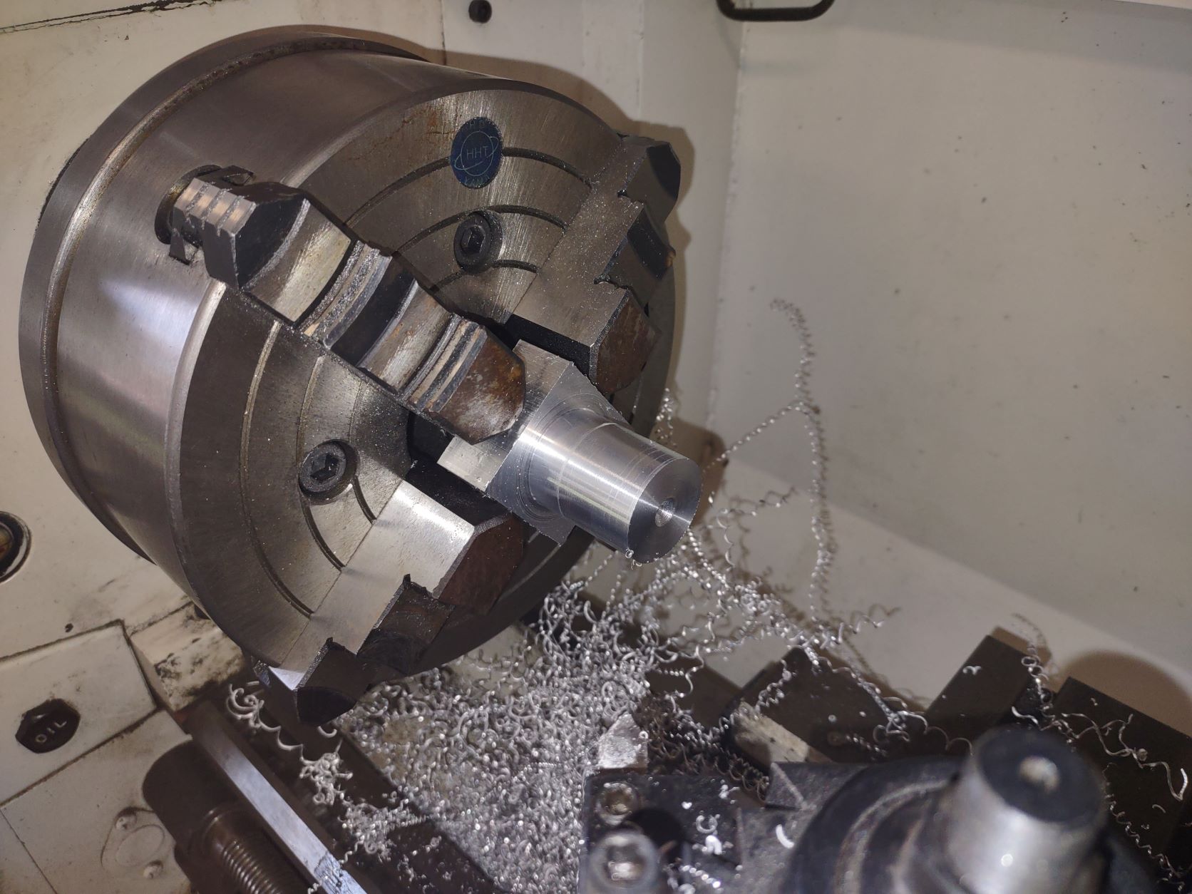

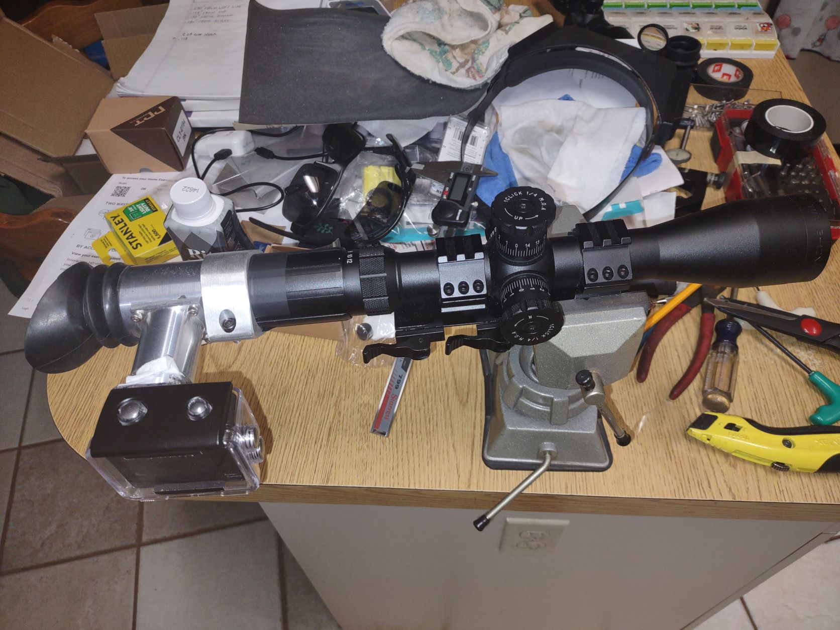

I had no idea what the minimum focal length of the 12mm or 16mm lenses would be, but I knew that I would need to be able to make adjustments if needed. So I decided to make 2 tubes that would fit inside one another. One would mount on the camera housing and the other would mount onto the prismatic cube housing. First is the camera mounting piece I had some 1.25" 6061 rod so I used that. I turned a flange on one end for mounting to the camera housing and bored it.

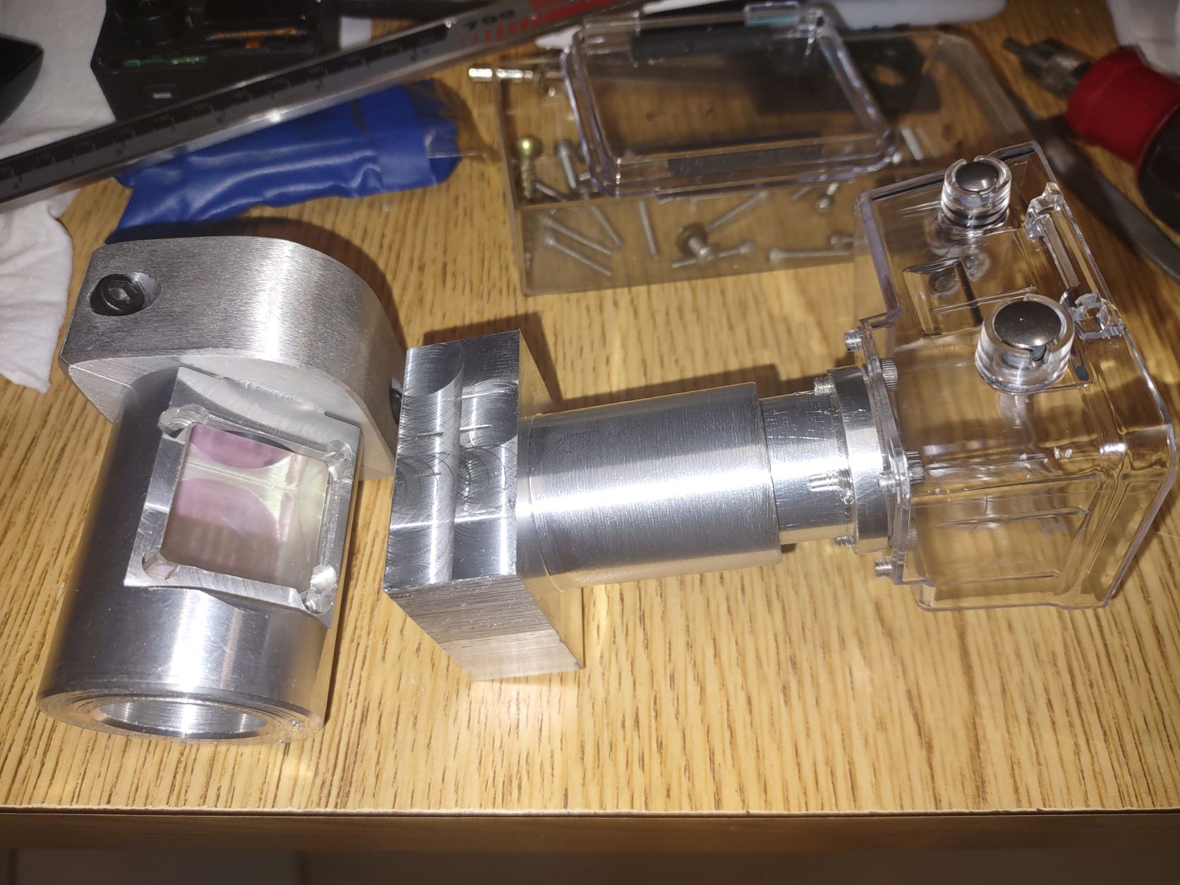

Time to start trying to mount the different pieces together. Luckily I still had a few screws left over from years ago making titanium liner lock folders. First I machined out an opening in the camera housing then laid out the holes for mounting. Yeah, that third pic things ain't going to fit up. Time for more calculations, and machining.

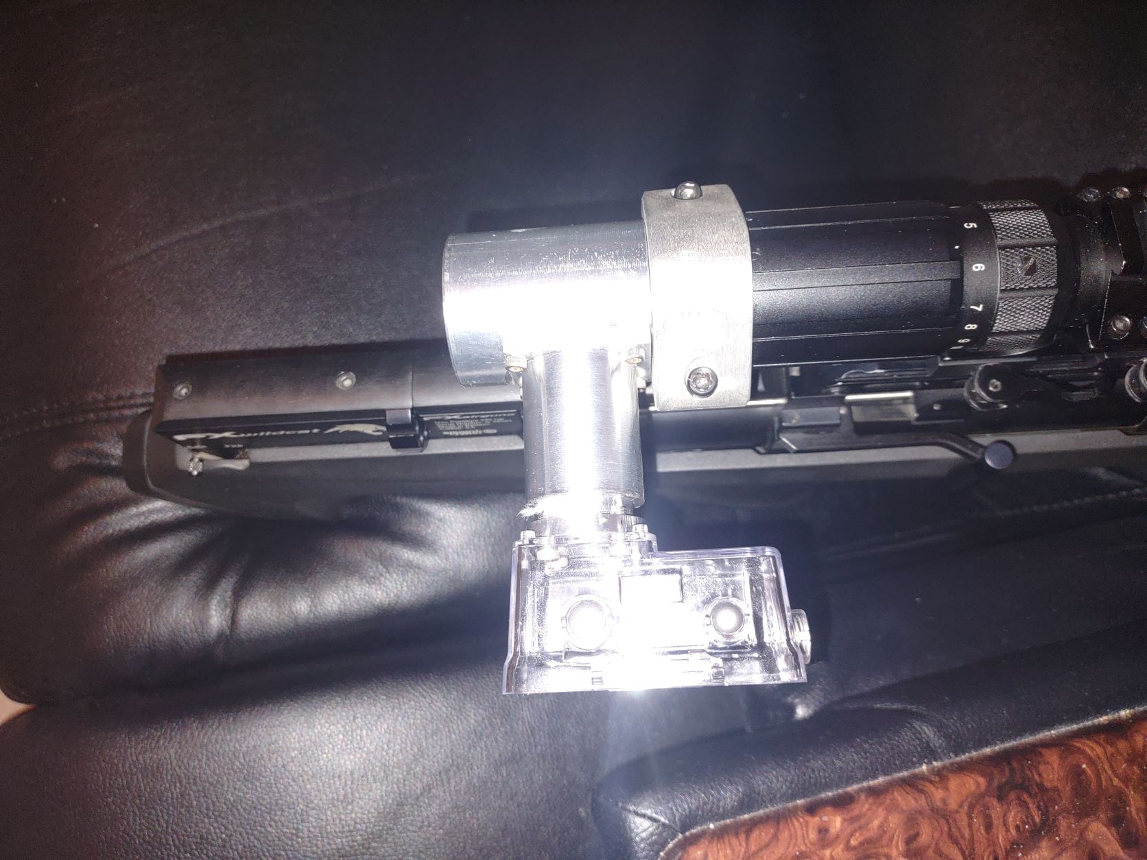

It took a while to figure out how to mount things with the space I had allowed myself. Wish I had the skills to lay all of this out in with Fusion 360, but this is flying by the seat of my pants, make a part see how it looks and move forward again. Also like I said not having any dials on the X and Y axis was really making me pull my hair out. The small piece of tissue in the last pic is just applying friction to hold the tubes together. I hadn't determined minimum focal length yet, so no set screws in place to hold it together.

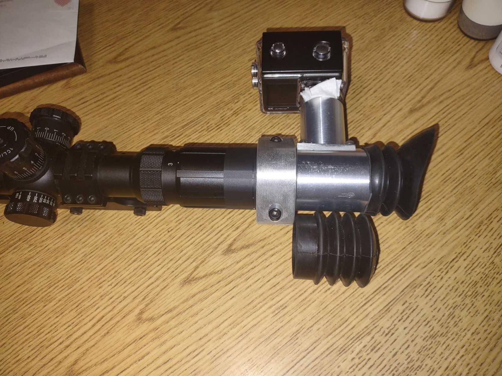

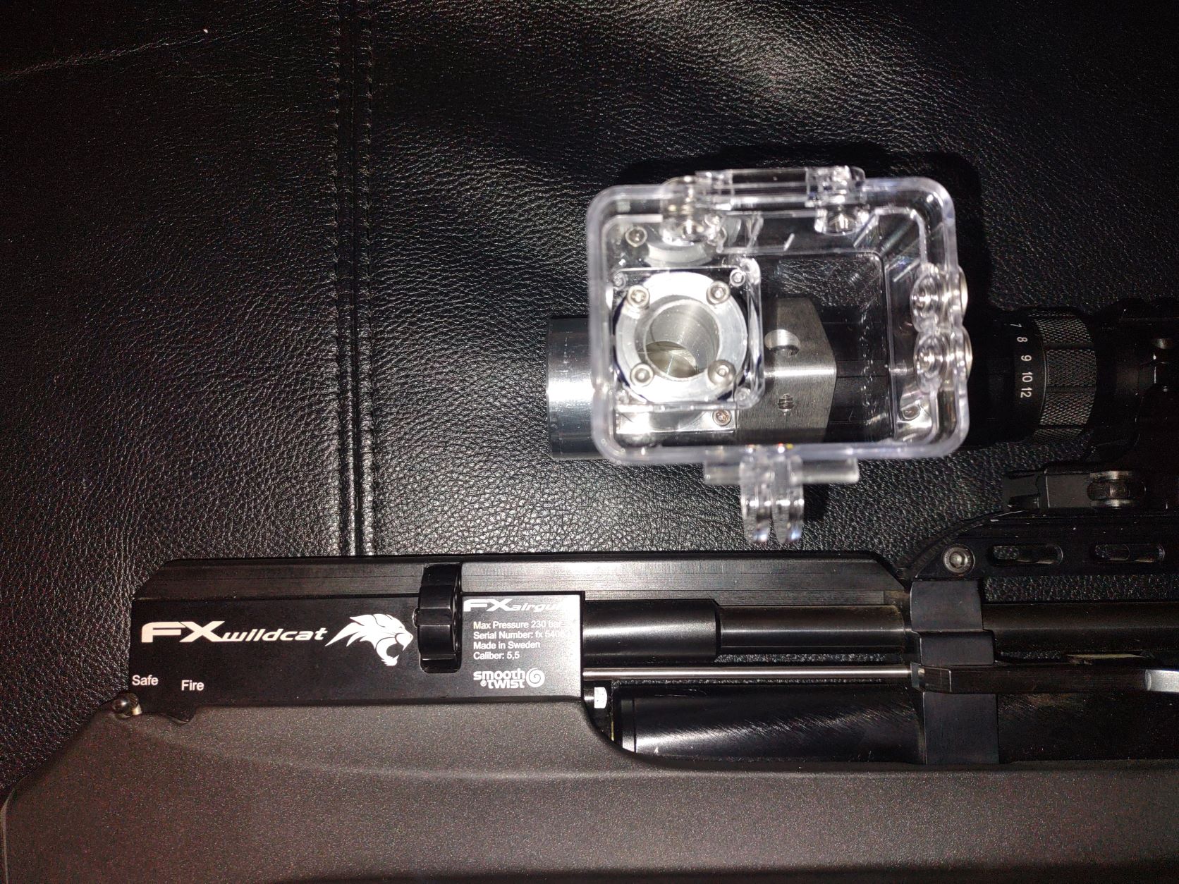

Here are a few more pics of the mounted scope cam assembly. I bought a cheap eyepiece off of ebay and cut it in two. It stretched and fit over the housing perfectly. The sight picture isn't perfect through the eyecup, but it keeps reflected light from entering the back of the scope and distorting the camera image. I guess I never took any of the final assembly. I'll have to see if I have any footage that can be mounted outside of the hunting gate. Like I said earlier, if you have any questions, please ask. I'll try to help if possible.

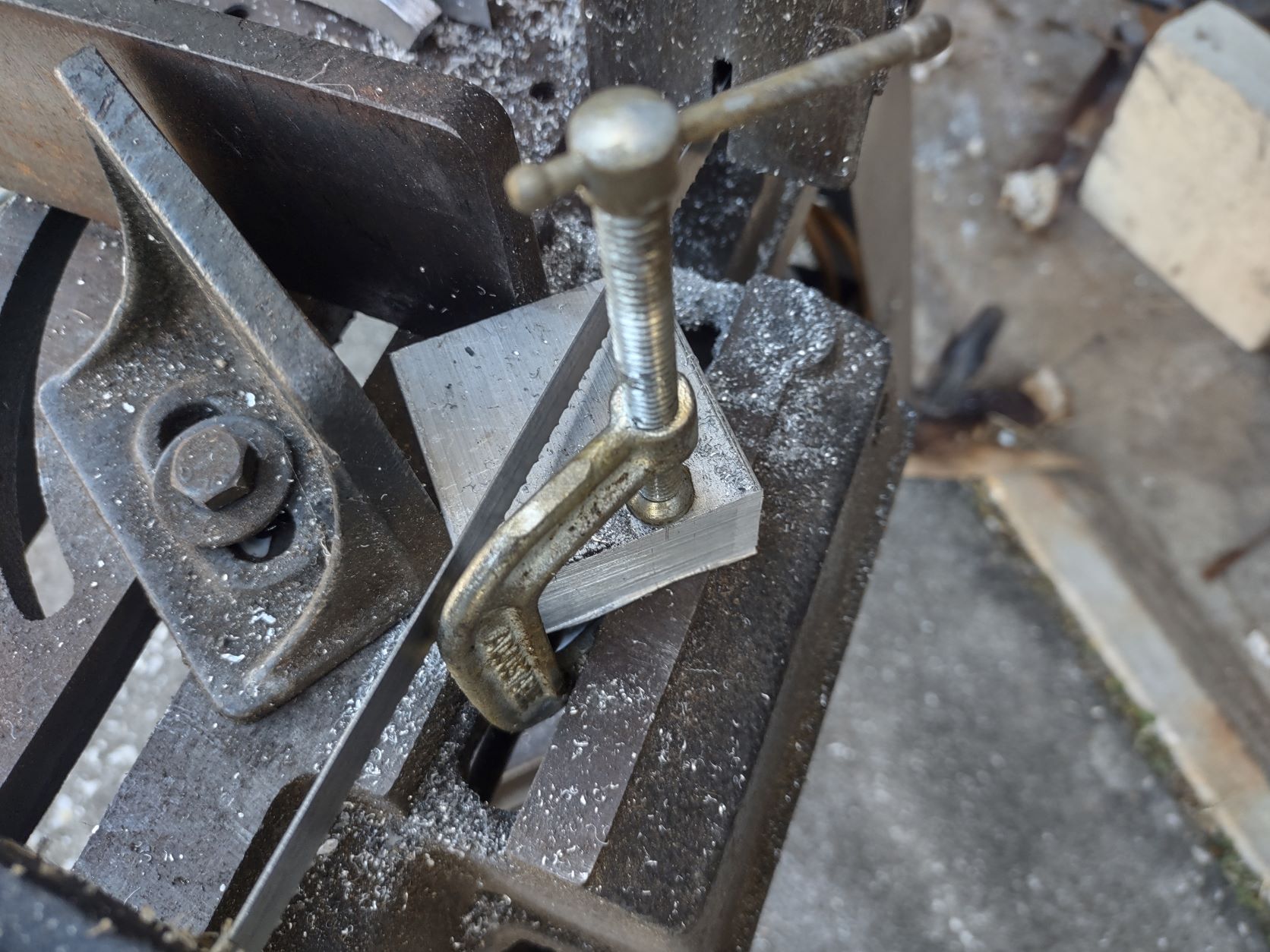

Very nice work and post!!! Nice machine tools and I like the way you clamped the short piece in bandsaw.
Thanks, glad you enjoyed it. Like I said I'm not a machinist. Someone (a machinist) on the other forum posted that it would have been much easier doing the machining on the square piece. Then setting up and cutting it diagonally on the milling machine with a slitting saw and arbor. They were absolutely correct would have saved set up time several time over.
