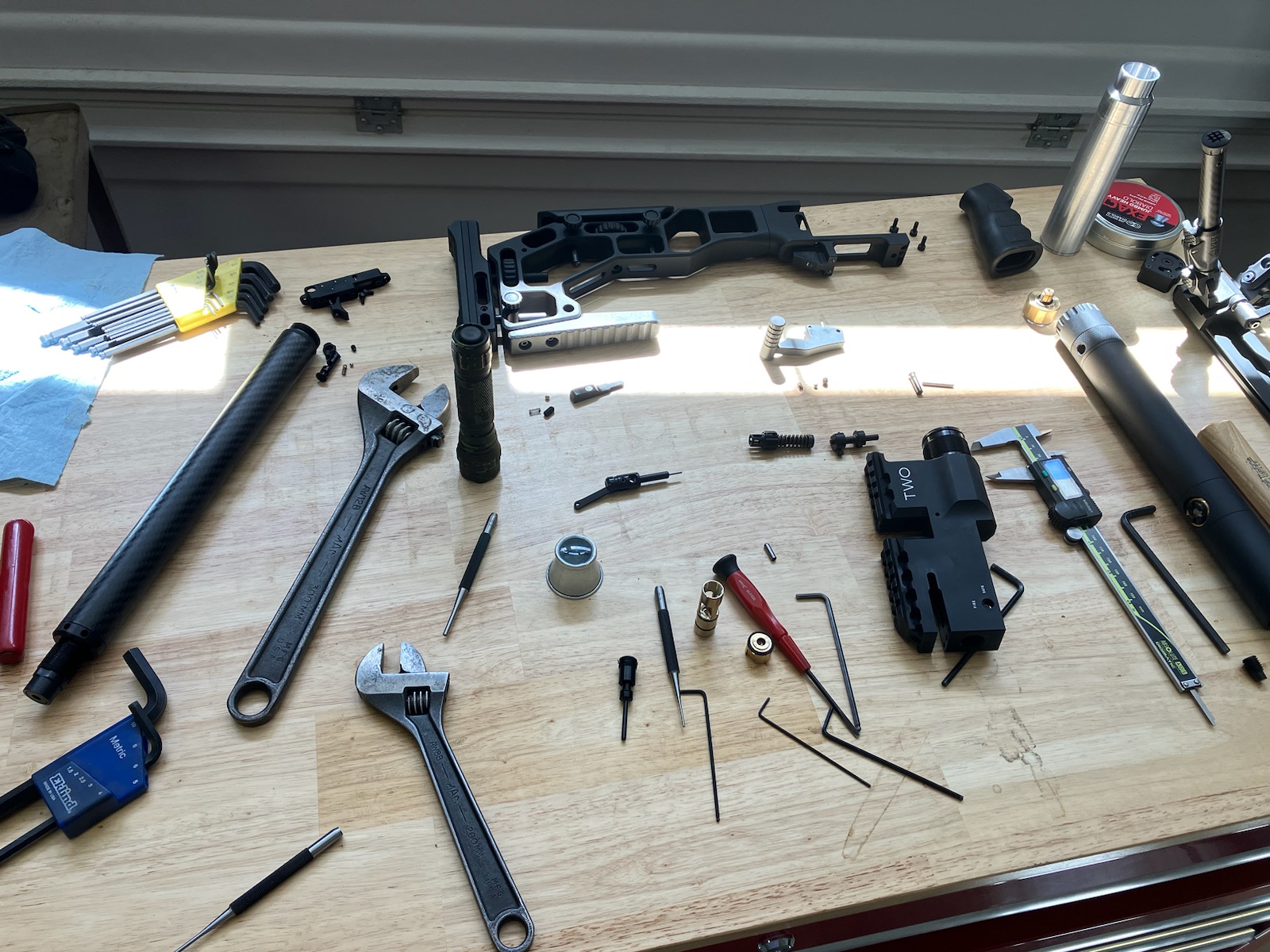

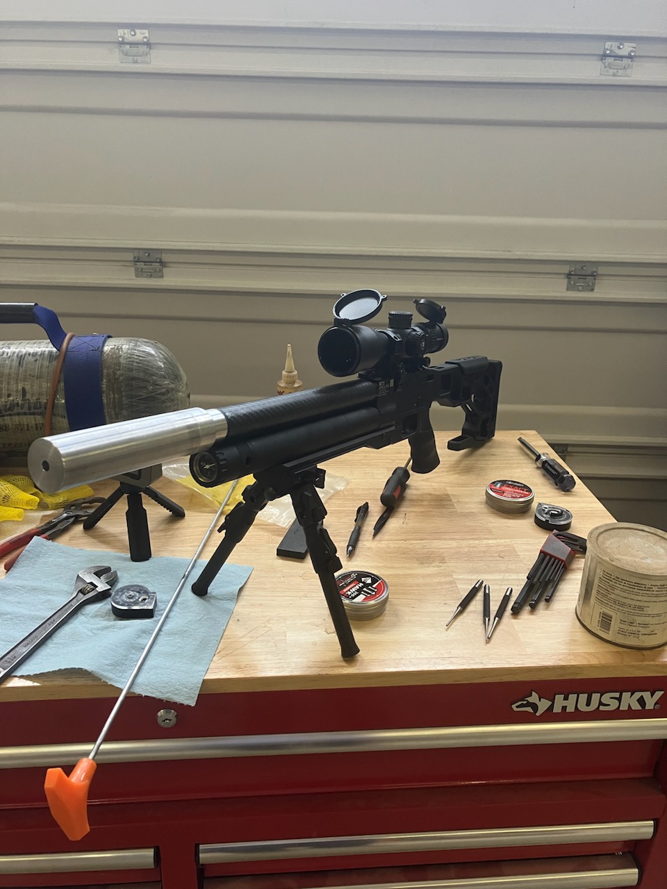

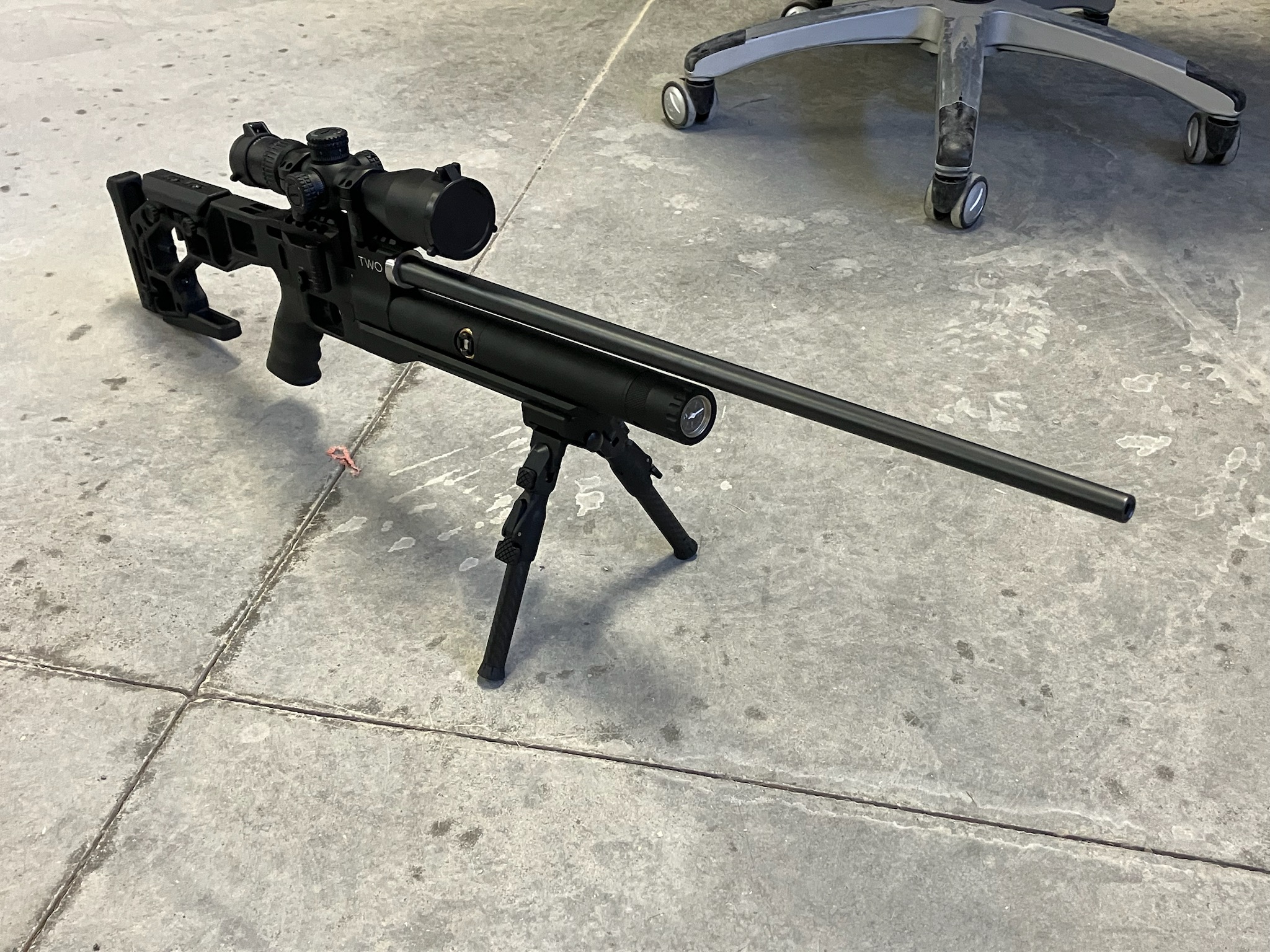

I bought an Epic Two and got a 300mm compact in .22 cal. for back yard fun. Was a little loud so whipped up a moderator. Shoots 18.1 gr JSB prettey good at 910 fps. But I like to fiddle so I took it apart to see what makes it tick. Really impressed with the build quality and hats off to the design. The trigger is a great design but seems the sears are made of some kind of hardend powdered metal that has a rough texture. It could be smoother so I'll hone and adjust it a little, easy fix. So next up I picked up a CZ 457 24" rimfire barrel on ebay for $90. I have a CZ 457 and know the barrel is a super tight rimfire barrel. The bore is .212 and the groove is .220 with a 1:16 twist. Going to try it for pellets before I swage some custom slugs. I fit the barrel and velocity went up to just under 1100 fps with the 18.1 gr and 950 with the 25.4 JSB. Now I need to hush this monster down. My ears are still ringing!

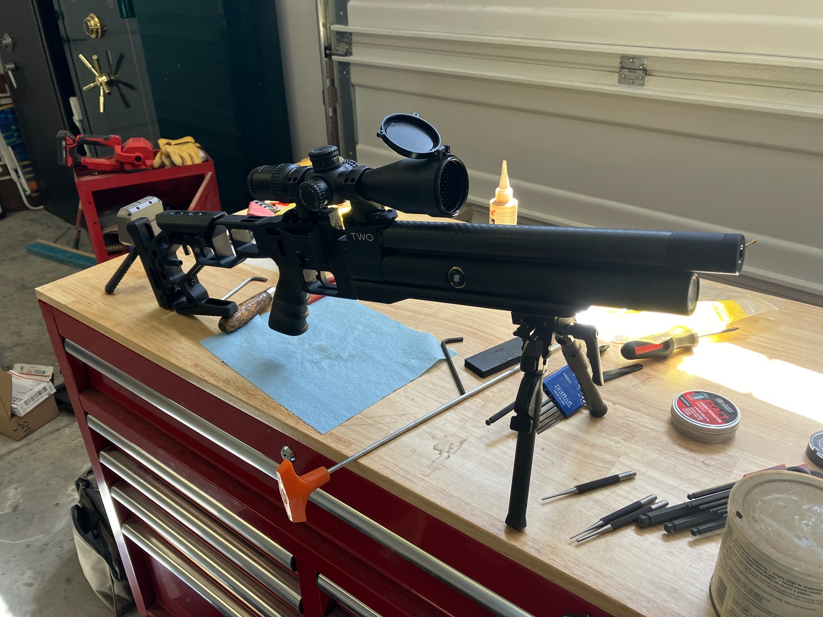

I am a bit annoyed with the way you have to take the valve out the back, it is also a bit fiddly but probably the way it have to be.
Also that you can not adjust the return thing from the front after having removed the pipe, it look as if you only need to remove a little to be able to get a ball end HEX in that way to adjust.
My valve return are set flush with the end of the valve housing ( 700 mm barrel ) no idea of jet size what ever it came with.

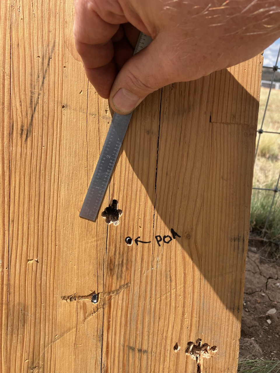

Put the 300 mm barrel back on and played with some 18.1 gr JSB at 920 fps. This is 22 shots at 40 yards with 5-8 MPH winds and is about .60" ctc. Not great but that's why this is my epic adventure.
One thing I did notice on disassembly is no oring on the barrel anywhere
It is supposed to do that, i fell for it too, it is air that get funnelled back in the shroud from the front, it get ventilated in the 4-5 mm holes in the back.
I never had a rifle that vent into shroud like that, but as i understand it is not uncommon.

BTW when shot enough you will see a little lead dust on the air pipe where it is close to the tightening / vent holes.

.08 confirmed by Dave at Epic.
