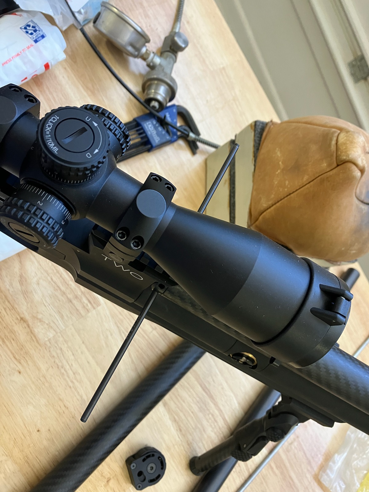

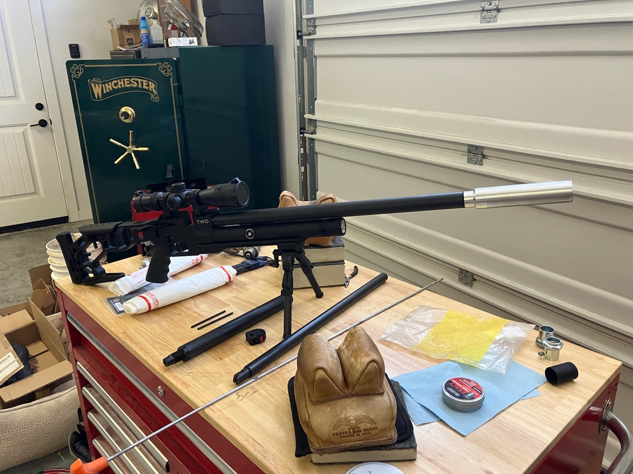

Well the 550mm barrel came in. Its a CZ barrel. They say no choke but .2140" pin goes in the chamber and does not in the muzzle. I'll look into it further but that what I got so far. With my moderator it comes in at 46" long. I had a couple 5/32 extended drills and cut the flutes off and have no problem swapping barrels. If you use two of them its easy. I have some work to catch up on so can not shot it today but will post what I think about it ASAP!

Well I got around to shooting it with the 550mm CZ .22 cal barrel. I was excited to try a few the pellets and slugs I have laying around. The Hawki Thunder, Huben Peanut and vintage Daystate Rangemaster failed badly and groups were about 1" at 40 yards I dont think any two pellets touched each other. I have it sighted in at 50 yards so the groups are a tad high at 40 but the tried and true JSB RDM 25.39 at 950 fps came in nice and tight. I might try to tune for the other pellets later but am happy with the JSB for now.
The 300mm barrel with 18 gr Jsb at 925 fps did OK but the 550mm barrel with the 25.39 Monsters did better. It won't win any matches but I'm happy with the Epic Two so far. Just a joy to shoot.
