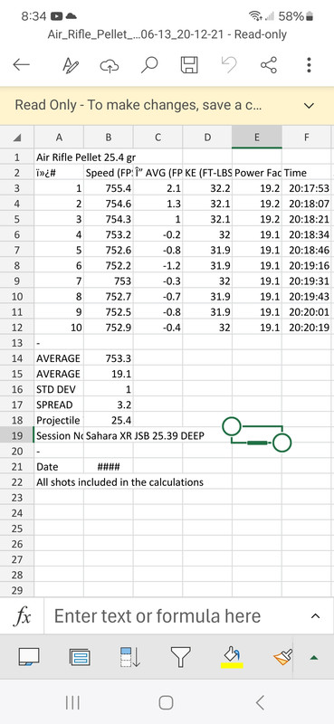

This thing is a sweet shooter! Next order of business was to try different pellets and get some chronograph data.

Grabbed some AEA pellets and JTS 25.39s. This was very eye opening to me bc up to this point, whatever I fed the Sahara XR, it shot pretty well. It did not like the AEA 25.3 gr pellets. It did ok with the JTS 25.39. I shot 20 rounds of each just to make sure. The AEA 21.9 and 18.3 did a lot better, although the 21.9 did have a flyer. I decided to do a 10 shot group with the JSB 25.39 just to make sure nothing was off. Before I shot those, I had already taken 60 shots, which my concentration was waning. The JSBs stacked 8 of the 10 in a little cluster and it was immediately noticeable just how important picking the right pellet is. Mini pellet test:
