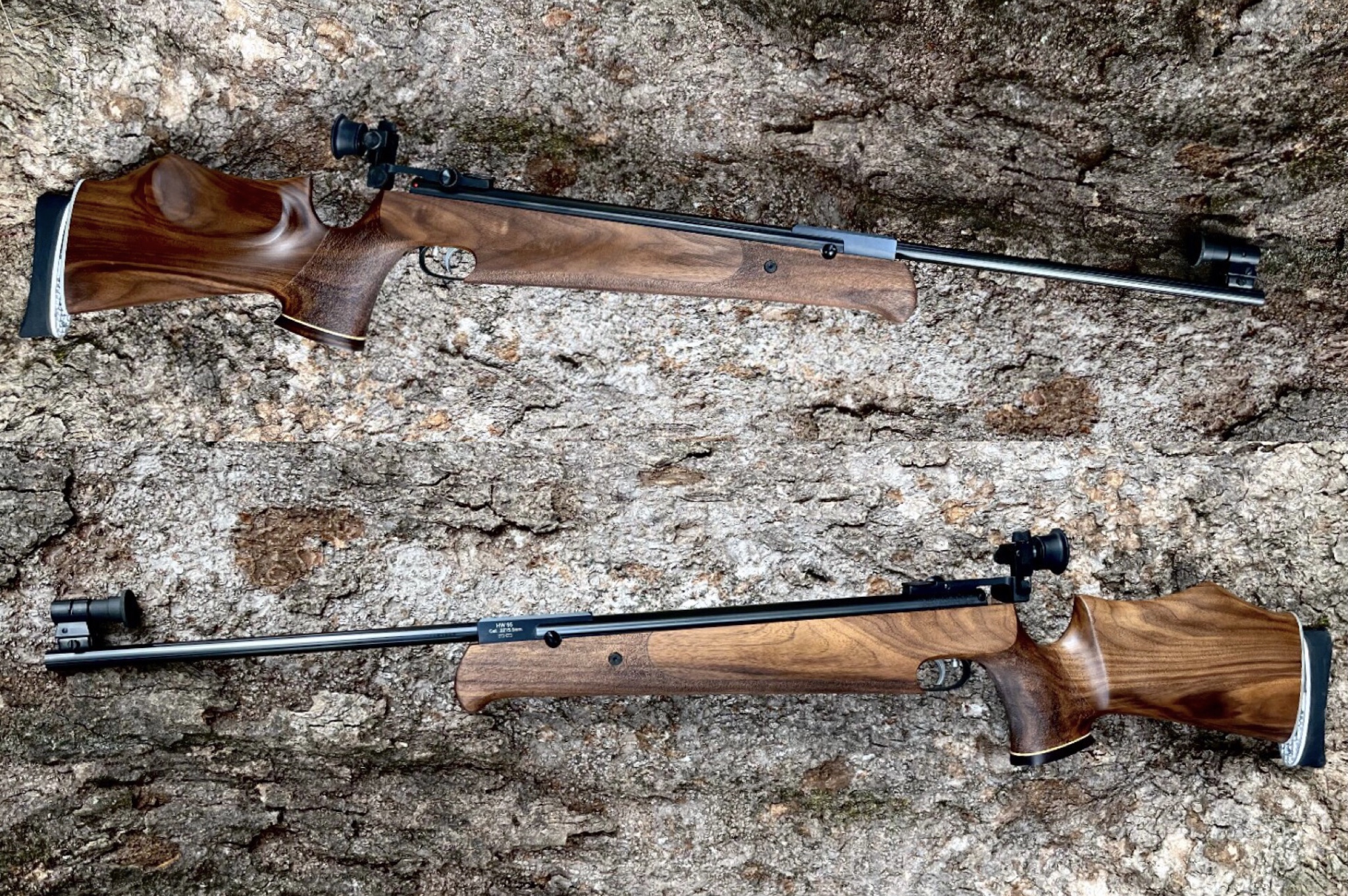

HW95 .22 caliber. Absolutely my favorite springer I have ever owned. And owned Weihrauch’s for over 40 years. Liked it so much I spent the money for a custom stock. Set it up with a Weihrauch diopter. Possibilities are endless. Welcome to people who love to spend other people’s money. I primarily shoot CPHP. It loves them and they’re cheap, like me.
That is really beautiful. How much does that custom stock cost?

HW95 .22 caliber. Absolutely my favorite springer I have ever owned. And owned Weihrauch’s for over 40 years. Liked it so much I spent the money for a custom stock. Set it up with a Weihrauch diopter. Possibilities are endless. Welcome to people who love to spend other people’s money. I primarily shoot CPHP. It loves them and they’re cheap, like me.View attachment 377857

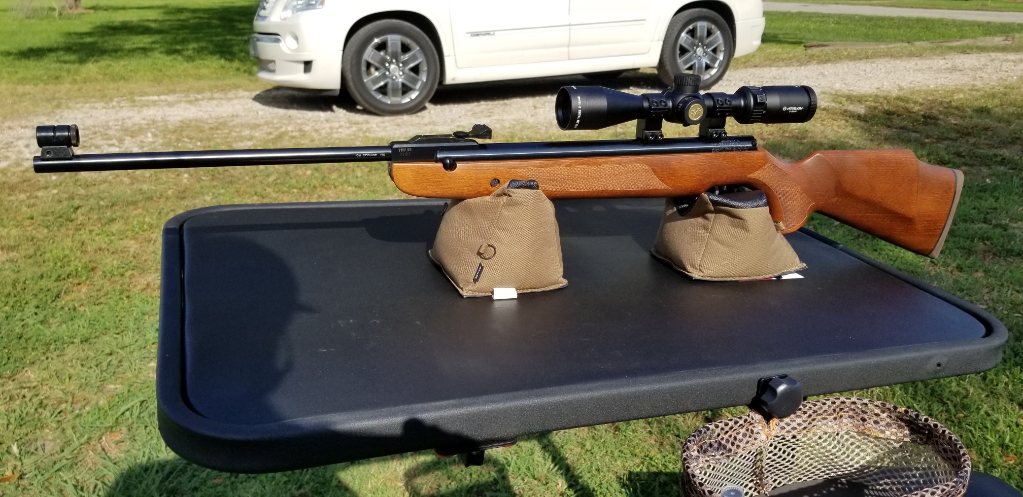

I think most of us here use Sportsmatch rings. They’re my first choice. They have one and 2-piece mounts. Depends on your preference. They have a high and a medium height generally. Most people shoot medium height. I switched to high because it helps me now that I quit wearing contacts and shoot in glasses. And rings diameter will need to match scope diameter. So many scope options. Athlon and Hawke make good scopes at reasonable prices. Lot of others. 3-12 or 4-14 is probably all the magnification you need for that gun. I have a 3-12 x 40 Athlon and it’s great on that gun. Light weight is a plus. Not sure where you bought your rifle but Airguns of Arizona is the HW distributor in US. They can help you pick a scope and rings. As could Pyramyd Air and many other places. If you don’t know how to mount a scope it would be worth taking somewhere and letting them mount and fit to you if you can. This is my 95 Luxus with Athlon 3-12 x 40 on Sportsmatch 2 piece mounts. I like the ones with 4 screws for the rings, not 2.

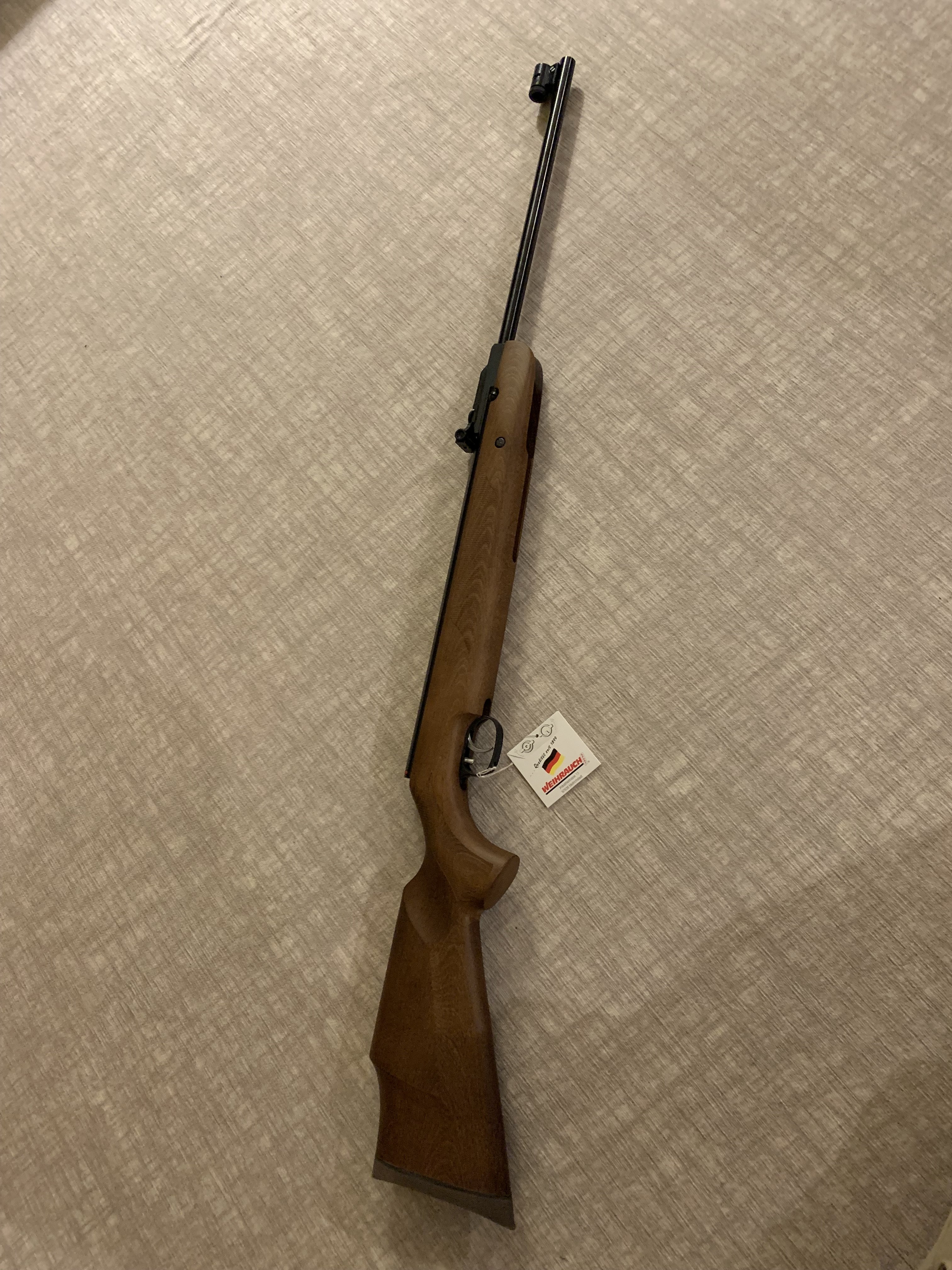

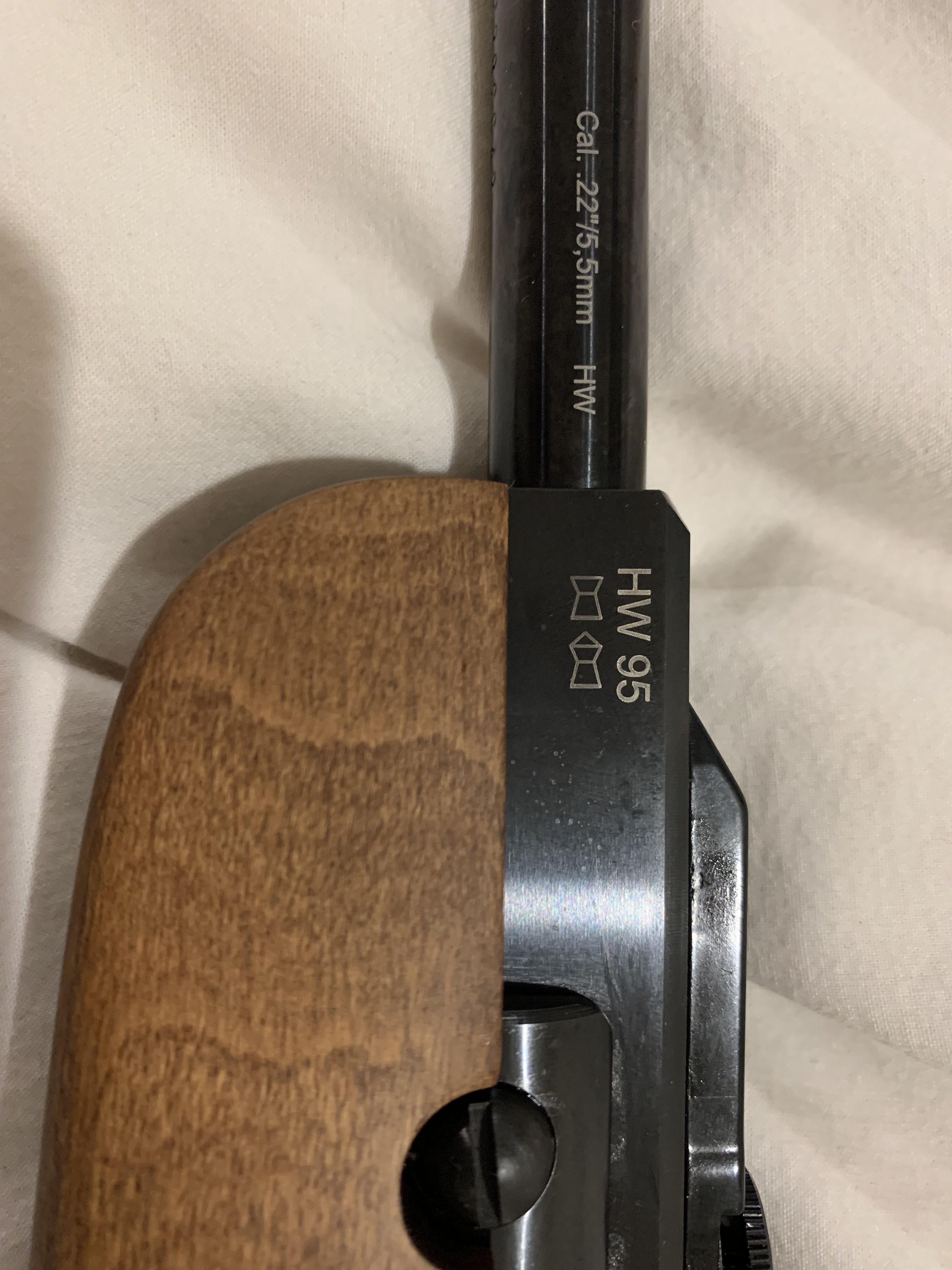

Bought my first air gun! Read through a lot of previous posts! Having only shot a 66 powermaster, this is a huge upgrade!
HW95 .22
Nice choice! My first springer was a Weihrauch. I have an HW98 in .22 and a .177 HW50S. Beautiful rifles. The 95 in .22 is next on my list of must have springers.
Reactions: Bean

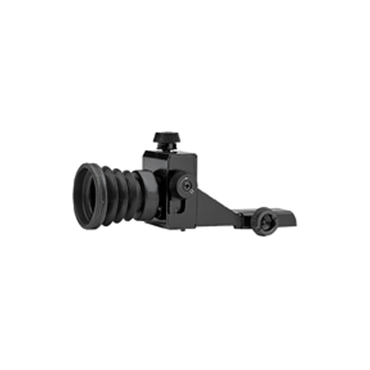

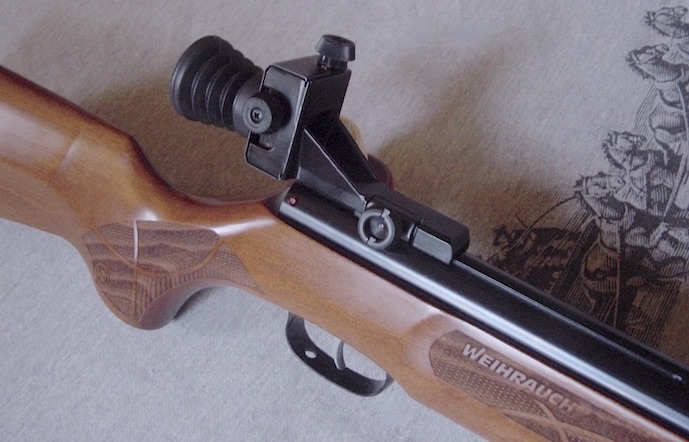

If you're interested in a diopter sight for your 95, the sight that comes with some of the Daisy/Avanti match rifles is available separately and is a perfect fit on the Weihrauch break barrel springers-
I mounted one on my HW50S and it works great. It does require a recoil stop roll pin, but installing one on the underside of the sight is a simple job.
How do you install the stop pin? Is the sight cut for it?
Reactions: djna

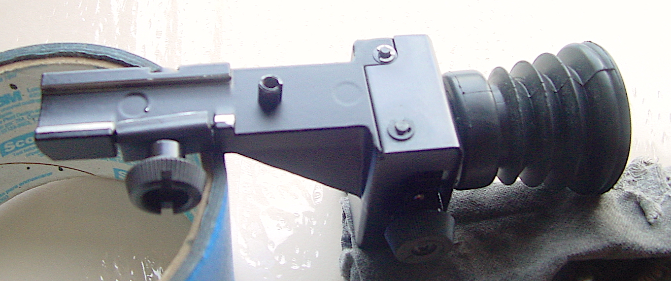

You'll need a 7/32" drill bit, a 7/32" x 3/8" roll pin, and a center punch. Figure out where you want the sight to sit and mark a spot on the underside of the sight that aligns with one of the three stop pin holes on the gun. Then find the center, mark it, center punch it, and drill a 7/32" hole 1/4" deep into the underside of the sight being careful not to drill all the way through. Insert the roll pin in the hole and grind it's length down until the sight will sit squarely on the rail and the pin reaches the full depth of the recoil stop pin hole on the rifle. A drill press is preferable, but it can be done carefully with a hand drill. The sight body is aluminum so it drills easy.
When done it should look like this-
