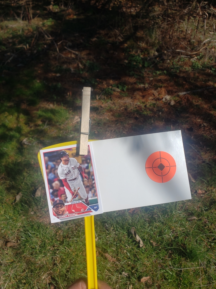

Use a 50m measuring tape and then something like this every yard to mark your sidewheel:
The yellow piece is just a planter and the baseball card is used to focus. The note card and target is pretty self explanatory. I think I bought enough of all of that to go every 1/2yd on Amazon for like $30.
I like to zero at 30yds for no other reason than every single practice range I have been on has had a target setup at exactly 30yds. It works out well though because the shot is basically flat from 17-32yds with that setup and the 10-17 yarders aren't too steep.
Mark your side wheel every yard from 10 to 20-22’ish and figure out your sight setting for each. There is a lot of sight adjustment from 10 to 20 and the kill zones are small at those ranges. Easy shots if you know your range and sight settings. The rifle will shoot fairly flat out to 35 yards, assuming you are sighted in at 30. Past 35 mark your wheel every few yards out to 55 and figure out sight settings for each ranged you marked. Take you time marking your ranges on the side wheel. That’s kind of the foundation for everything else. The HW98 is a great rifle. it should work well for you once you get the scope and sight settings figured out.
