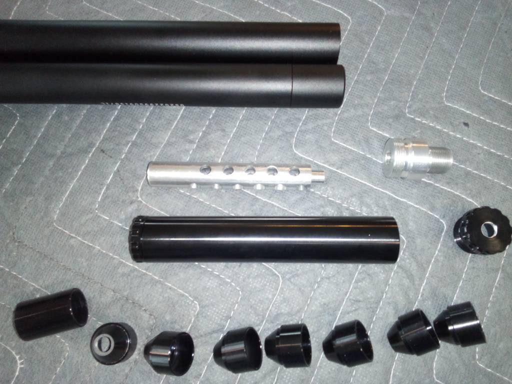

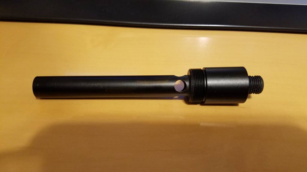

1> I made adapters/air strippers to replace the shroud cap, and to mount my moderator. I studied the Donny's, and turned my own version on my lathe (I have a small machine shop in my garage) Mine goes over but doesn't touch the barrel (harmonics always comes first in small bore!)
2> I purchased a 1-1/8 x 6" "blank" moderator kit for a 22lr, but built it to .30cal specs inside. Bigger thru holes work better in air....I found it's controlling volume of air, not heat and explosion from powder that these rifles like!...see above.

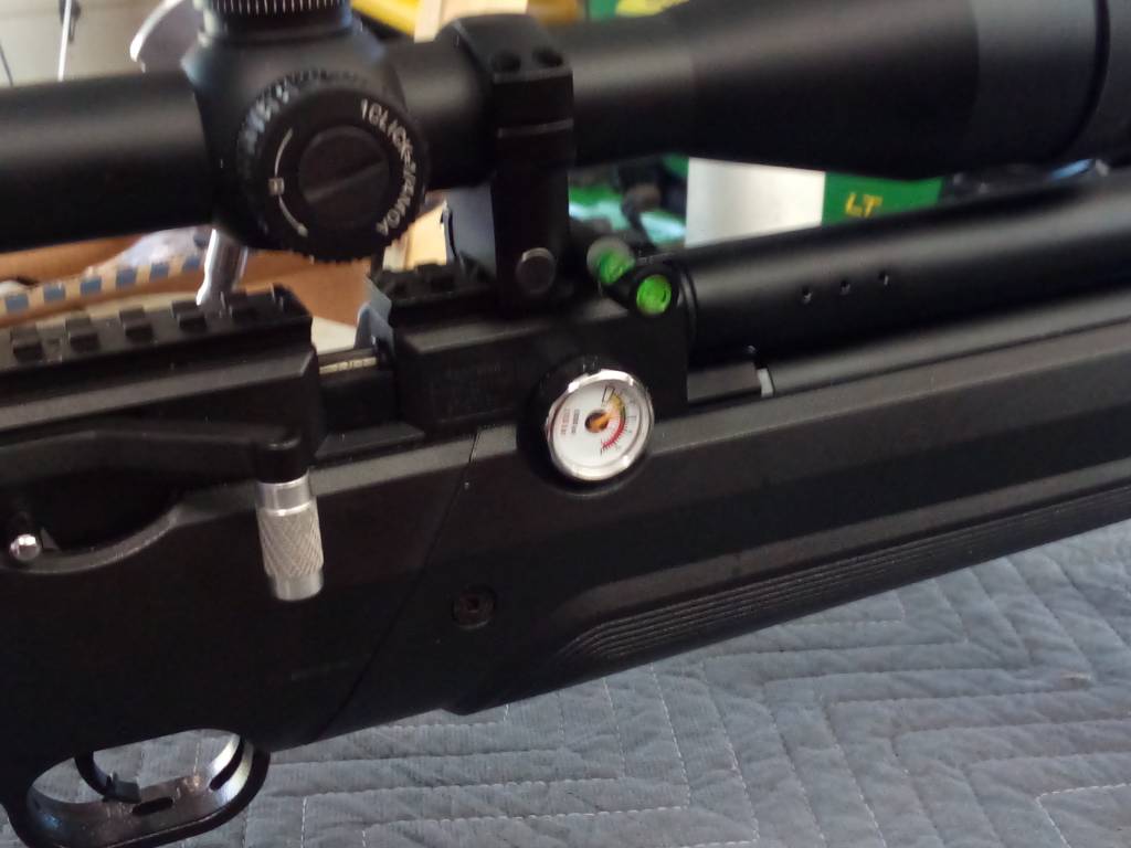

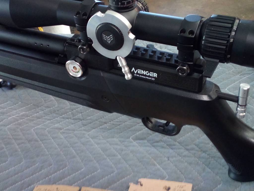

3> I drilled (6) 3/32" holes...3 on each side of the shroud 1" above the rear mount see below. This made a huge difference in settling the gun, removing fliers, and controlling sound. Got rid of the "snap" and now it's a "thump" so to speak. Here you can also see the hammer spring t-wrench that makes adjustments MUCH easier. used electrical shrink tube to fatten up the Allen key I epoxied into the 3.8" turned aluminum bar. Check out the bolt knob, and focus wheel I turned for the SwampFox Patriot 6-24/50 scope. GREAT scope BTW! Steel rings of course!

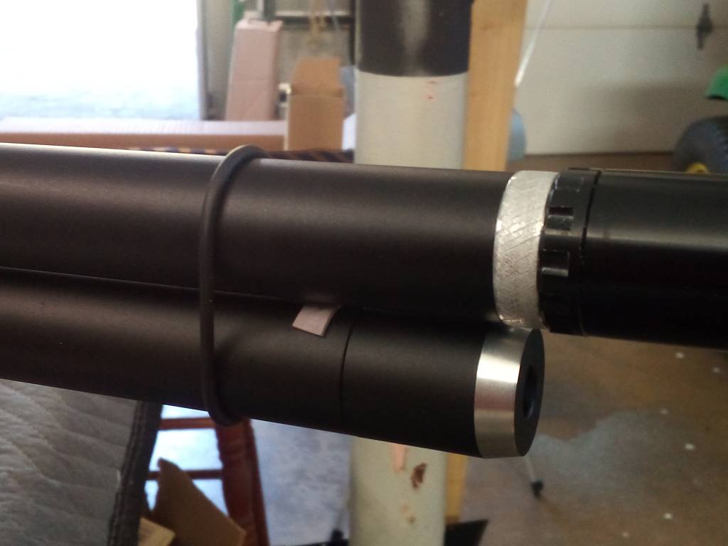

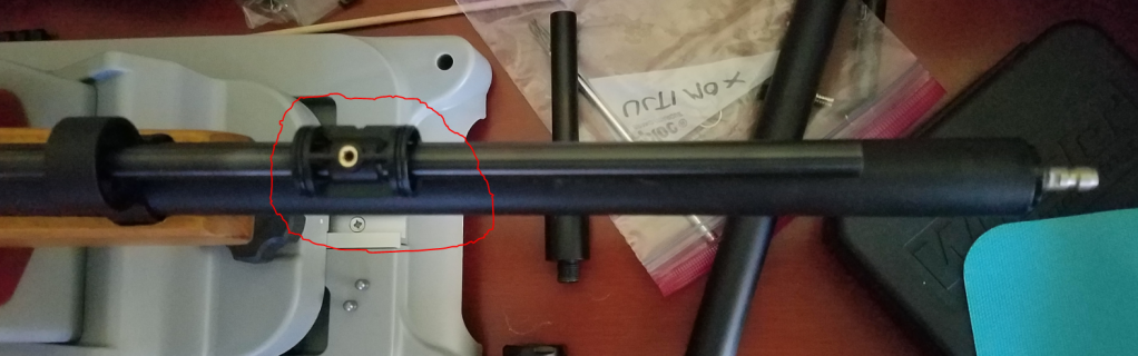

5> Secured the shroud to the air tube just behind the air fill cap with a rubber spacer (0.040" thick rubber band, yours may be different) between them, and a large o-ring around both to stop them from slapping together under recoil. This was giving me fliers, but an easy fix! It also "quieted" the harmonics. Just DON'T flex the barrel shroud when doing this. It will alter your P.O.I. Yup I turned the fill cap to match...Style and all

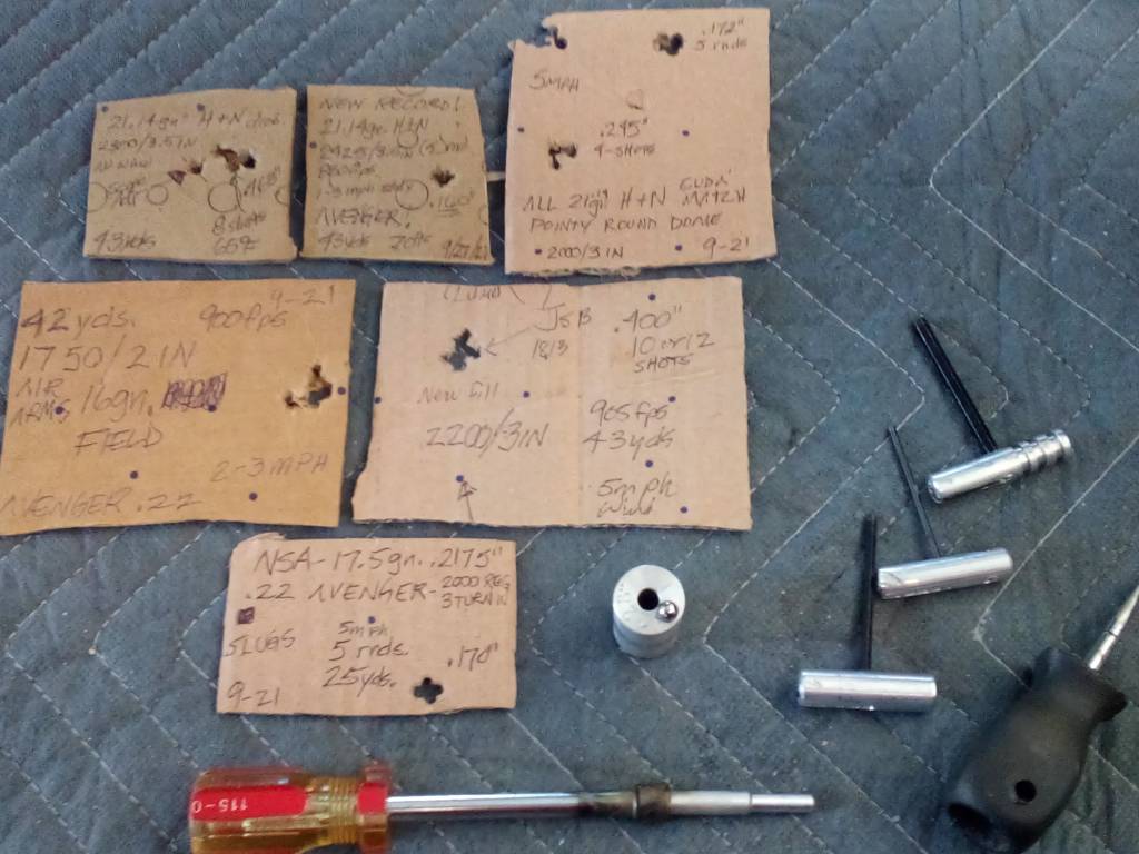

MY Tunes...Basically just do what Steve tells you at AEAC which is spot on, but here's what mine likes anyway...I start all of them at 25yd til one hole, then out to 45yd, then 75yd, (it's how my trees are laid out for targets) I'm at 75yd to this point.
Adjustments are XXXXpsi on reg./number of turns in on hammer spring from all the way out. I'm a benchrest shooter mostly...
1. Air Arms, and or JSB 15.9gn diobolo 1800/2.5 gave me 905fps and best 5 shot group of .385" at 75yd. JSB shoots 1" higher WTH?
2. H&N 21.14 Cuda Match pointy diobolo 2400/3.5 yields 880fps with a 5 shot group at .163" at 45yd. and 8 shot .680" at 75yd.
3. The rifles favorite food is JSB 18.13gn diobolo 2000/2.0 at 865fps and a rediculous group of 12 shots into .285" at 45yd. I didn't want to stop! I lost light tonight and didn't get to shoot these out to 75yd. I usually get a "no breeze" hour in the early morning and again before dark. I shoot out of my garage/shop below into my back yard and can stretch it out to maybe 150yards. 25y on the right wood pile, 45y to the Cherry tree strump center, and way down left is the 75y on another wood pile. Did I mention we have a few trees around here in the Philly farm burbs of S.E.PA.? It's nice tho!
