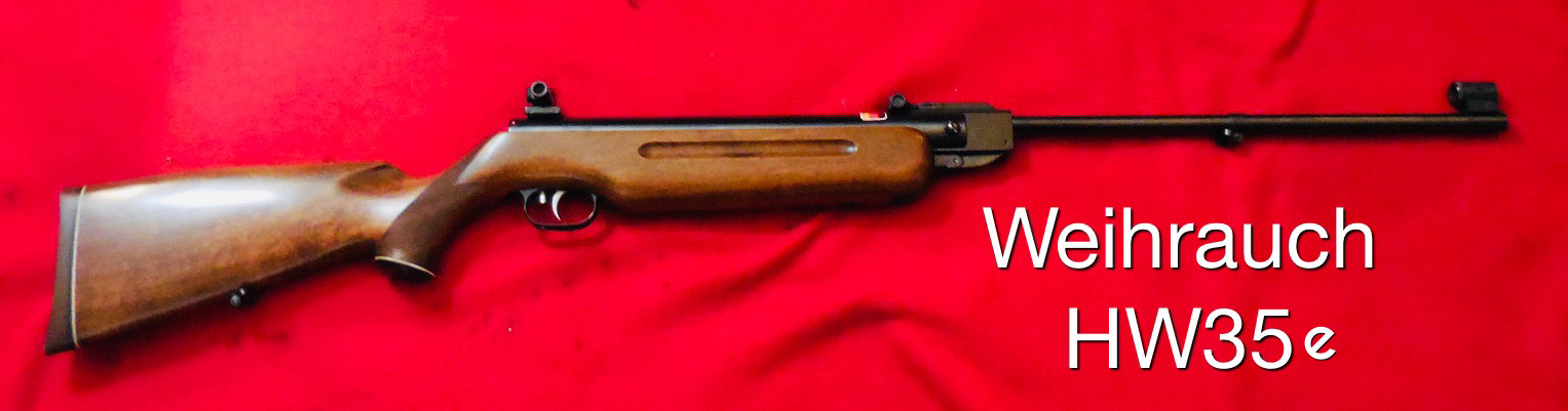

HW/Weihrauch My first springer. HW 35e

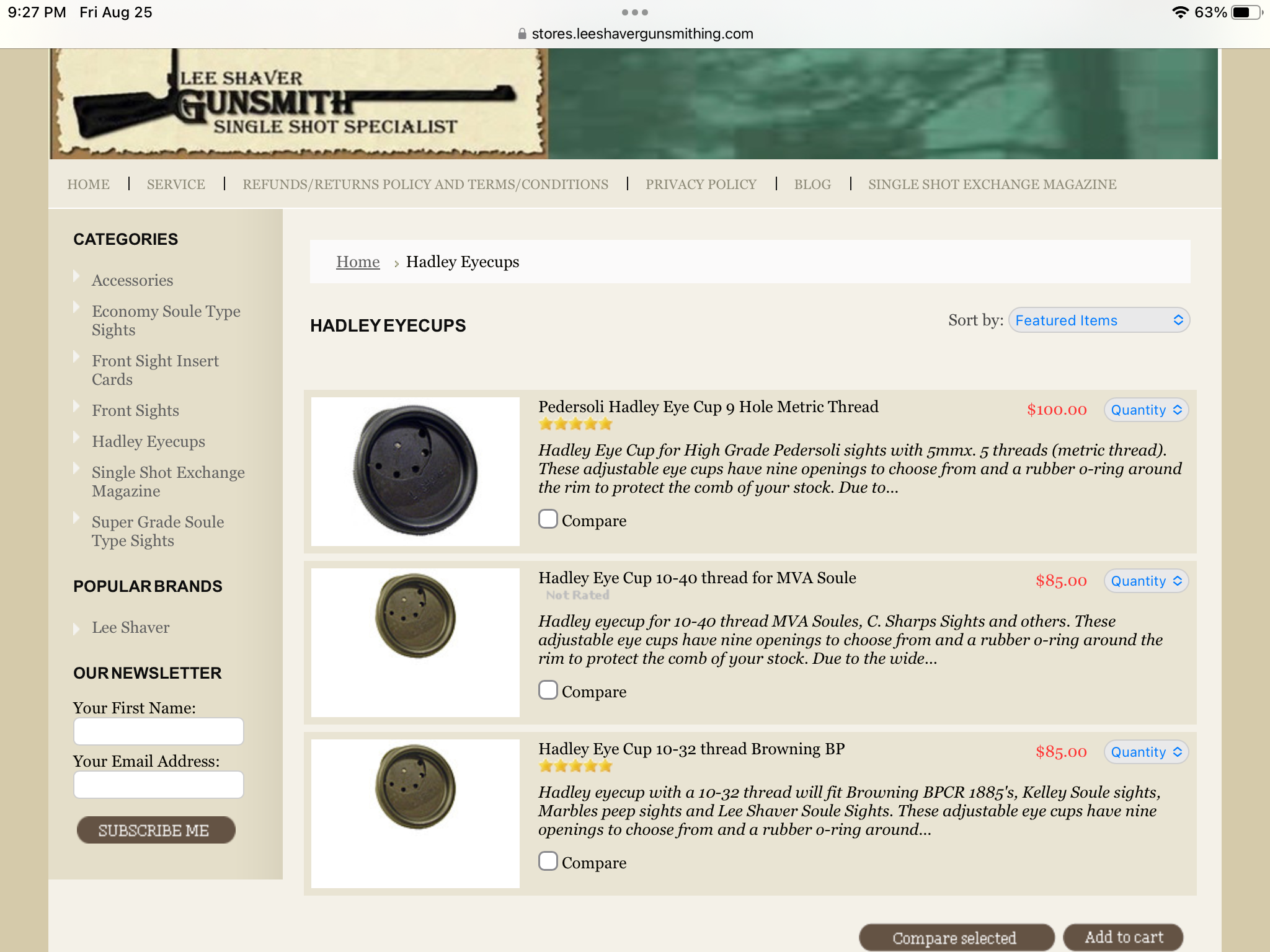

I purchase my black powder cartridge rifle rear sights from this guy. He does off this adjustable eye cup
This is what you want.

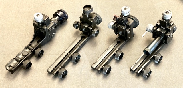

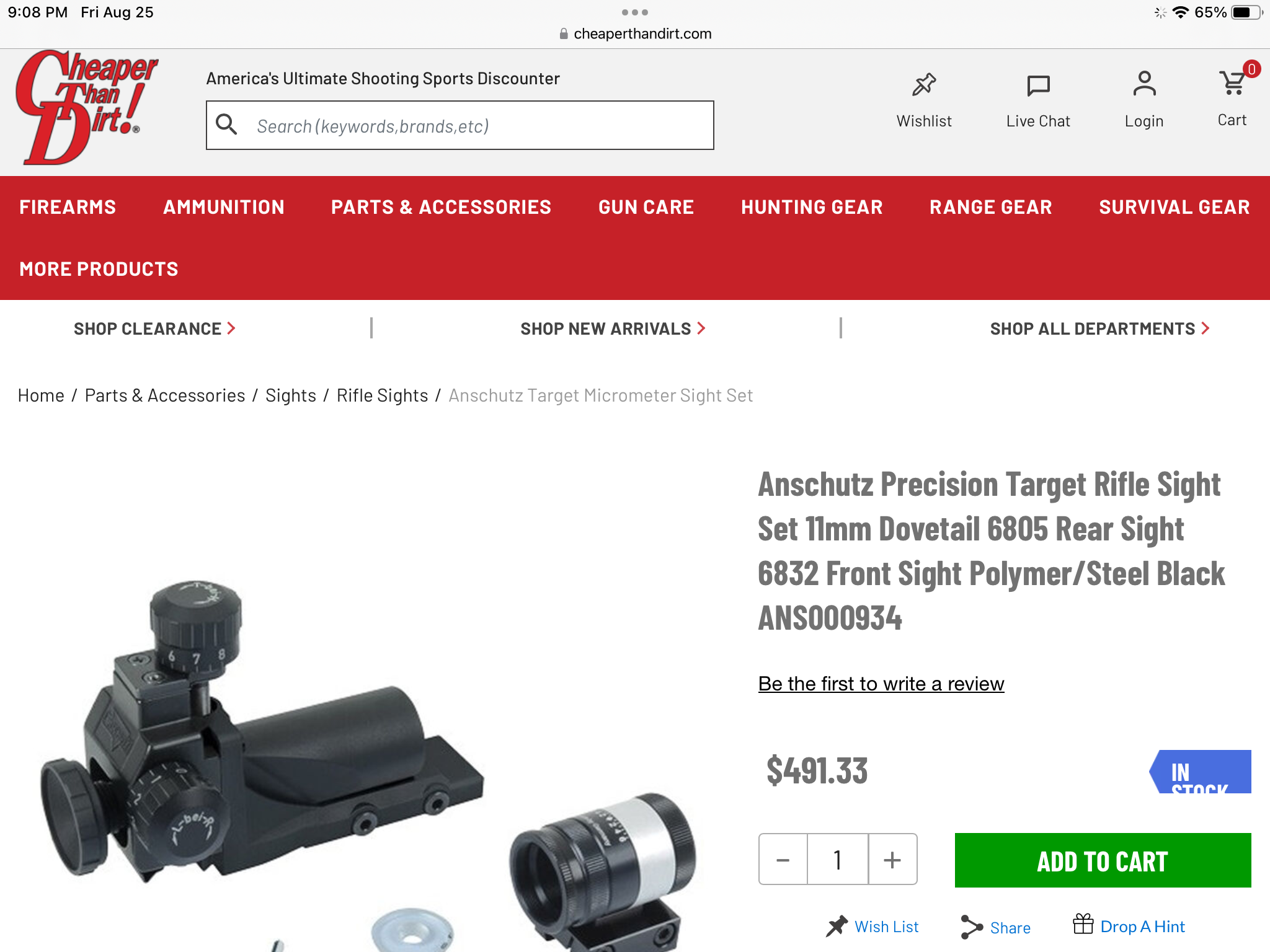

Yes, the Anschutz 6800 series sights should all work. But you can find the older 6700 series sights for a fraction of that price.
Left to right here is a model 6705, 6700, and early and late versions of the 6702. The 6705 is an alloy body, the other three are steel.

I believe this is the correct one. You can call them and tell them you only want the rear site and it will be cheaper. It's also recommended to get the adjustment tool to make it easier. Ron (mycapt65) will hopefully chime in to confirm or correct my error. I still want to get one to try, I have two Williams FP-AG's, one on my 35 and one on a 30.
That's exactly right

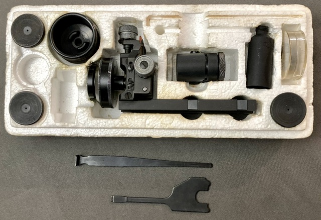

Old match guns often came with a dedicated tool to help with jobs like this. The pic is an Anschutz sight set, the included tool is the long narrow one just below the box, which fits the little slots on the clamp knobs perfectly. The other one is an FWB rifle tool which is the same thickness of metal, and also great for that job. These gadgets are worth picking up when you run into them!
